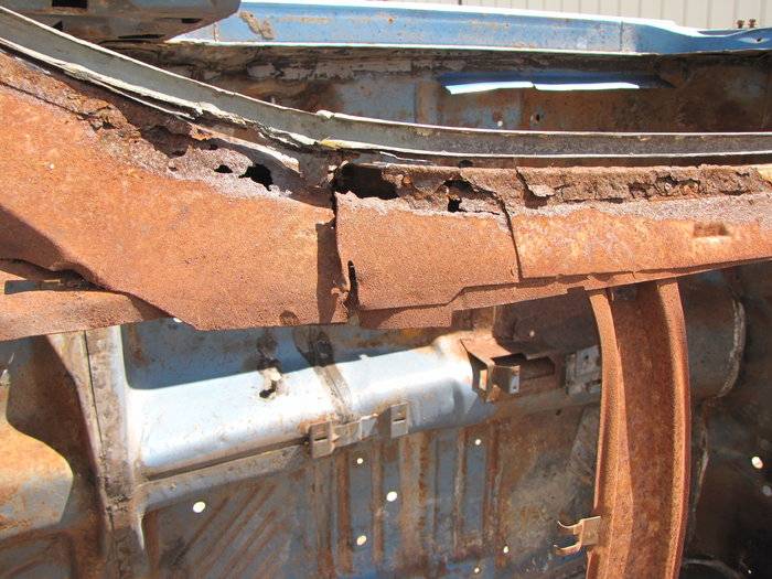

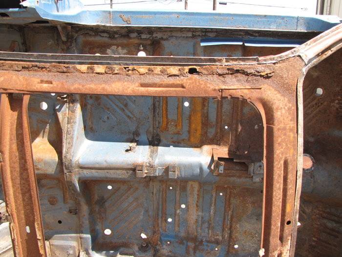

Sadly, we are hitting that point where of course the roof skin may be rotted -- and the decision may be made to keep the skin as it's 'good', but, I'm finding major inner structure rot on many E Body cars. This is not surprising as these cars are coming up on being 50 yr old survivors! So, I tell all my customers that this is not uncommon now to see this massive inner structure rot. Sadly, this sort of news can break you from this hobby as the costs just went up a few notches more. However, this is the reality we face. I'm deep in a 70 Challenger with abnormal Roof structure damages from Goats pissing on it for years and DEA cutting it apart to locate the drugs. My own personal 70 Challenger will have similar problems, and I'm not even going to attempt to 'save' the roof skin -- buying new.

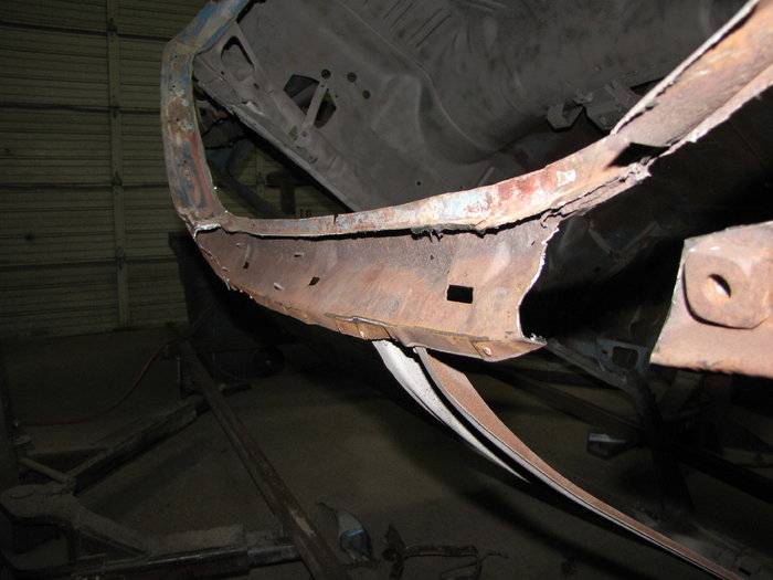

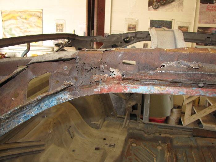

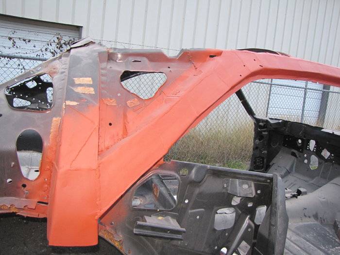

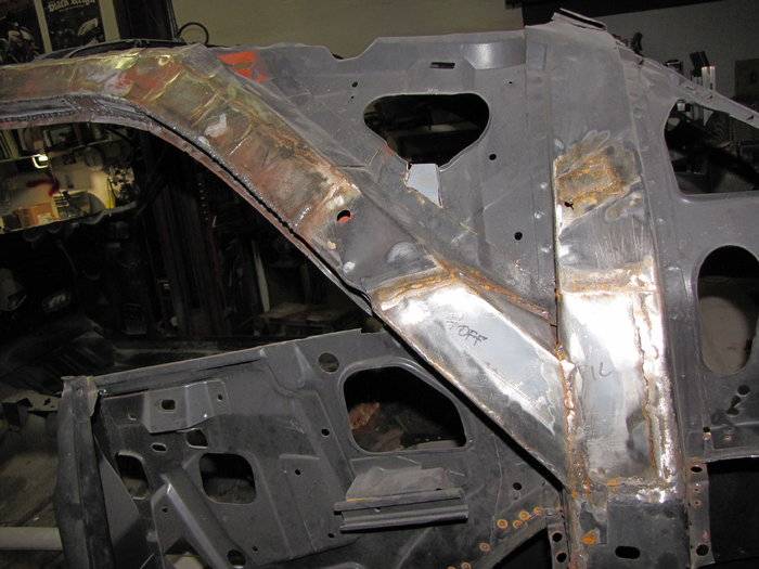

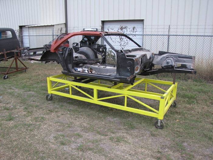

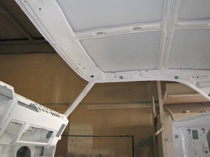

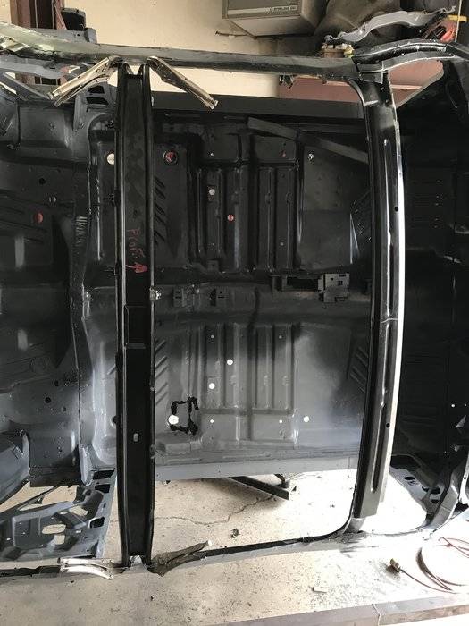

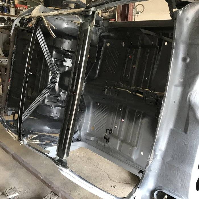

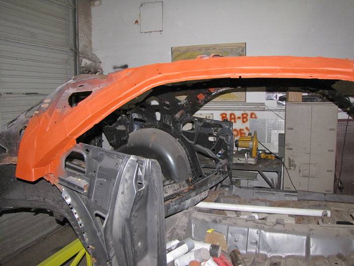

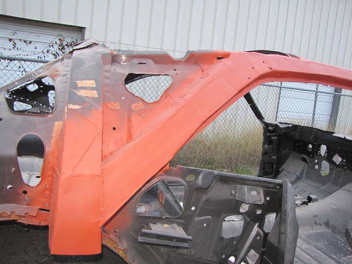

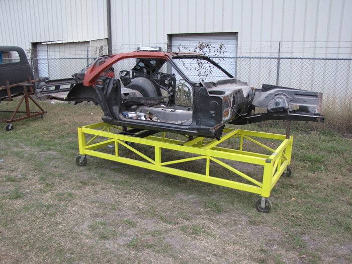

Here's some before, during, and now (after) as lead pictures with new Roof braces installed.

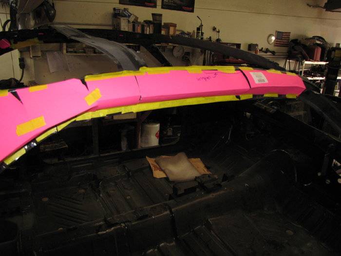

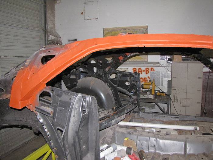

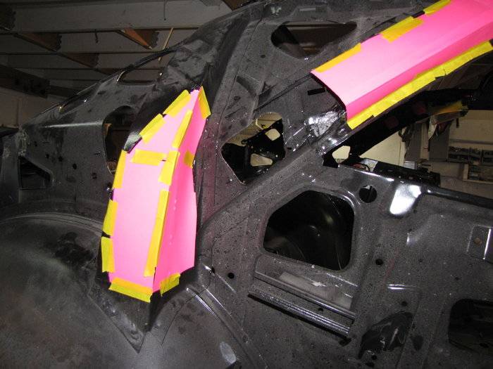

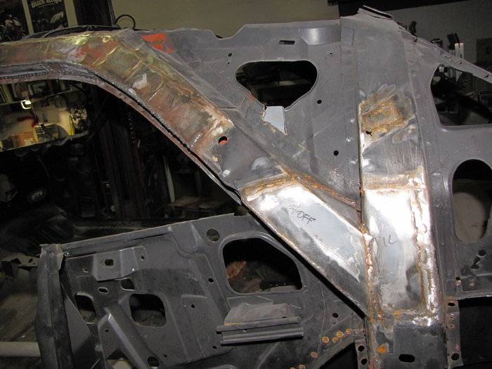

The pink paper is the templating for new metal coupons, which I've made. Here's a few pics. This is a labor intensive process to make this stuff by hand with compound bends and curves so had to make multiple smaller pieces and fit them all together. I used some red rattle can primer to 'hold' rust until all were built and installed, then re media blasted the entire vehicle where and as needed.

Nice work Donny! That's some pretty nasty before pictures followed by some major surgery. Maybe someday AMD will re-pop some those inner structure pieces.

DynCorn makes the entire section which is probably the way to go but those parts always are critical on alignment after the fact of installation. But thanks! I'm getting LOTS of rust repair surgery lately!

Very nice, you must love what you do, it shows!

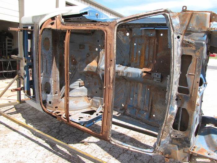

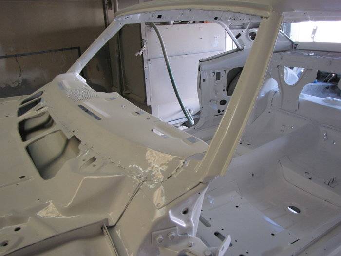

To compound this repair, (this is James' car btw...he has a thread here My Car My Way on this very car) is this Roof has been hacked apart and basically removed before by DEA goons searching for drugs when this car was a mule. So, there is a lot of activity going on! The A Pillars were not correct, than goodness I have my Challenger here to template off from. See today's progress here: DrBlast (specializing in plastic media blasting)

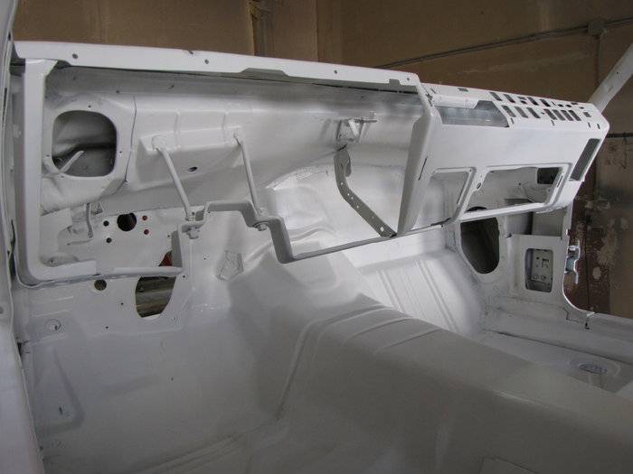

I always media blast the inner structures on these multi tiered jobs; the initial media blast makes the roof skin worthless - not from the blasting process but the process finds the rot and decay. Customer then hires me to do the metalwork, cancerous metal removed and then second blast then epoxy. Install the new metal and reblast the entire car to clean the welds, the oils and greases (cutting bit oil, nozzle dip), various 'hold' rattle can primers, and reprime in epoxy again.

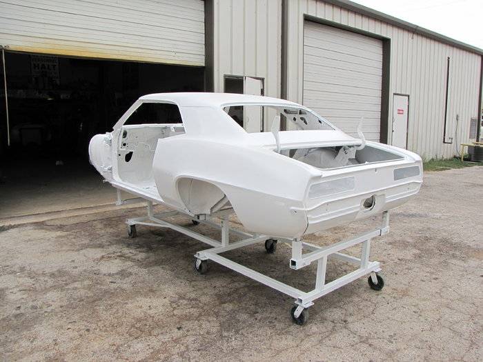

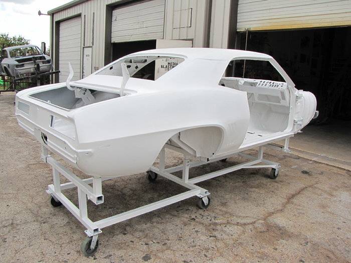

Here's a prime example of this multi tiered process: 1969 Camaro. New roof, Qtrs, Wheelhouses, Firewall, Floor, center trunk floor section, Tail panel, and shaved roof drip rail which I did in conjunction with the Roof skin replacement.
