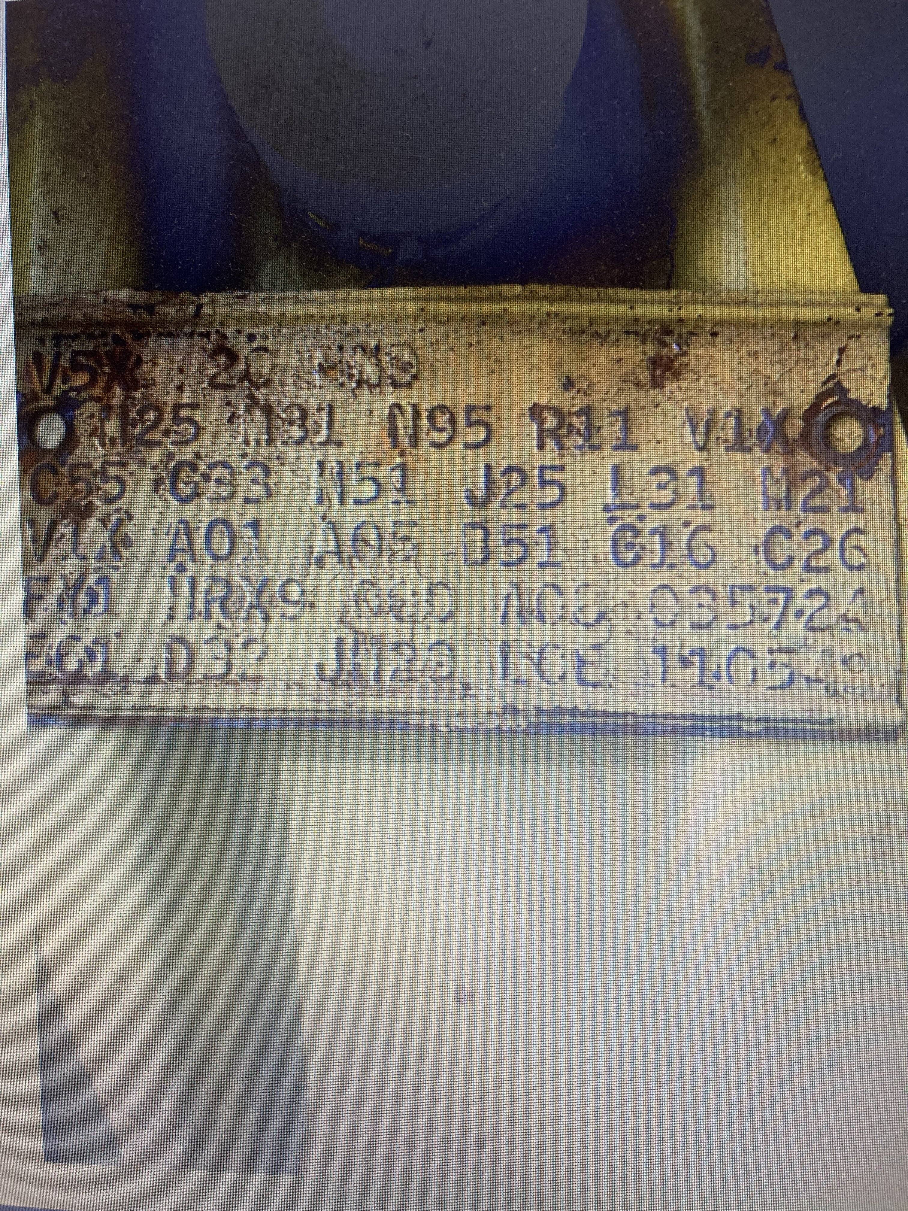

Here’s a bad photo of my fender tag. Is the L31 the engine designation?

The engine code is E61 =383-2 along with the L code in the serial number indicating same.
You have an early production car; A08 (October 8, 1969)

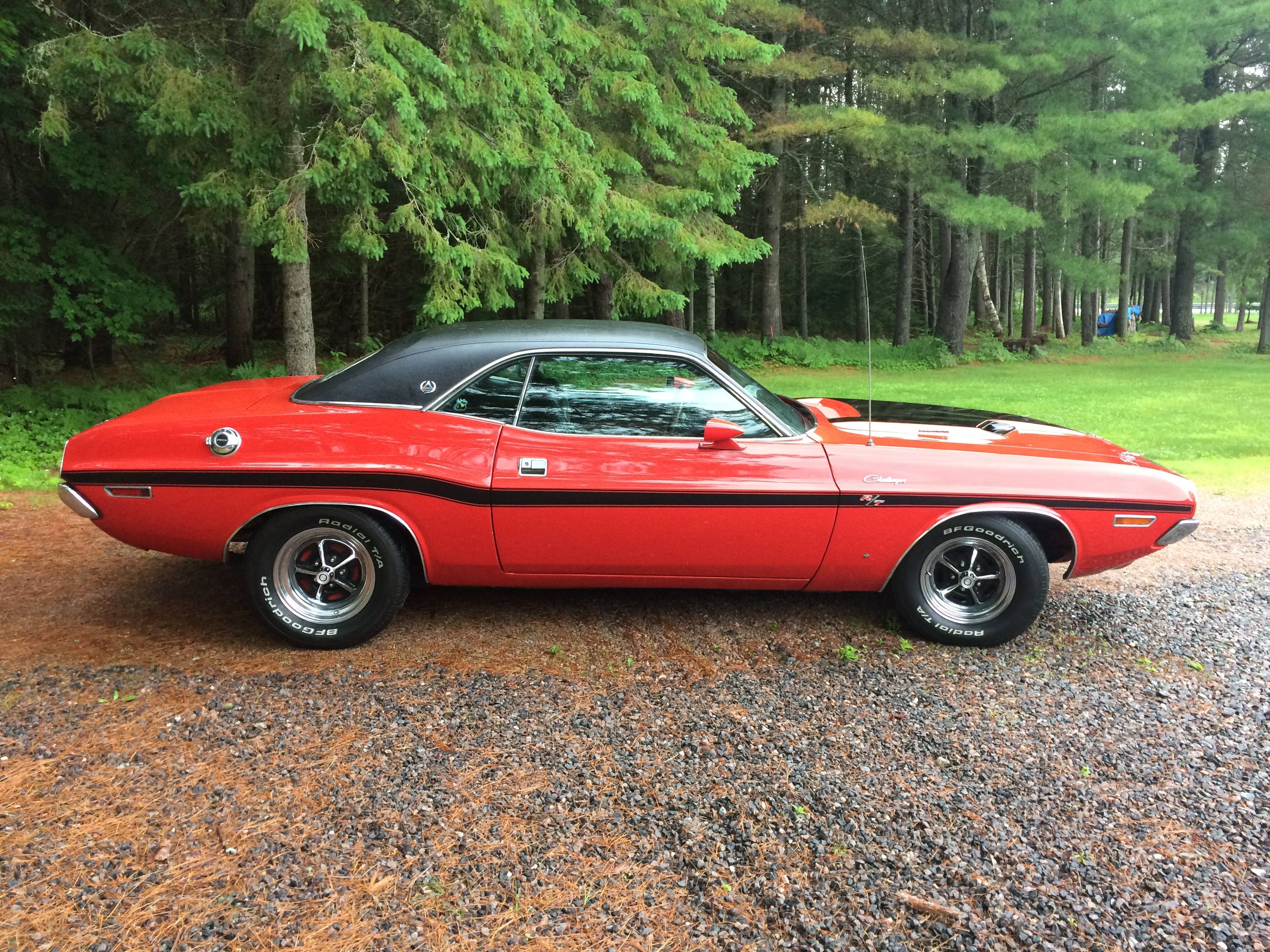

This is my 70 SE , JH29 383, has original drive train, also has factory air. Not all original as has had heads ,4barrel intake, headers, and hood replaced.
