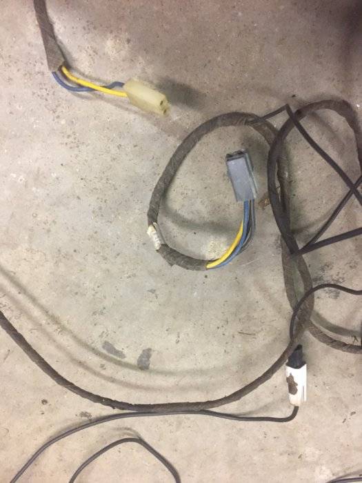

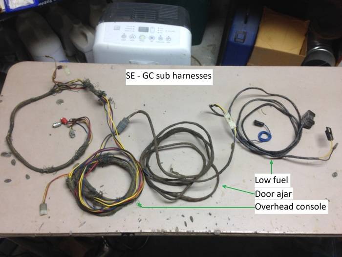

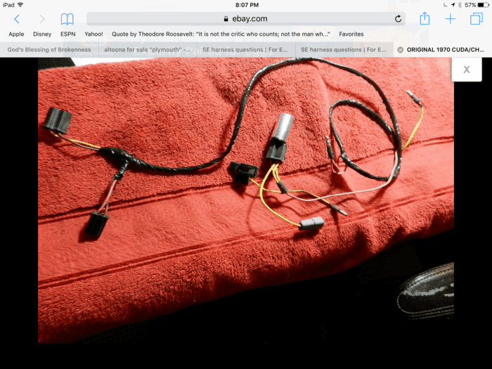

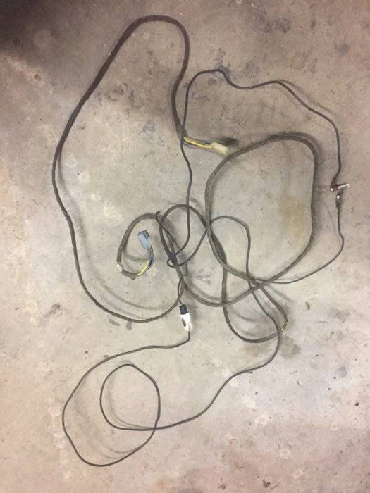

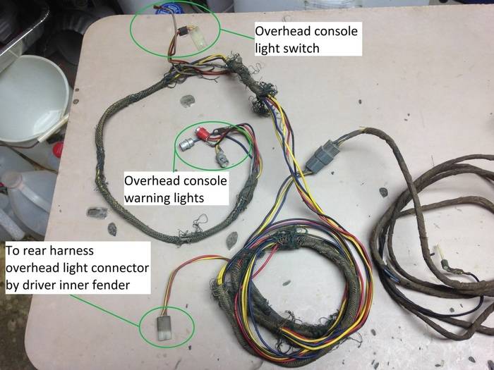

Can someone please confirm that this is an SE door ajar wiring harness?? If so what does it connect to and where? I see the remnants of the door jam switches but I can’t figure what it plugs into....I just located a low fuel harness as well and Im struggling to see where it all plugs together to work the overhead console...any help is appreciated!

I had to do some digging to come up with this, but I will need a bit of time to lay out and label to help with what goes where. It is a bit complicated to just write out in a description. I'll be back... (Arnold Swarchenegger) :thumbsup:

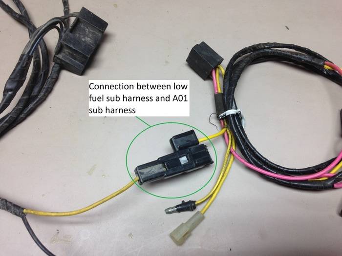

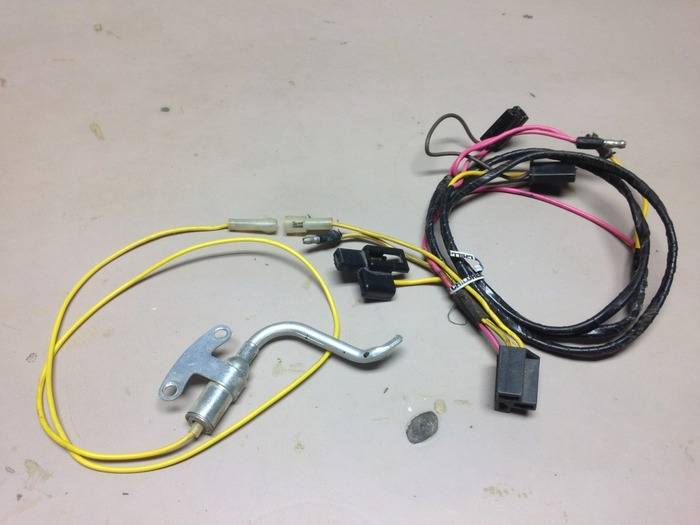

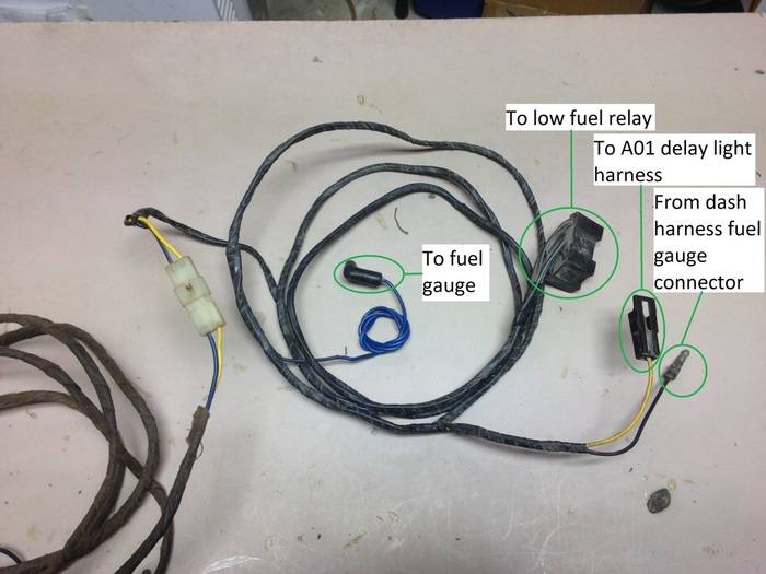

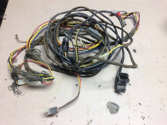

I have put together a series of edited pictures to help show connections and locations...
Overhead Console Harness Connection Detail
Door Ajar Harness Connection Detail
Low Fuel Harness Connection Detail
Low Fuel and A01 Delay Light Harnesses
Low Fuel Relay and A01 Delay Light Harness Connection Detail

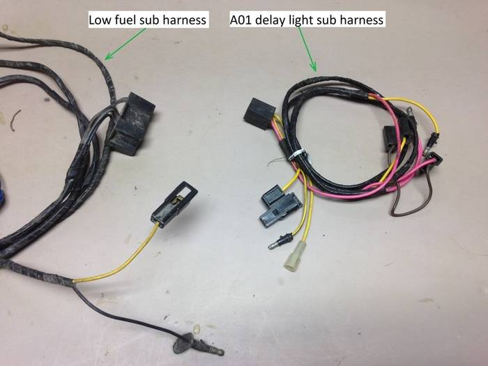

Jim-thank you so much for the knowledge! I'm still absorbing it all. I have a question- will I automatically have a A01 sub harness on my Rallye dash harness? I think that may be the piece I'm missing because I don't have any female connector with a yellow wire only pink and white I believe...
Hemihead2
Aug 1, 2017
178
20
Ok so I pulled the dark blue fuel gauge wire off of the cluster and I plugged it into the black wire on the low fuel sub harness. I plugged the dark blue wire from the sub harness in its place on the fuel gauge... I got everything else in place except for the yellow connector- I have no corresponding plug to connect it to....I may have to find an A01 harness it seems.

Actually no. The one shown in your attached picture is for a 71 - 74. It's another one of those 70 "one year only" things. ;)
A real 70 version A01 time delay sub harness supports the 70 "one year only" fiber optic key light with the appropriate connectors and terminals.

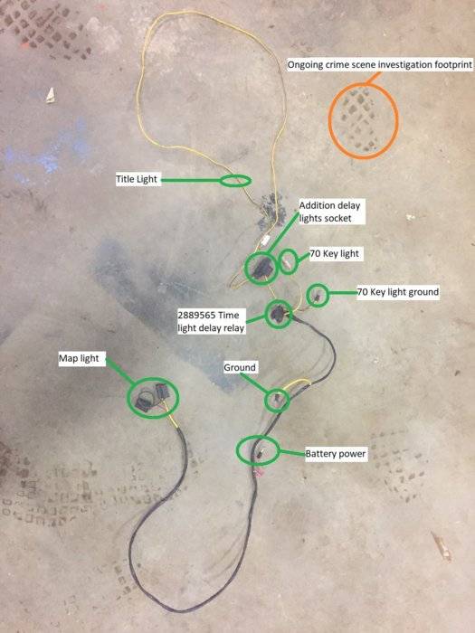

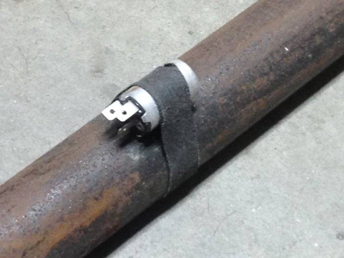

Hemihead2 sent this picture to me and have edited it for the A01 light harness. The only thing I see missing is the socket mount for the title light. The title light mounts on the left side of the light bar to illuminate the switch panel.
Since the light delay relay is a thermal driven device, the factory mounted this onto the steering column with double sided tape to serve as a heat sink and prolong the life. The picture is just a mock up example of the mounting.
