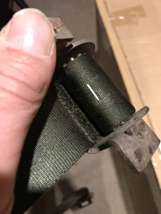

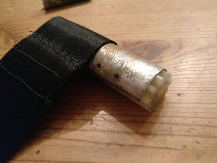

Hey guys, i disassembled the passenger belt retractor and found the problem.
Someone allready put his hands on the belts (i know who -.-) and forgot to fix the belt onto that thin metal plate...
If you roll the belt off completely the spring loaded barrel slips and unwinds the spring.
Can someone tell/Show ne how the correct assembly should look like?
How was the belt fixated? With rivets, screws or thread?
I dont know the correct assembly position and direction of the metal plate too.
Thanks

Talk with Bill. Looks like it needs a rebuild.
