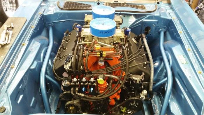

Mark, I didn't do the cutting on the hood or weld the braces on the underside. I had the car at a shop doing a motor transplant. I had a 440 crate & six pac put in it. After the engine was installed we noticed the stock hood didn't have enough clearance, so I went with a shaker hood. The guy that did the cutting & welding isn't a body guy just a good mechanic with welding skills. I did take the hood to a body guy to do the filler & paint. I think he just used the trim ring as a guide when he cut the hood. I don't think the hood braces on a Charger & Cuda would be the same. I don't have the Charger at my house right now. It's back at the body man's shop for a complete paint job. If you need pictures of the under side I could run out there and get pictures if that would help you. This work was done about 5 years ago so my memory has faded a bit. The mechanic never said anything about doing it being difficult.

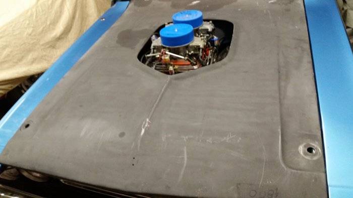

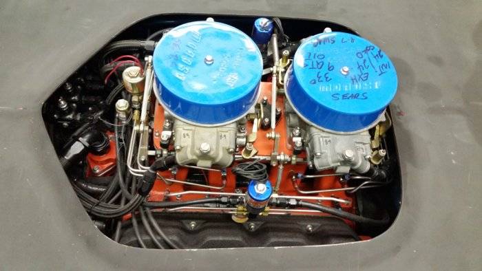

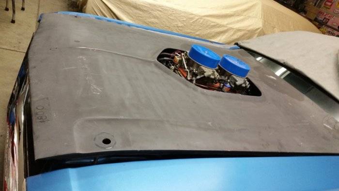

I am doing one now. I have the hood. Looking for a base plate and scoop to cut up to make a custom drop base and larger scoop to fit my tunnel ram and dual Dominator carbs.
6PKRTSE
Feb 3, 2010
854
450
I just ordered the baseplate, adapter ring, seal and scoop. I know it is going to be a lot of work. I think it will look cool when it's finished.

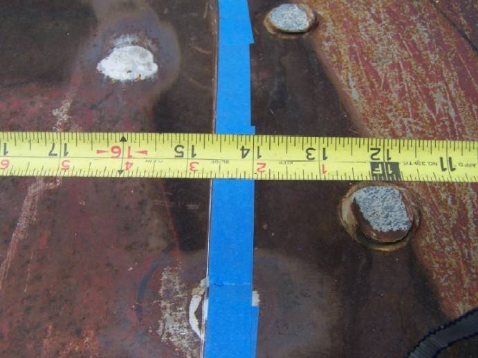

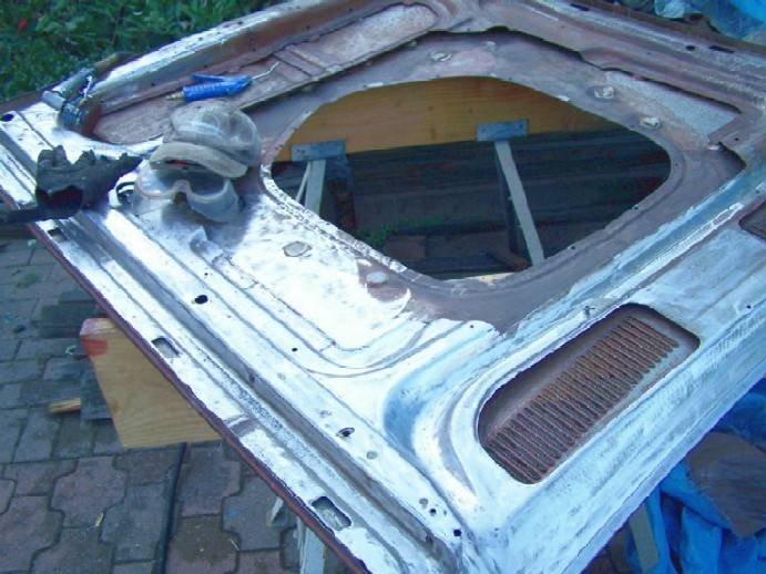

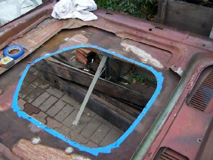

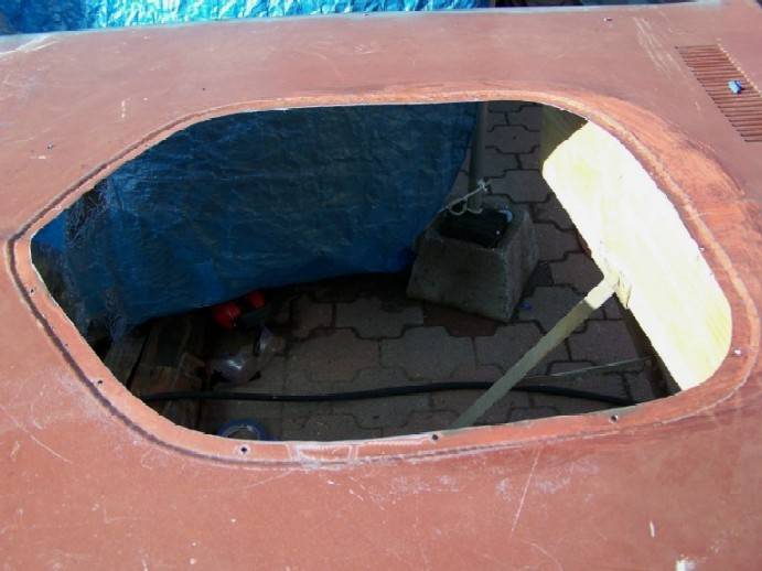

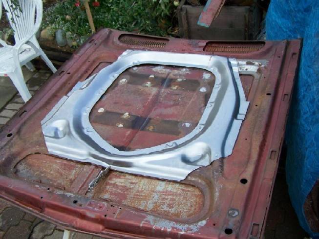

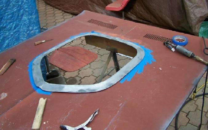

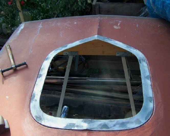

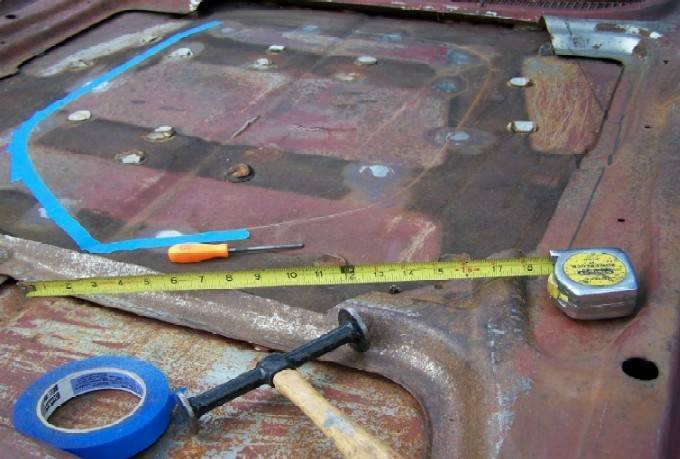

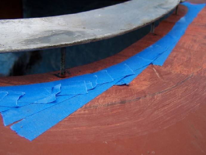

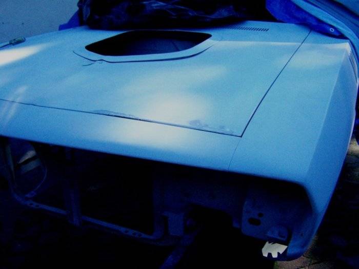

These pics were sent to me at one time. They are not of my work. I have done several conversions and they are easy.

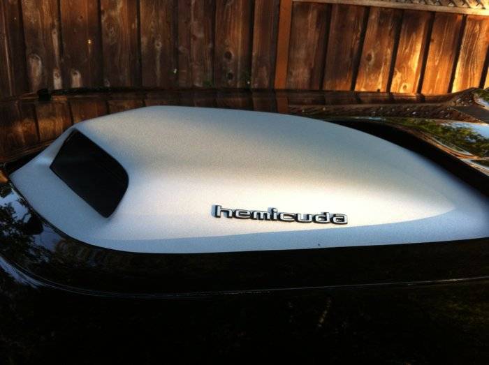

I'm late to this thread, but I have a 70 cuda with a shaker hood on it. If you need someone to do some measurements or get some pics, I will. It buried in my garage, but I will help if I can...

Wow, looks nice! I just ordered a trim ring from Rick, he had some on discount that need some pits filled in. I am thinking of buying the Goodmark/Tamraz hood, I think I can get it for under 500. Then I just will need the gasket from Detroit muscle.

Challenger6Pak, how much "time" do you think it takes to do the conversion?
challenger6pak
Feb 27, 2011
4,070
917
I can't say. Too many variables such as what tools do you have and what is your skill level. Plan a good days worth of time and you should be fine. It's more tedious than difficult. The hood flange where the ring goes takes the most time. The pics I posted had the flange done on the hood with a tool. The kits from Rick include a flange which can be metal bonded to the hood. The last one I did, I cut the hole, metal bonded the flange and welded the rear framework or brace.
