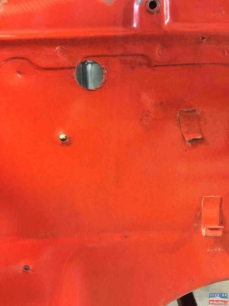

I have a Shaker hood that was never hooked up on the 70 Challenger I bought,after looking around there is no hole in the base plate for the cable to go through and there is no hole in the firewall for that cable either. Does anyone have this information?

A closeup of the firewall hole for the Shaker cable grommet and the cable/grommet installed.
