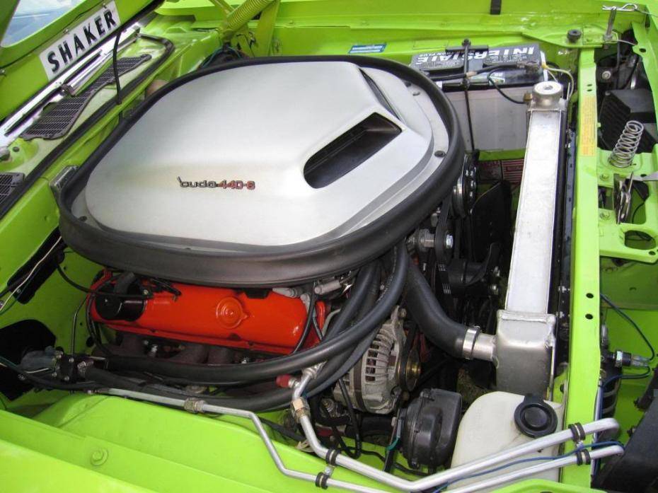

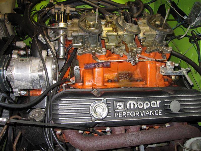

Let's see if the pics work this time.
Chryco Psycho
4,697
2,341
Panama
the only way is to notch , deform ,refit the shaker base . As you said there never was a factory A/C Shaker combo so the Sanden is a better choice
