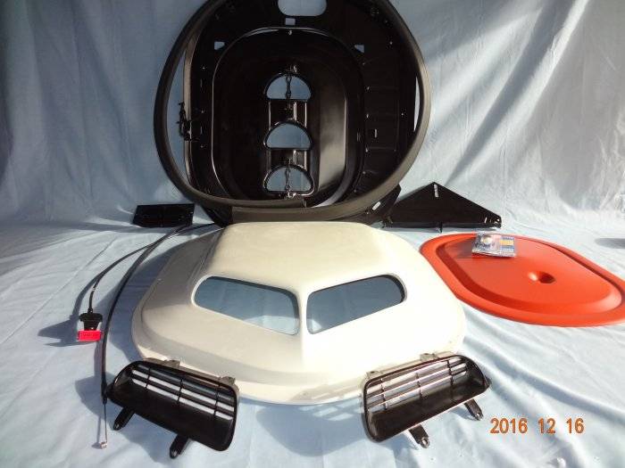

Your farther ahead buying an AMD hood or one from Goodman. I do have kits available for your 6pack set up. All my products are made in the USA which directly reflects the detail in these products at a competitive price!

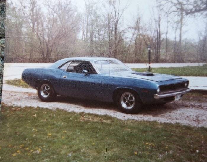

I did a down'n'dirty shaker set up with a flat Barracuda hood. Used a "nibbler" from Eastwood that didn't distort the sheetmetal. By 1982 standards it looked very nice. The lack of trim ring also made the hood look cleaner.
