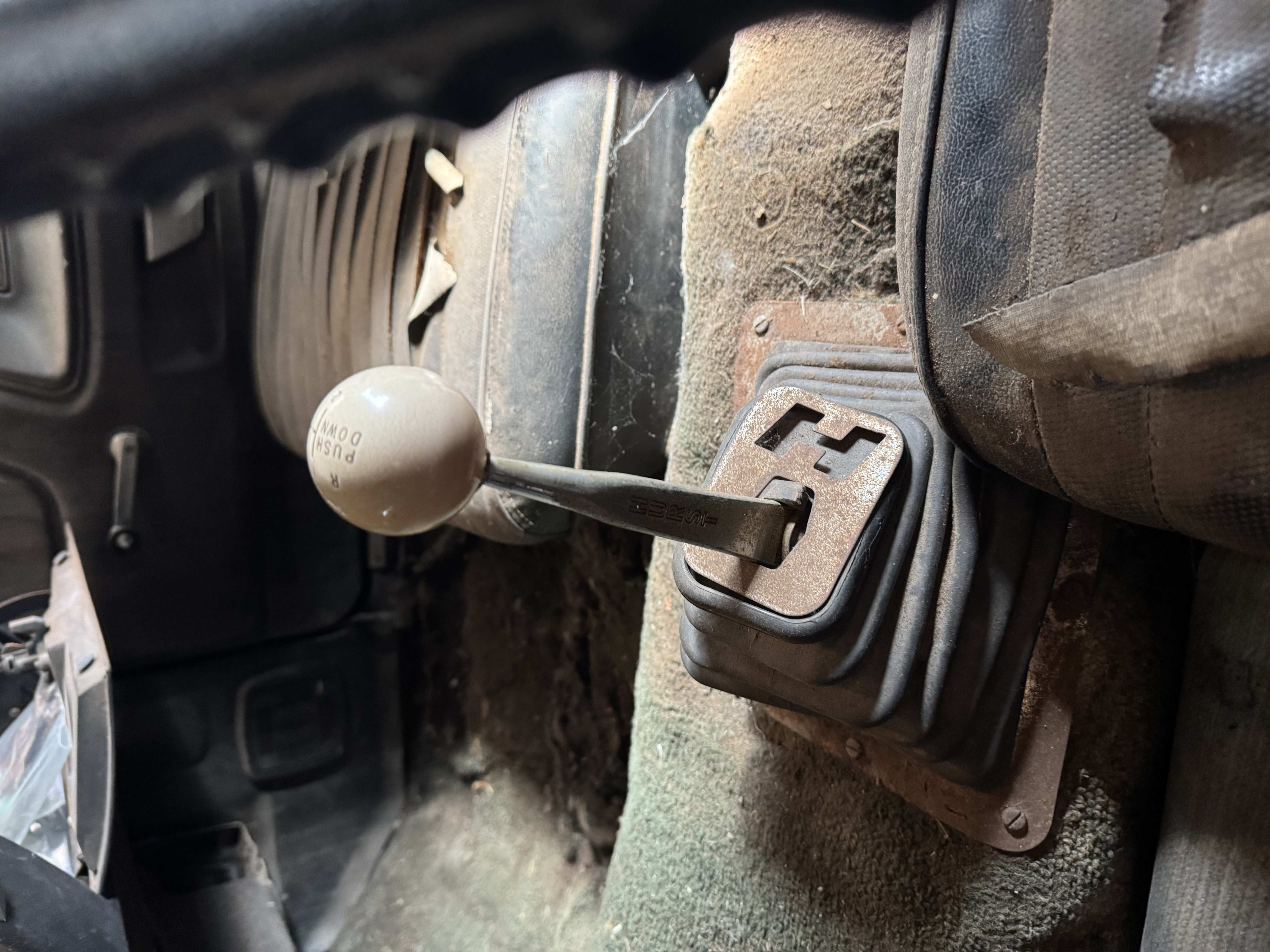

Hurst compaction shifter I think that's what is was. If you can find one. When I first looked at my challenger the owner had one in it. You have to change the mechanism too.

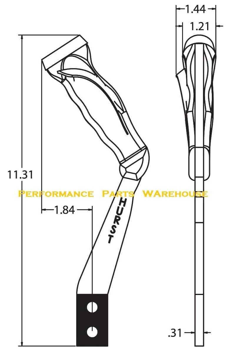

I'm also converting my '72 Challenger to a 4 speed so I've researched this exact subject a bit. Here's a diagram of the E body Pistol Grip Shifter for reference.

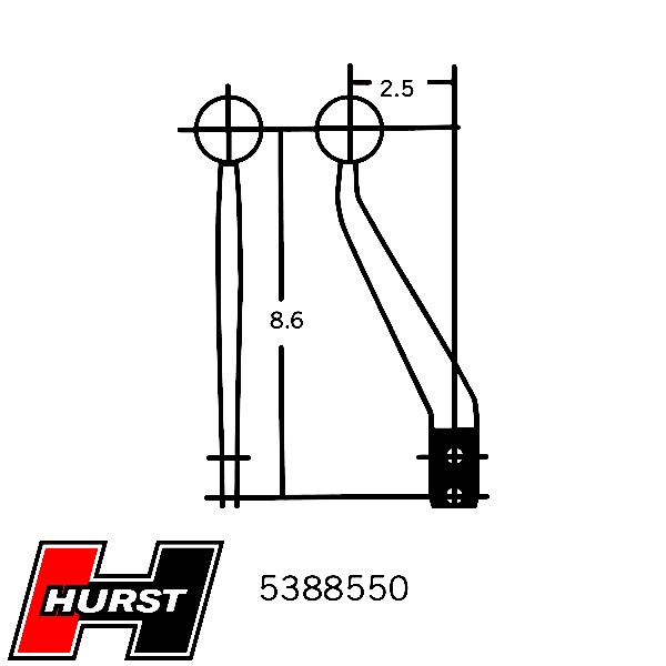

Though I have not tried to fit any of these myself, there are some generic handles that appear like they would work. Hurst # 8550 is a Fox Mustang shifter handle. It has a rearward bend that puts the ball in a similar position to the top of the pistol grip. I'm not sold on the appearance of it though, looks a bit too modern for an E Body. Might be a bit short as well.

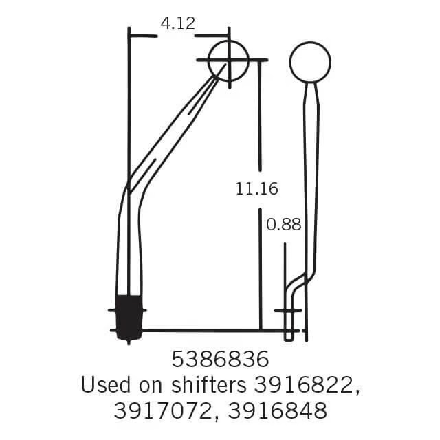

Next is the Hurst #6836 handle which I think would look more at home but may not be a perfect fit. That handle has a 7/8" jog to the right so without it being in the car it's hard to know if it will line up with the boot. Pretty sure it's a generic Brand-X handle. Brewer's sells these as generic replacement handles but they don't specify what it would fit. Guess you could ask them.

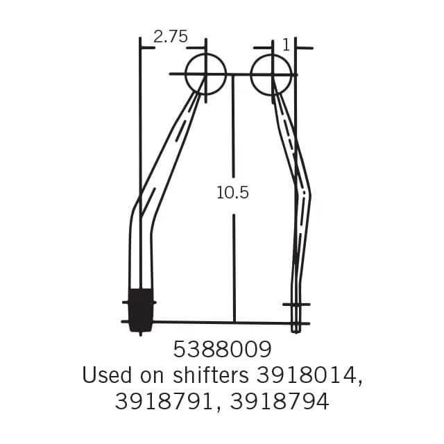

There's also this one, #8009. I have not seen too many of these around so it might take some looking to find one. This one is angled 1" from the mount towards the driver which could be a good thing.

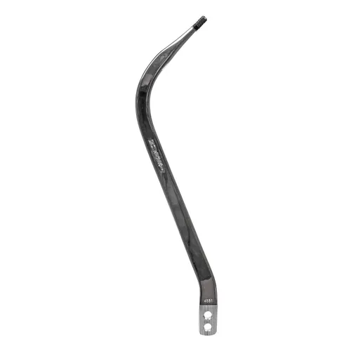

Check out this Long shifter as well. I'd say this looks promising since there is no jog to the right and the height is similar.
Long hn1012
