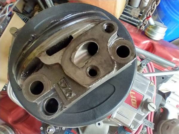

While you're in there.... this is a good mod to the oil passage to complement that HV pump. BEFORE assembly of course :-)
