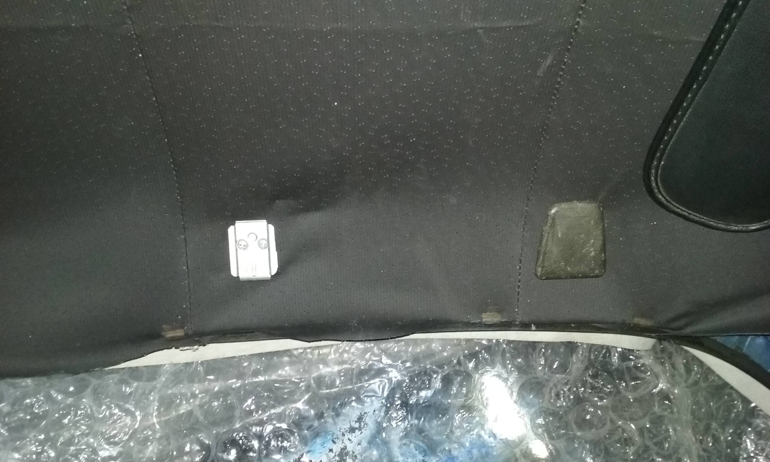

This is a 70.

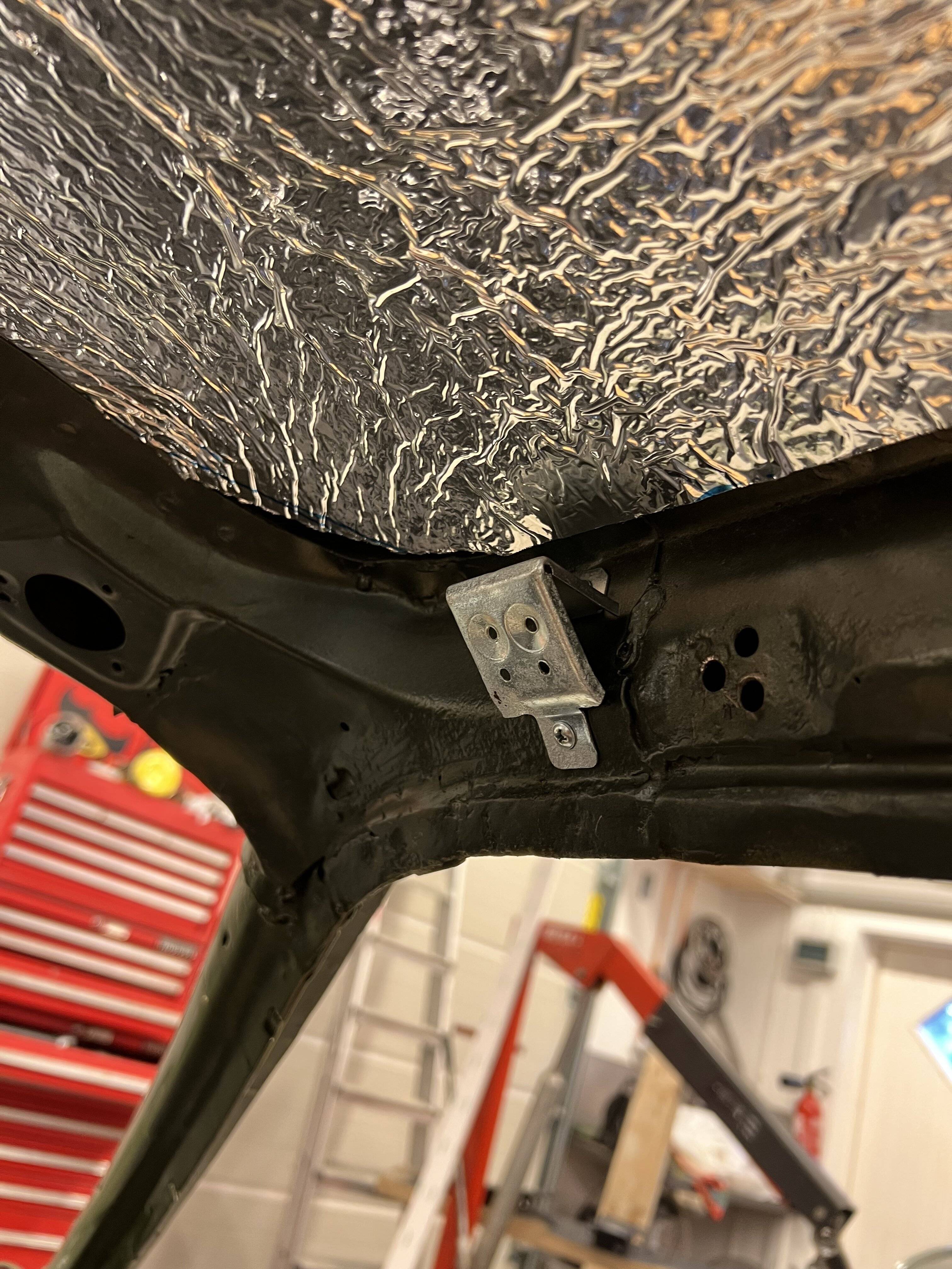

Hi ScottG.
I,m right at the same place in my project with my 71 Challenger.
Just found out how this clips ar fastend.
This brackets is going in now before the headliner and fits exellent in the original place.
