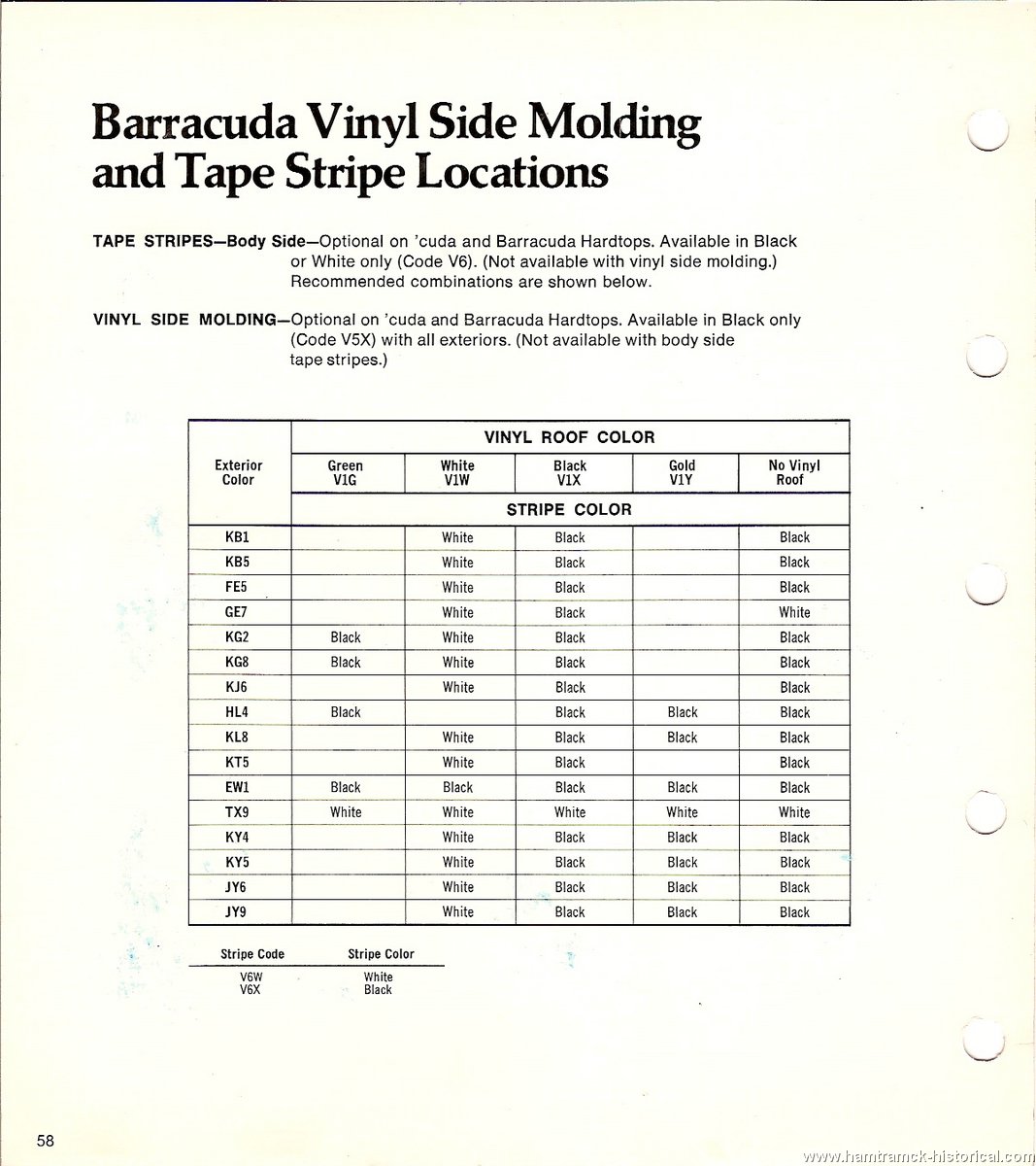

Aug 15, 2024 #1 S smallblockpower Member Joined Nov 30, 2020 Messages 14 Reaction score 2 Location nj I tried search option. Can someone tell me if there is a stripe code or stripe delete code on the fender tag for my 74 cuda. I found the paint (moonstone) and top code (white), what does the stripe code look like.Thanks
Aug 15, 2024 #2 pschlosser Well-Known Member Joined Dec 8, 2022 Messages 652 Reaction score 247 Location Santa Rosa, California I'm not sure I can tell you the exact codes on your fender tag, but you're looking for codes in the range V60 through V9X. Have you tried to decode your entire fender tag using one of the fender tag decoders available online? Mopar Fender Tag, VIN & Build Sheet Decoders
Aug 15, 2024 #3 EV2RTSE Well-Known Member Joined Dec 13, 2013 Messages 284 Reaction score 179 Take a look at Hamtramck Historical, lots of cool reference info there- https://www.hamtramck-historical.co...1974/74_Plymouth_Tops_Accents_Stripes0012.jpg
