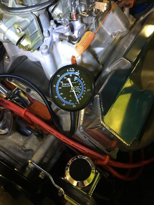

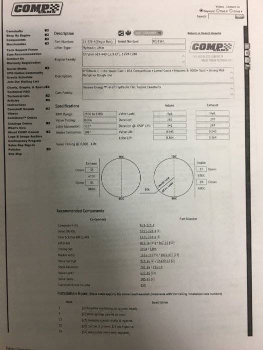

I have 500 stroker six pack that idles a bit too rich. In the past I’ve read some post from very knowledgeable folks. Car idles at 950-1000 rpm’s just fine. She runs at WOT very strong, no stumbling or pinging. I’m using 93 non ethanol fuel. I’ll include the cam specs too. Yesterday I pulled the manifold vacuum from the big port on the back of the manifold.
I also installed a promax baseplate on the rear outboard carb on initial build 7 years ago. I can’t get in touch with promax but, I think the air screws are 1/8 -1/4 out. If anyone has any advice I would sure appreciate it.

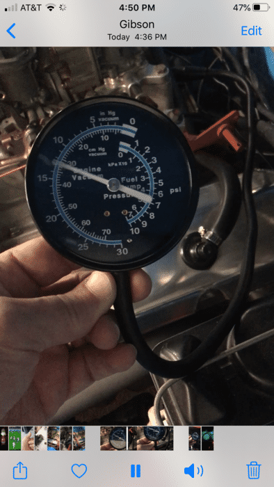

All grounds are clean on mine but, I’m getting 10psi out of the mechanical pump. Never would have thought it.
Runs great just a tad rich at idle.

I can’t believe this much pressure from the mechanical pump???
I’m going to have to back it up with guages I have at work. But, I have the first reading.... thank you for the help guys. I’ll let you know if this is accurate.

Thanks for looking. I didn’t think it would pull the vacuum that it does.
Most all of other BB Mopars would only pull about 6. This one seems to be about 12 inches. Is that low? Because I don’t know. I can tell you with this set up, I can go WOT and get on the power brakes and they work perfectly. The engines before....WOT, be ready to push on the brakes a lot harder when you let off. I’m still learning.

The factory cams used a 114 cl , so the vacuum was usually 15 or higher , you are doing well to get 12" & a lot of that has to do with the larger CI still I bet there is more in your set up by tuning it further
