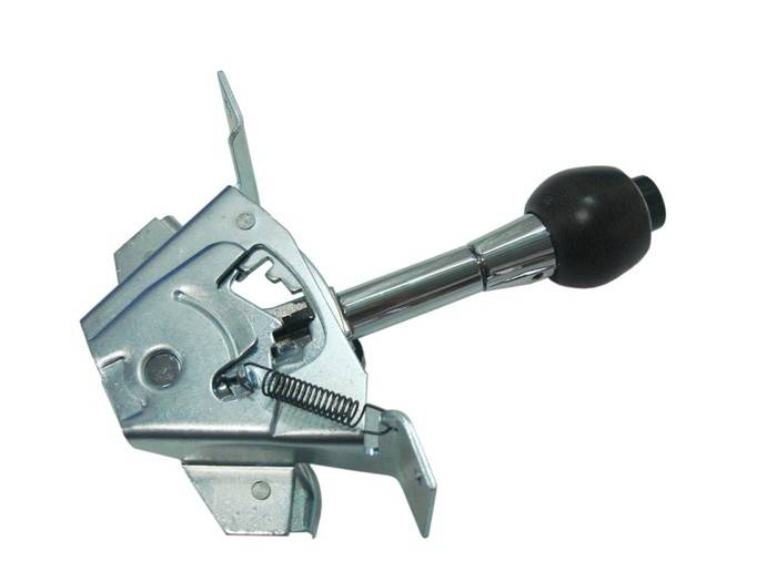

shopping
Shifter available as a repro
214-70KIT Mopar 1970 E-body Automatic Console Shifter Kit

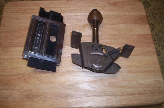

You may want to contact Mopar okie, here on FEBO who has one for sale?
under "70 slap stick" in parts for sale section

I saw that but too pricey for me. Pretty much like the Ebay part you were showing me earlier. Thinking of buying the new shifter kit from PG classics. New mechanism, chrome shifter and woodgrain knob vs. 50 year old part. Seems to be the way to go. I can modify my cover plate slider to accomodate the round shifter and save $200 bucks for something else I need. Thanks for the info!!
