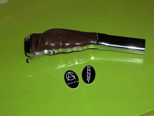

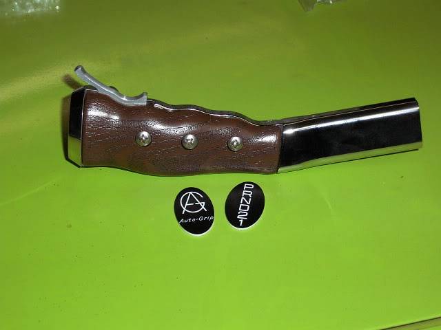

On the Cuda Challenger site there is a member with user name Quapman , he makes a billet pistol grip replacement handle that is top quality & will not break or stick like the plastic ones , if you want to go to a pistol grip design on the slapstick . The replacement will bolt on in approx 1 minute , he has different units for the 70 & 71-74 style as well

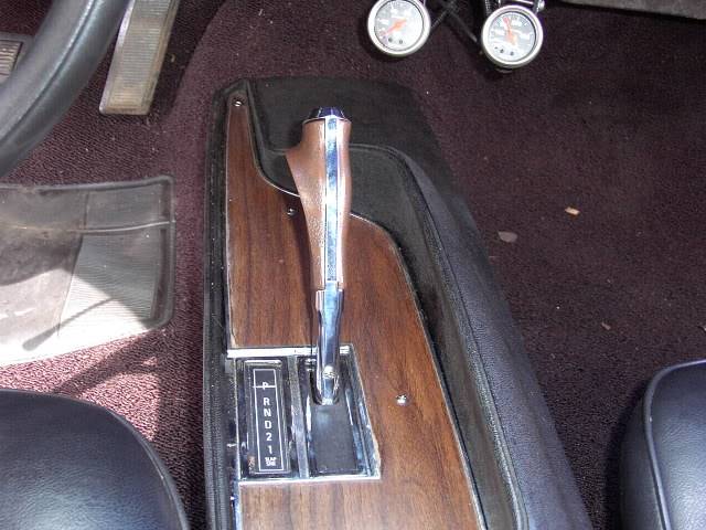

That's what I'm using. Love works great! Mine is the 71-74 version even though the car is a 1970. I prefered the 71-74 version.

I'm ready to order a pistol grip shifter from Quapman, autoshifter. The short version, for my 72 cuda. From what I have read that's the one I need. I'ts not the T handle, It is the one with a button on top. Quapman assured me that is the correct one. Any comments.
