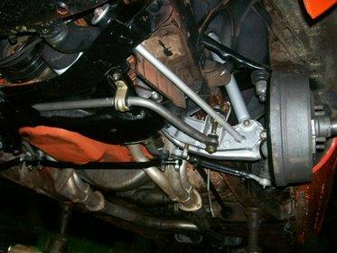

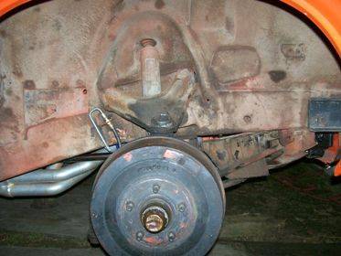

$1500 is a lot for a full front end rebuild unless it'sa comsetic restore too. But, the last one I did last year (in pics), complete with refinishing, was about $750 in hard parts. I only use Moog for chassis stuff and energy suspension urethane so maybe that's why.
wow, looks really nice. I'm going to try to do it all myself.
It's not difficult, but you need a few things to make it easy. A press, a propane torch, the large Chrysler ball joint socket, a pitman arm puller, blasting cabinet...lol. Or you'll end up paying for some or all of those actions. The car in the pic is a friend that started as a customer. The car is a 383/4sp RT, unrestored although the driveline was gone thru and it's been repainted. It now drives and stops like it should. He messed up the brakes when he did them so I fixed that too...lol.
