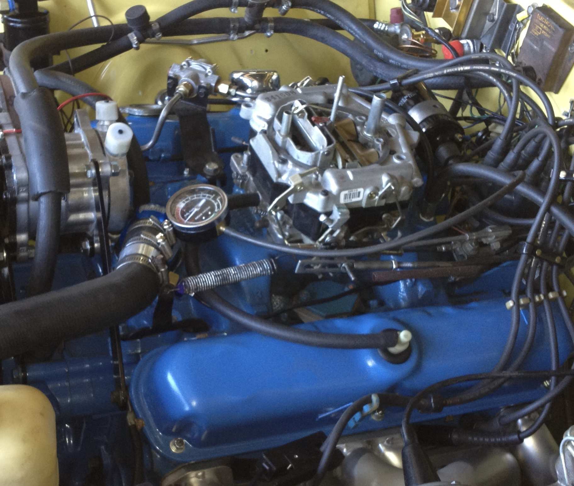

I am trying to remember what I did when I went to a 4bbl on my original 318, but I believe I had to swap to a 4bbl linkage, but that was also a 3 piece kickdown linkage I had already. I believe there is clearance to move the attach point inboard.
Looking at my old pics it appears my Carter carb did not require the adapter:
I have since swapped to a 360 and Thermoquad, so I don't know how well that applies for the linkage, but the key is in the linkage used (of course);

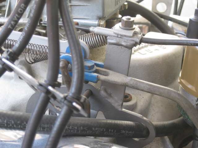

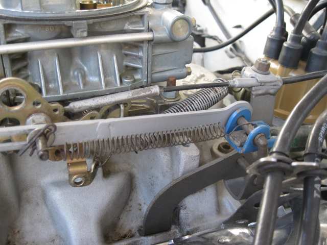

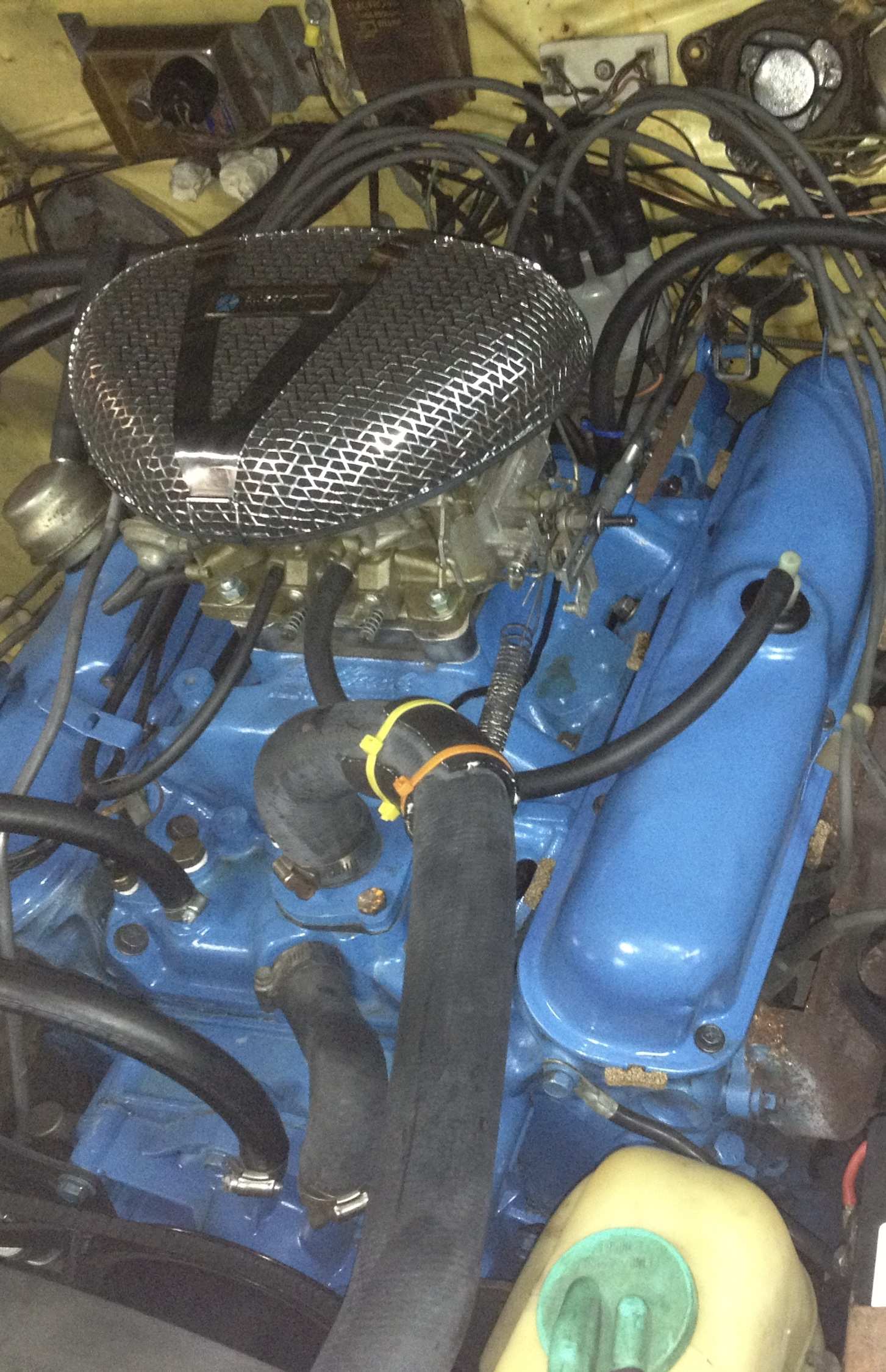

Here's what my engine builder did for my 318 with a Holley 4160 and Edelbrock LD4B

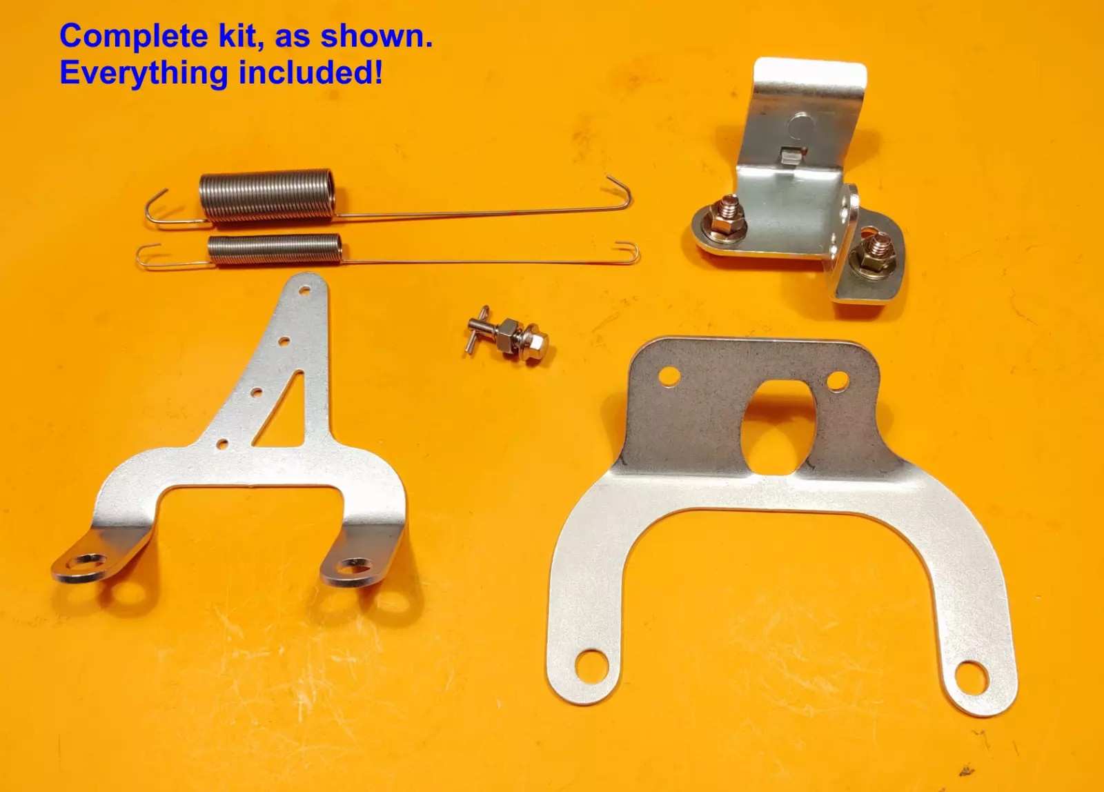

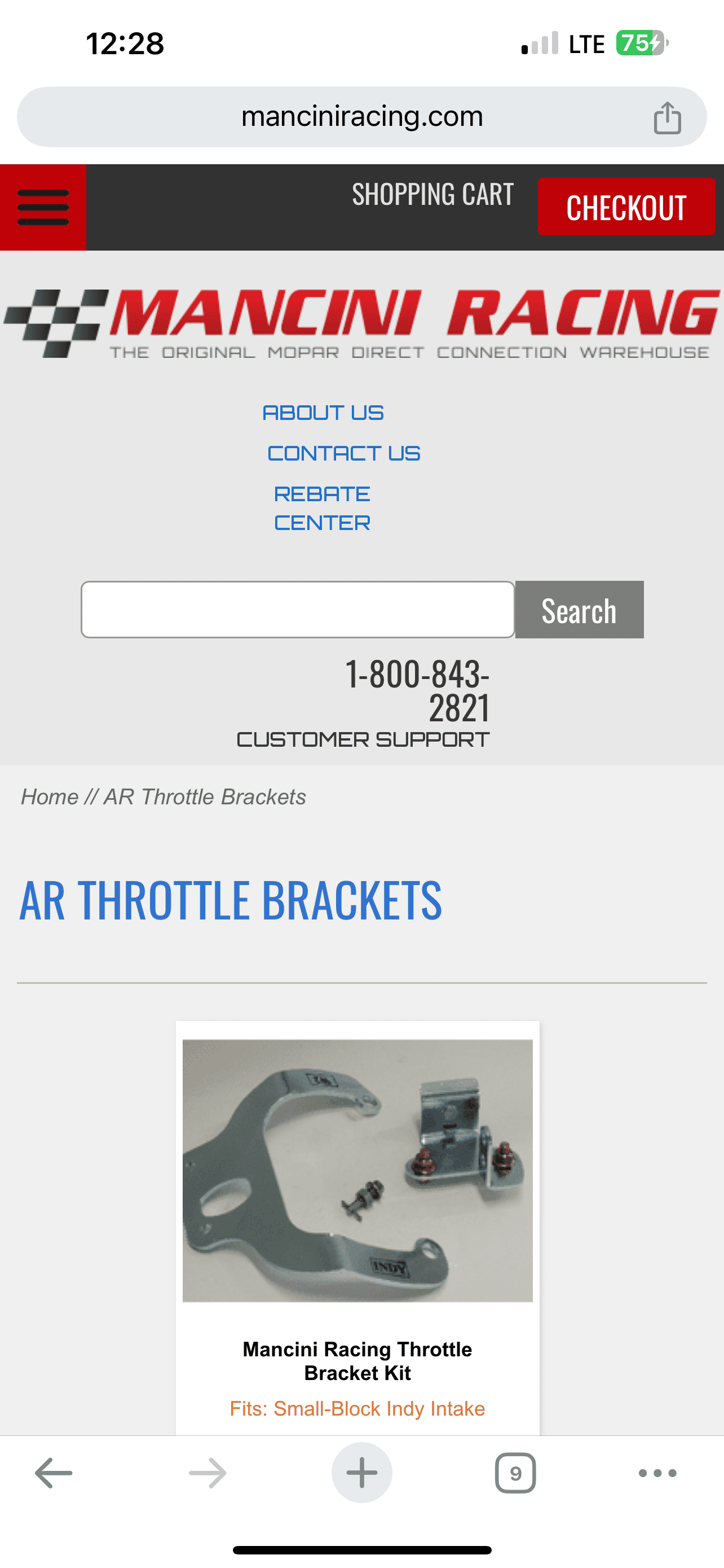

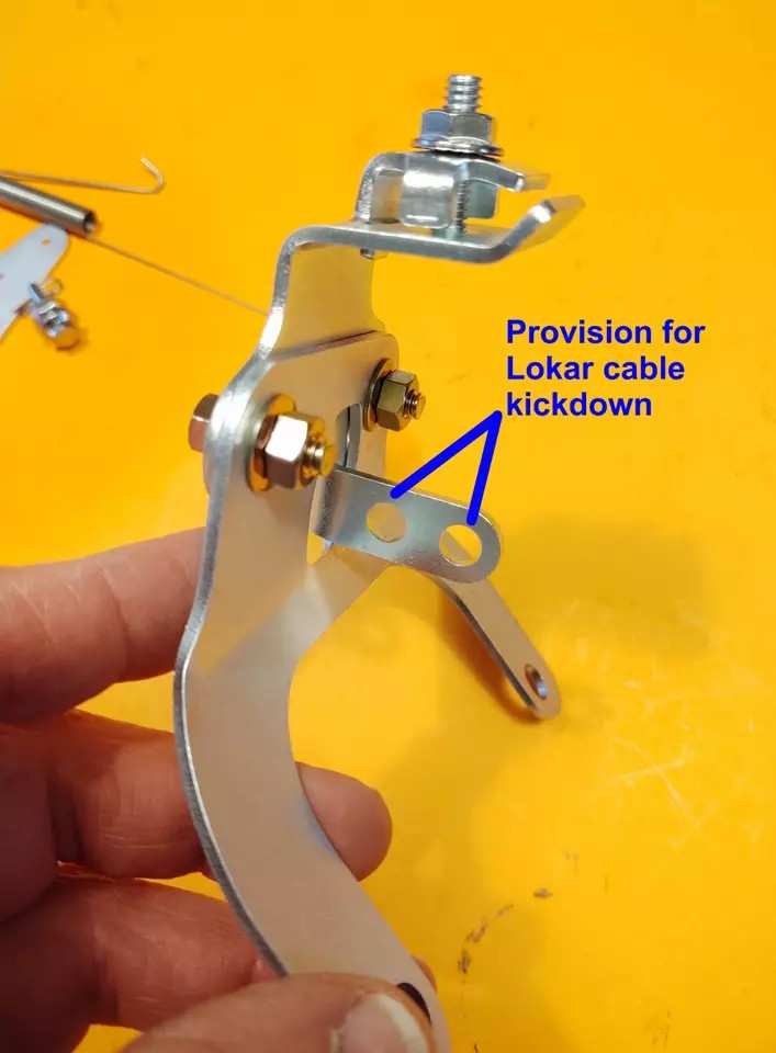

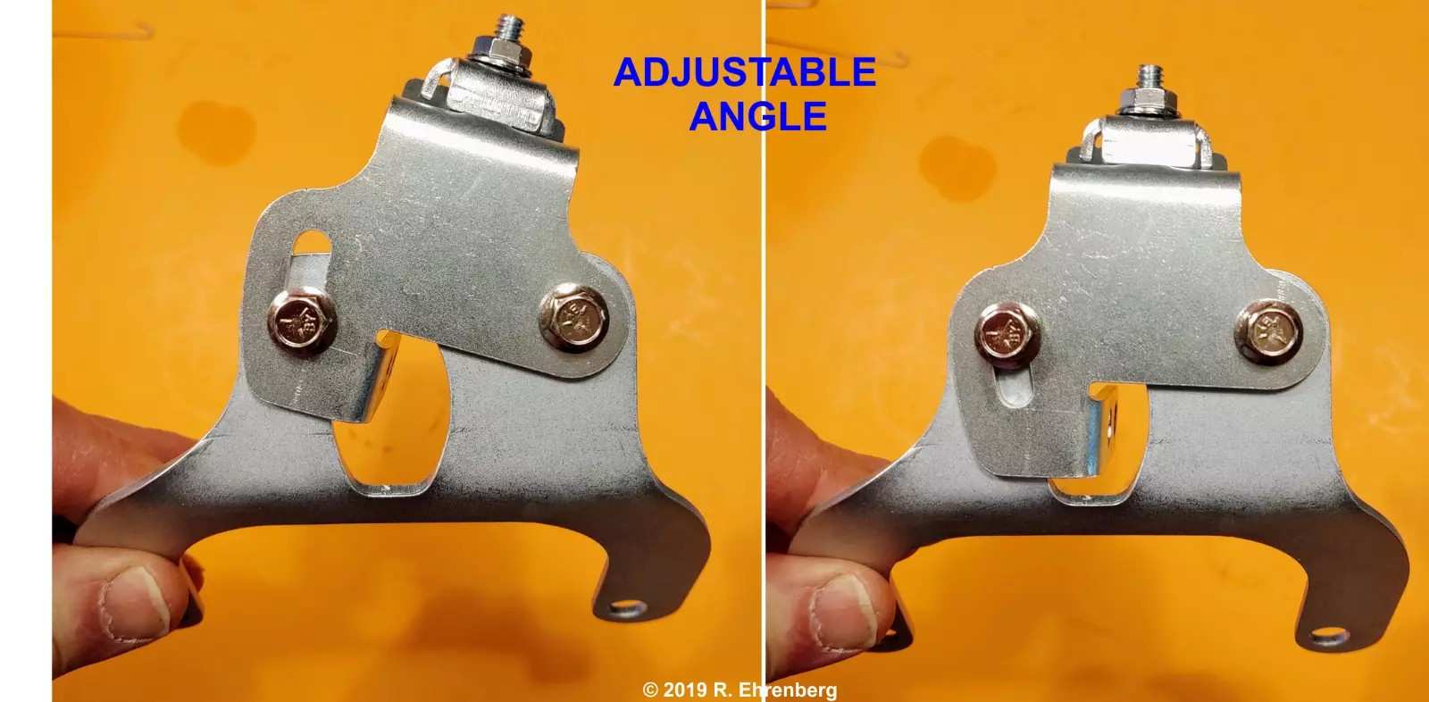

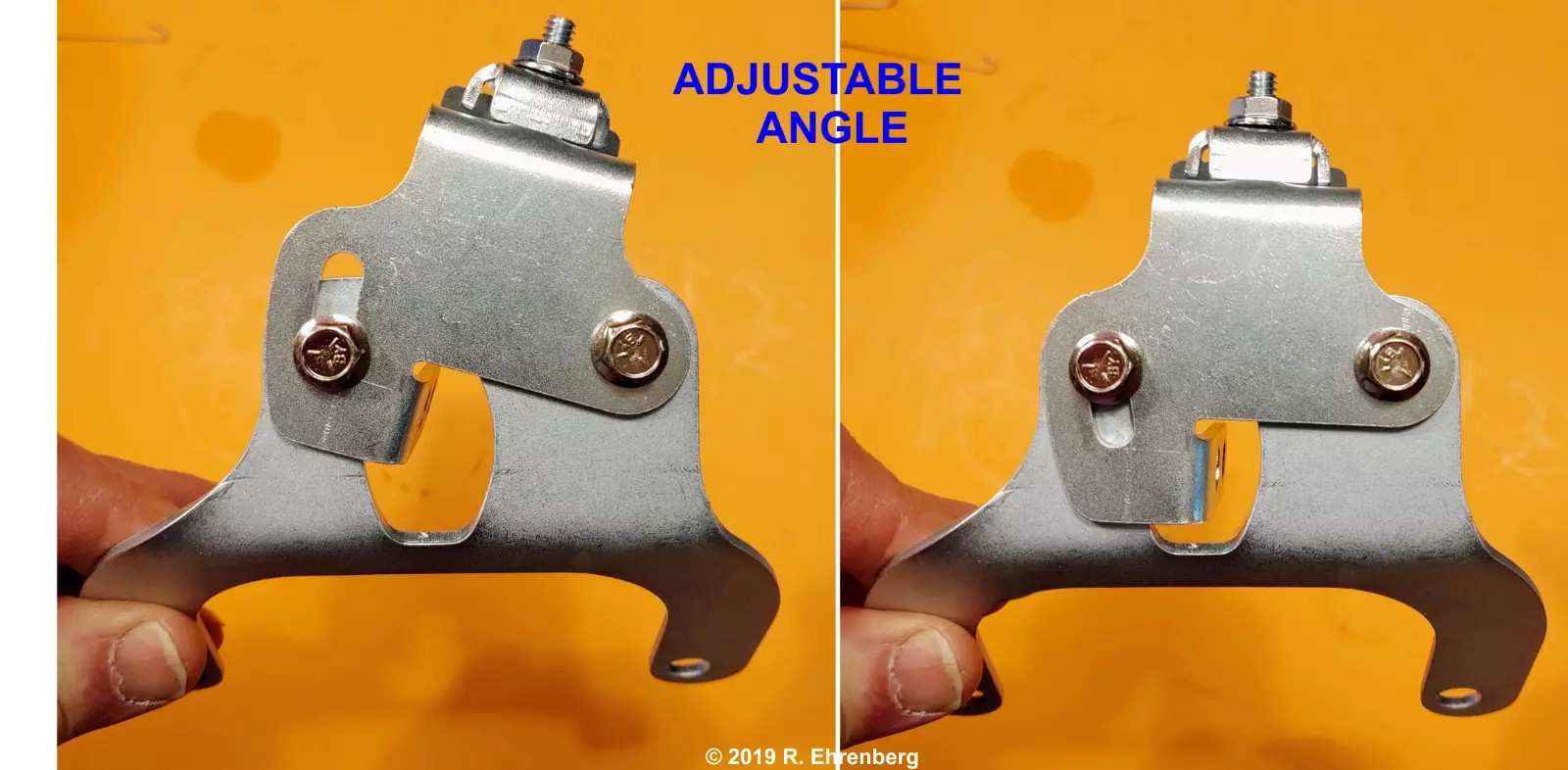

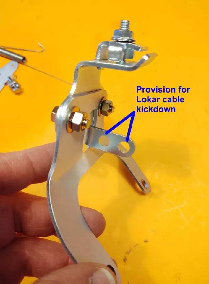

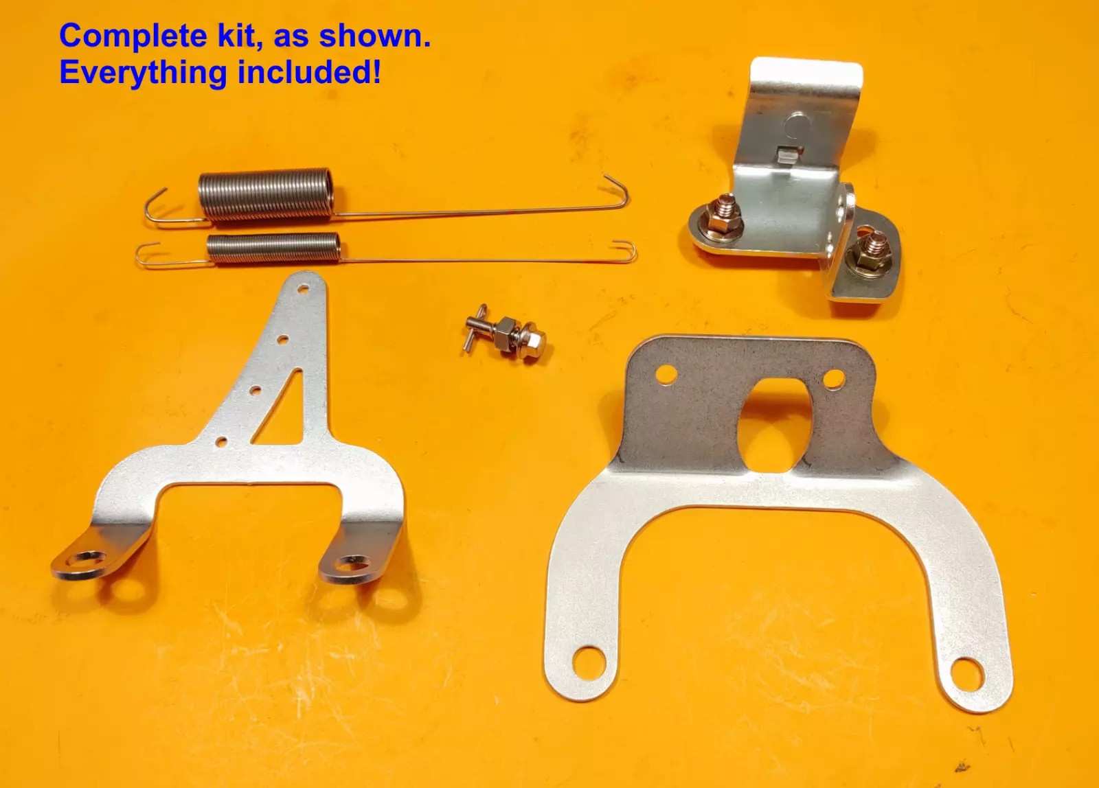

I picked this from Rick Ehrenberg (Mopar Action editor) who now sells on eBay under ricks-mopars. $76.97 Worked with my Edelbrock LD 340 manifold and a Carter carb For MOPAR LA Tall Intake THROTTLE BRACKET Kit 340 360 318 Dodge Plymouth 67-91
