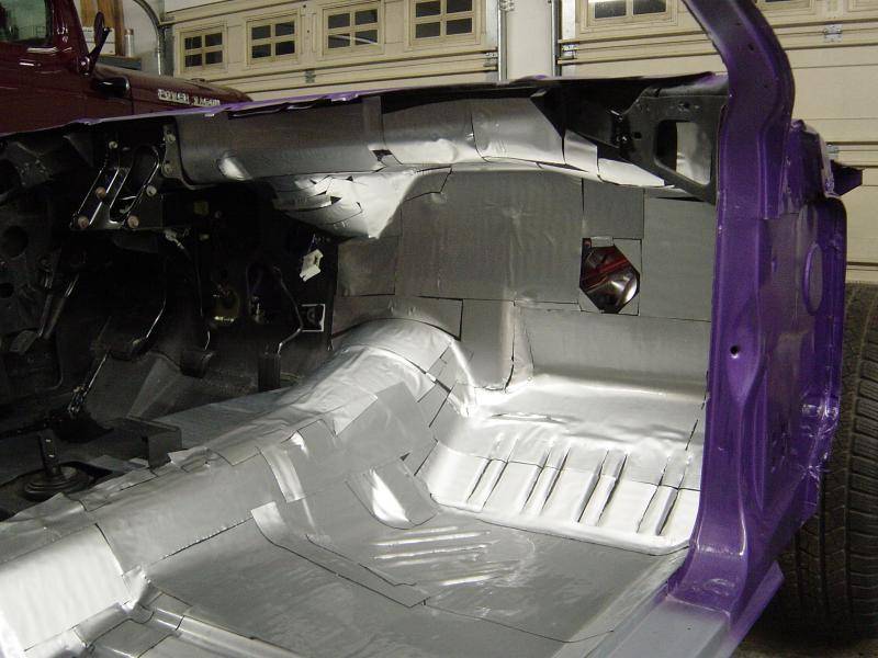

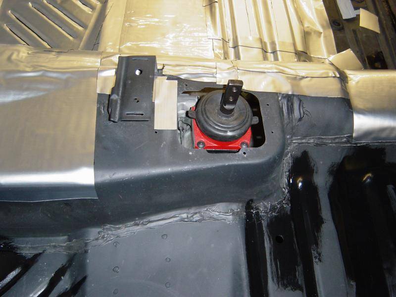

I have used a product called E-Dead with great success on my old Power Wagon. These trucks are so noisy some of the guys on the Power Wagon Forum say they wear earplugs... It is a peel and stick application; very easy to install, not so easy to remove... it is about 1/2 the cost of some of the other brands. I used it in my interior and inside my doors. It really makes a big difference in the doors! It is far cleaner and certainly more effective than the factory fiberglass pinned to the firewall with a few clips. For the roof I am going to use a spray on product like Leo suggested.
