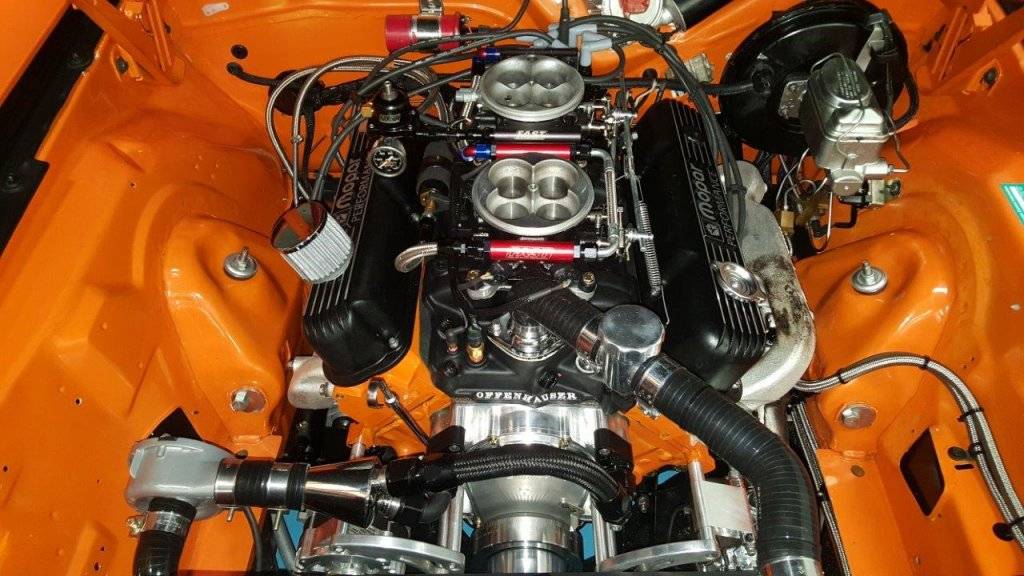

Never really been sold on the Ally heads apart from the weight have a set of E/Q heads on my 3.79 Molnar stroker N&A done the porting said the intakes were great but the exhaust was choked up & couldn't breath after porting & bowl hog they were better than the Eddies see pic nothing wrong with J heads its just i have to bore out the pushrod holes to run roller lifters
