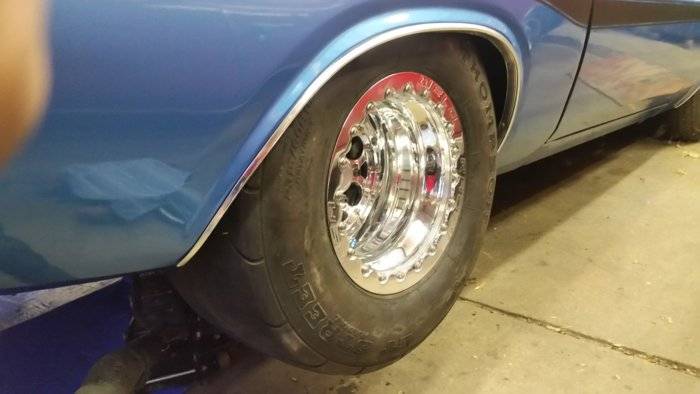

I have keystone classic 15 x 10 wheels (for the deep dish look) and MT 295' I am thinking of using an A body rear end to move the tires in about 2 inches on both sides to get the tires inside the wheel wells. Just hoping someone has already gone this way to see if it will do what I want. I don't think I need To tub it.

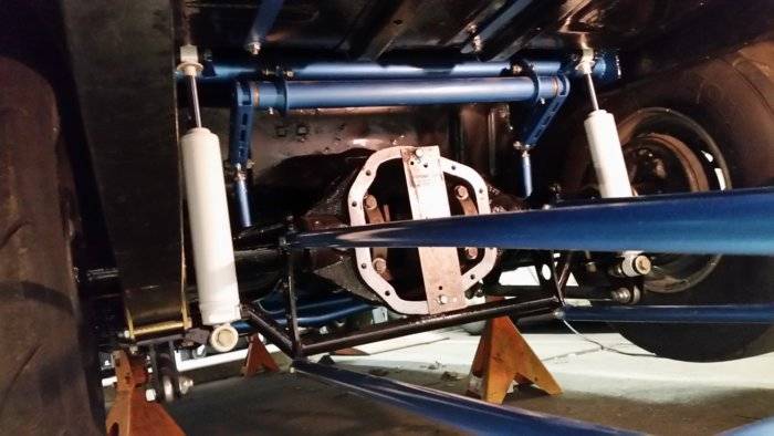

I have mine relocated to the frame rails (3"). I narrowed a 1 ton Dana 60 truck housing. I can run 29.5X10.5W Slicks or 315/60/15 Drag Radials on 12" wide wheels.
