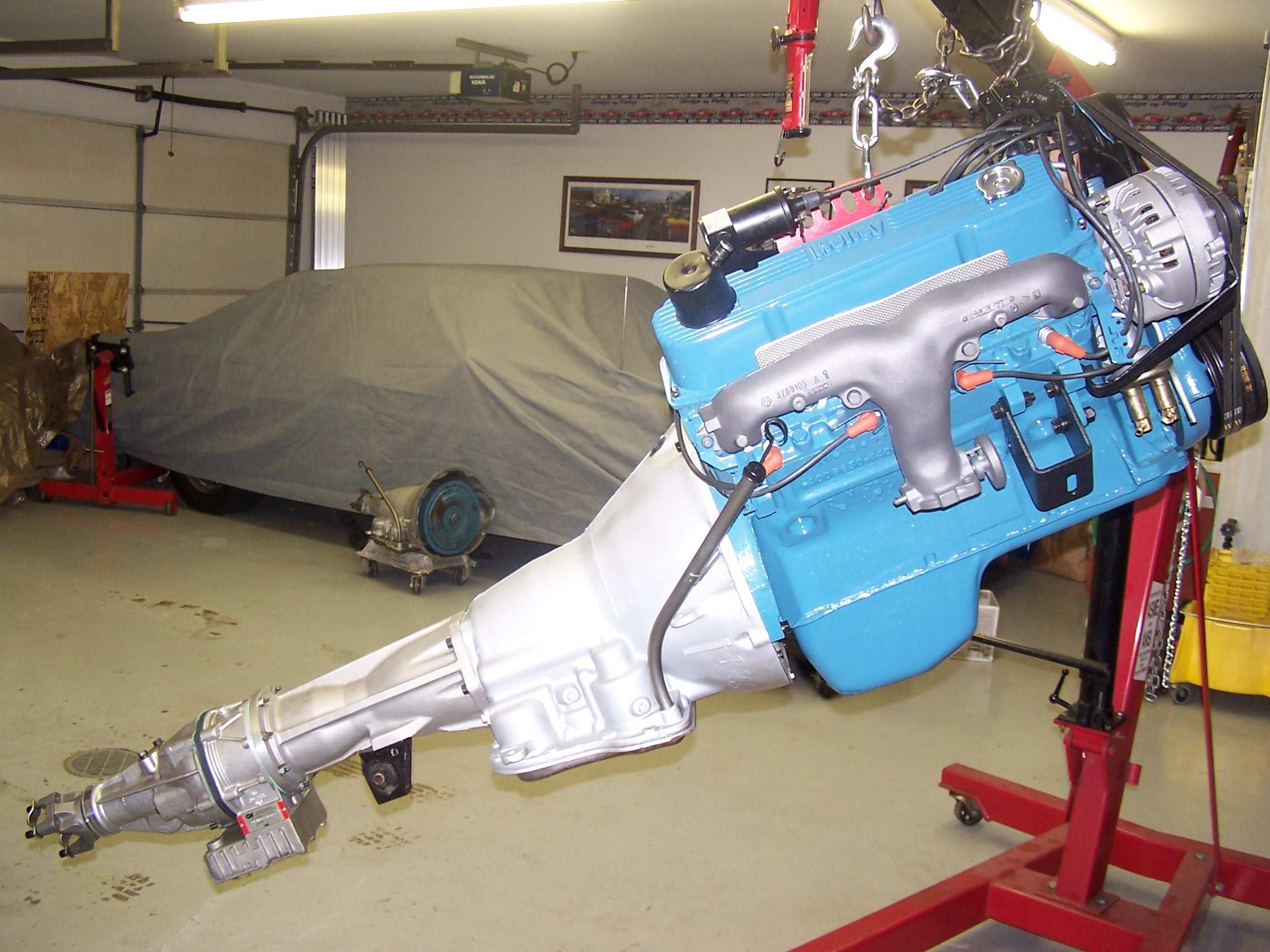

I put a Gear vendor behind my 440 Short shaft truck back in 2012. I would not do it again. It gives you a 22 % gear reduction but for my part it was a waste of money. I was looking for some fuel mileage improvement but got none. IMO it was a waste of $3500.00 with no benefits. By the way, someone said the GV addition to a short shaft 727 ends up less than a long shaft 727. Not so. Probably adds more than a foot. Here is a pic of mine. I can see where it could be an improvement for racing but not much else. I too would go with a 518. Even a beefed up 518 would be a better and cheaper swap.
I was over at a shop this weekend, and saw the GV on a 1969 GTX.
What rear gearing are you running on your combo? So with the 22% gear drop, no benefit in gas mileage? Thanks.

My truck had a 3.21 sure grip. I sold the truck back in 2015 but what I remember is when the gear vendor kicked in, my vacuum gauge dropped down along with the rpms. Mileage stayed about the same (10-11 mpg)
The other thing I didn't like about the GV was the design. I remember the shaft housing adapter design allowed for the nut fitting on to the short shaft to only get about 2 threads. I complained to GV about that telling them any nut should get full threads. They disagreed and said two threads was fine because when it was all together, the nut couldn't come loose. I chalked it up to typical GM designers and installed it. Maybe they were right since as far as I know the new owner is still using it but I have not communicated with him in a couple of years. All I know is I was not impressed by its design or performance since it didn't do what I thought it would. I can see where is could be an asset for racing but that's about all. I don't mean to piss on anyone's parade but just sharing my experience. Others must have good experiences with them since they are still in business. Good Luck.
