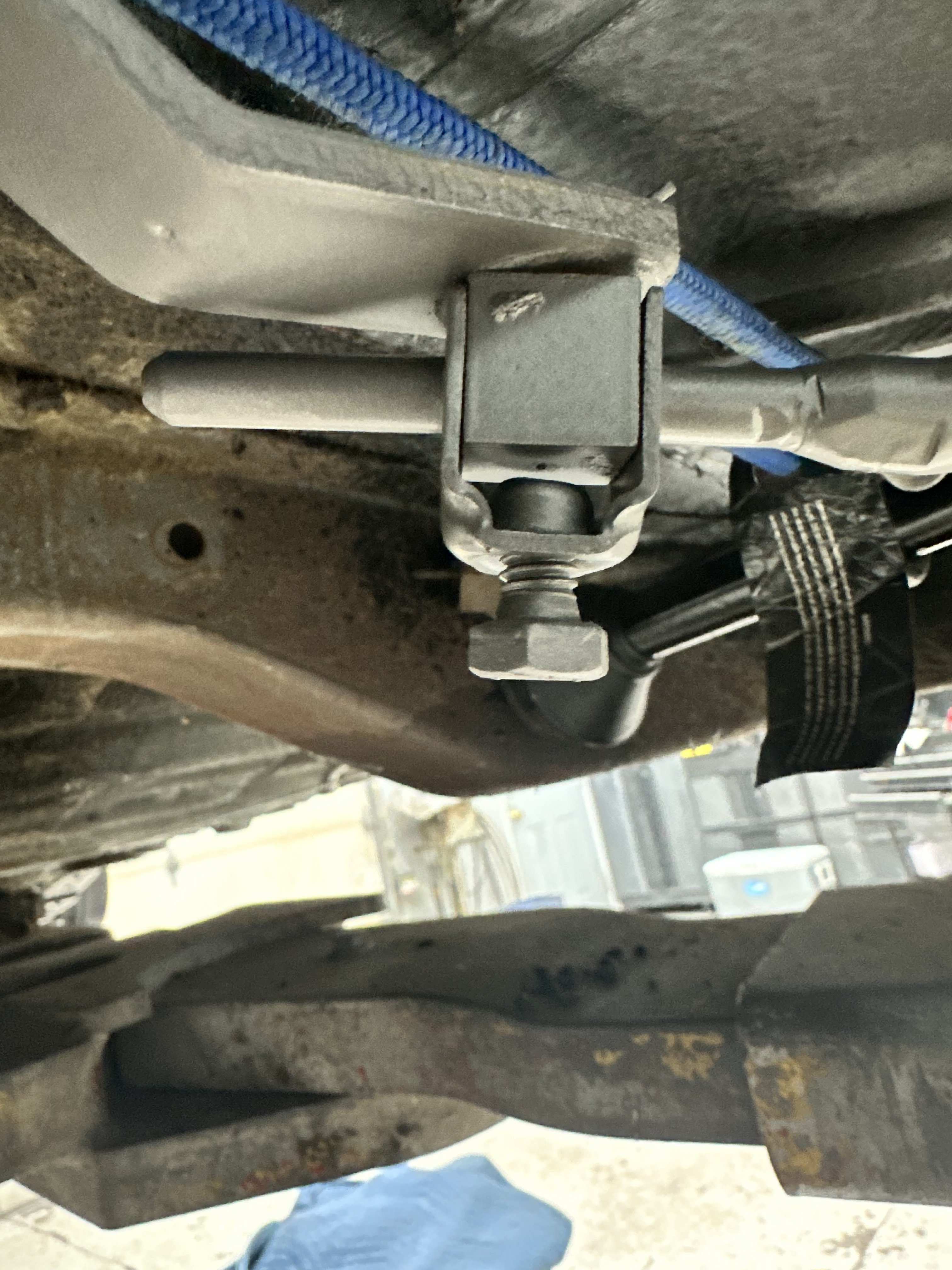

Friday at 5:16 PM #1 B B5blueGC Active Member Joined Nov 15, 2024 Messages 32 Reaction score 7 Location MD Does anyone know what type of bolt is used for the Steering Column Linkage lock? It is in the engine bay. Does anyone sell it or is it pretty generic? TYIA.
Saturday at 9:15 AM #2 EV2RTSE Well-Known Member Joined Dec 13, 2013 Messages 376 Reaction score 245 Which bolt are you referring to? Last edited: Saturday at 9:21 AM
Sunday at 6:21 PM #3 B B5blueGC Active Member Joined Nov 15, 2024 Messages 32 Reaction score 7 Location MD The one that holds the linkage.

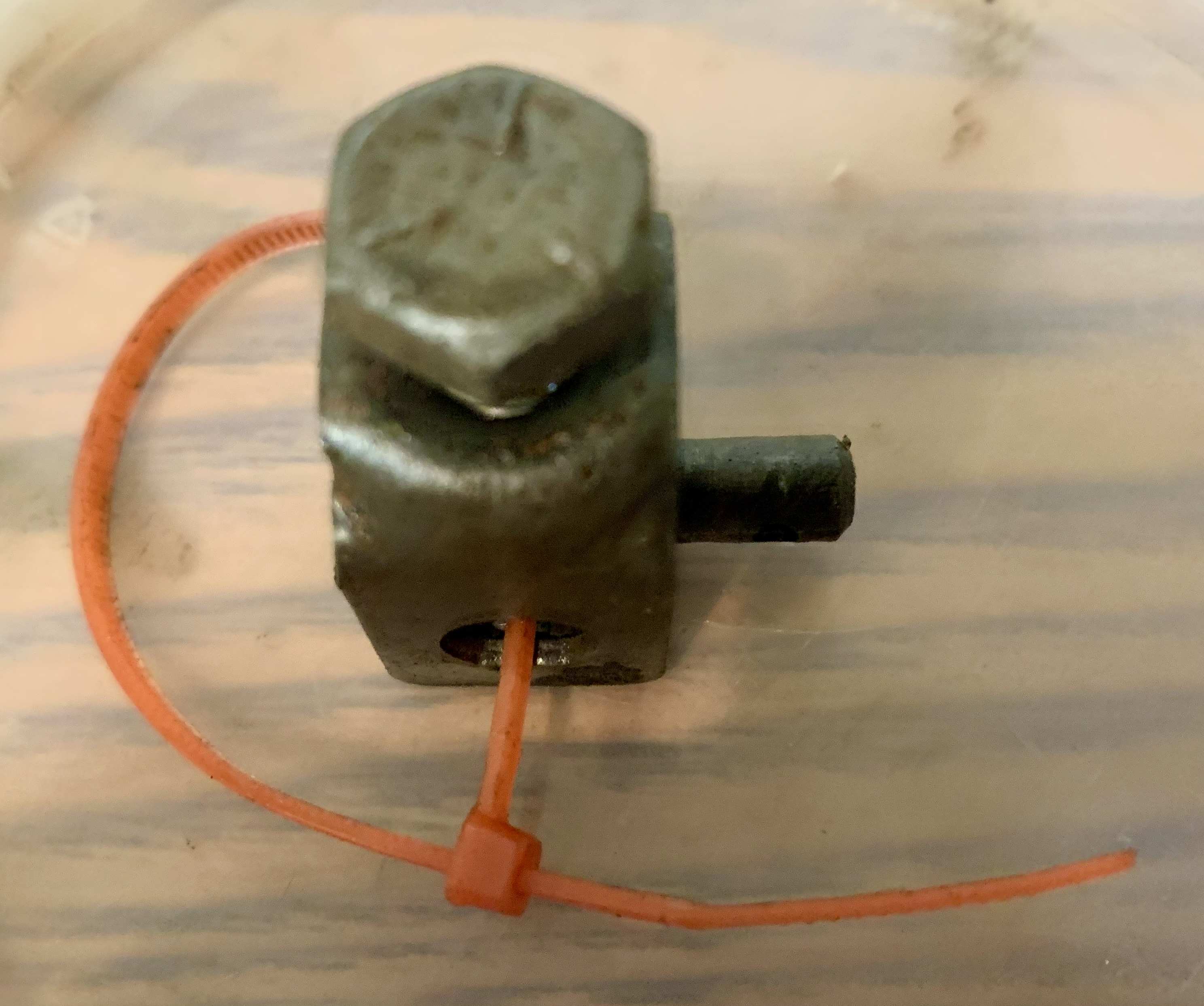

Sunday at 8:39 PM #4 EV2RTSE Well-Known Member Joined Dec 13, 2013 Messages 376 Reaction score 245 An original has the 3 lines in the head as in this pic - an ordinary hardware store bolt should be fine for a replacement, it looks to be 5/16-18 thread with a 1/2” head and a total length of just over 3/4”
