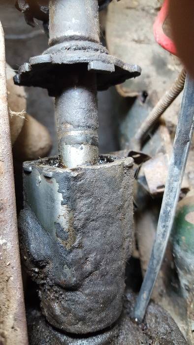

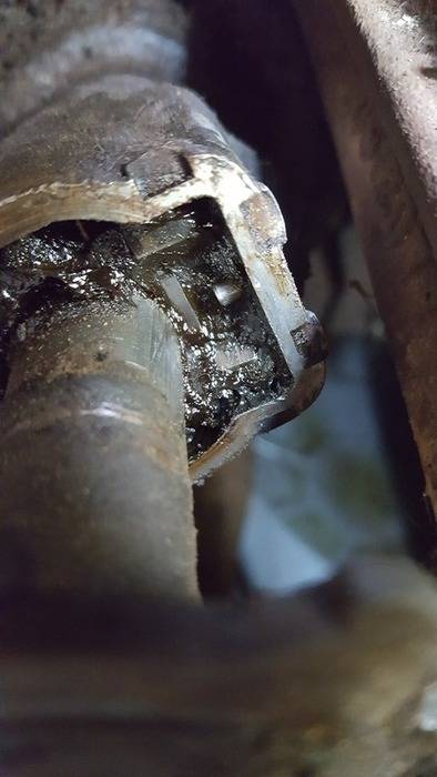

I found out there was a roll pin the hard way because I was too covered in grease to check my phone to see if there were any replies on here. I should have just cleaned up and checked my phone - would have saved me a lot of time! I removed the crown cap retainer (not sure what it is technically called), gave the column a few taps towards the rear of the car from the inside and thought I was home free. Not quite - but I could not figure out what in the world was hanging me up because of all the grease caked on around the coupler. I cleaned it all off and still couldn't figure it out. Then I turned the coupler and finally saw the little roll pin sitting flush with the surface. Unpacked some grease from inside the coupler and verified that was a pin and it is what is holding me up. I even took some pictures so I could ask about it - but now I will just throw them up on here in case anyone else ever reads this and the pictures would help them see what it all looks like.
My last question in this chain (hopefully) is this:
Do I need to tap that pin out from the inside of the coupler out? Outside of the coupler in? Or does it not matter either way. I have a feeling I am way overthinking this - but I definitely do not want to waller out that hole if I go the wrong way.
Thanks again - you guys rock.

There are 2 roll pins in that coupler. You found the small one for getting the guts of it out, and yes just tap it out from the outside of the coupler in. The roll pin which I talked about in the previous reply is the larger one about 1/4" which holds the coupler to the steering gear shaft. That's one I thought you were asking about. Remove some more grease and you will see it.
