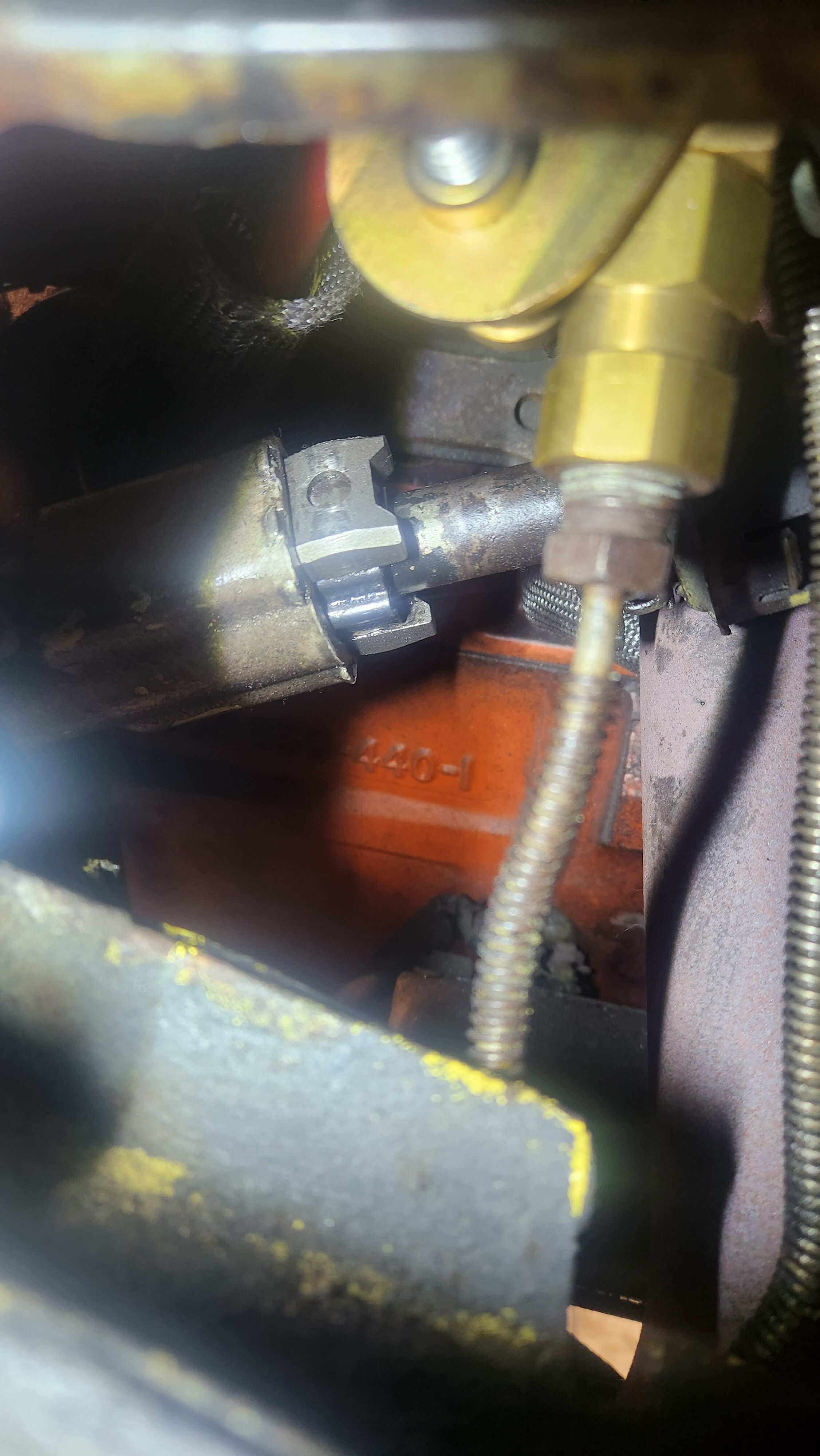

Hello again. I've been working recently swapping out my k member on my 73 challenger with a 440 and power steering. when I went to put everything back together, my steering column was too short to reach my gear box. The gear box had come off in the process and it was a pain In the ass to get back on. I'm wondering if it's possible that my steering shaft is collapsible and we collapsed it in the process? Or a different reason? The steering wheel is still in the same place as before.
If it's collapsed, what's the best way to fix it? Really would like to avoid removing the k frame again if possible. Thanks!
The steering columns have nylon pins that were designed to collapse during a front collision. Certainly possible that the are brittle and broke as you removed the shaft from the gearbox. Not a problem to not have them though. You should be able to pull on the shaft some to lengthen it. If after doing so it is still short, how much is it short by? Did you go to manual steering or did you leave the steering gear as it was and just changed out the K member? The picture shows the column shaft going onto the gearbox but does not have the attachment piece that goes on the end of the shaft.

He other pieces are out of frame on the shaft if that's what you're referring to. I didn't swap anything out with the k member. All as it was.

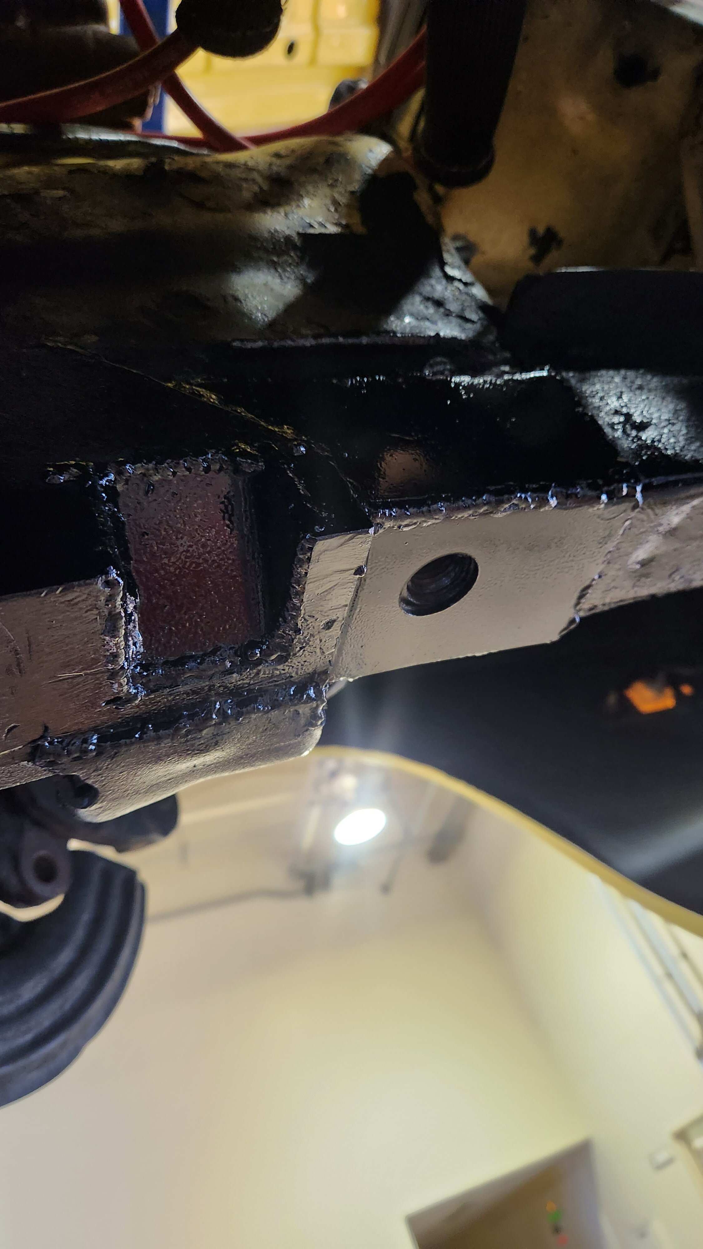

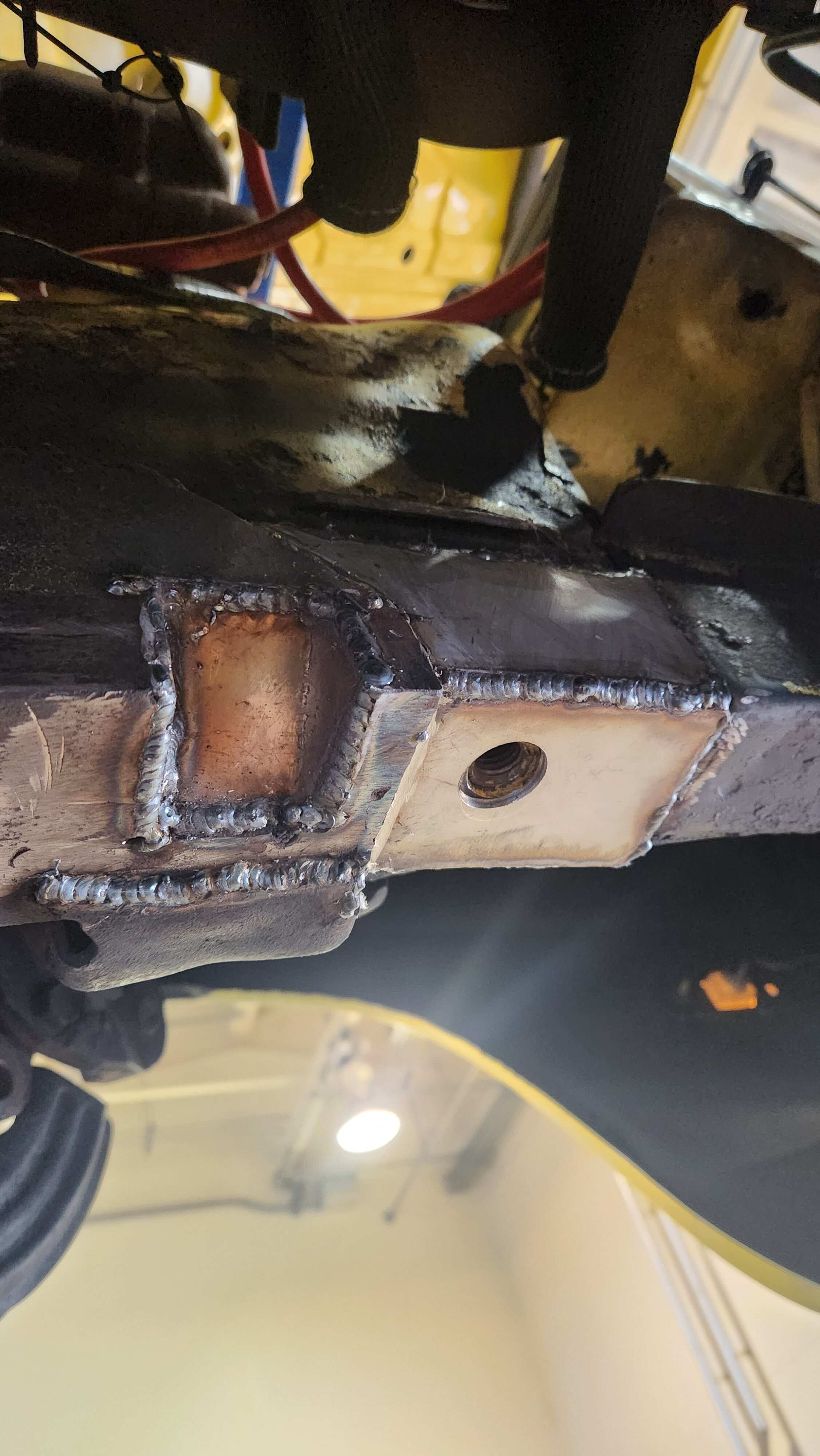

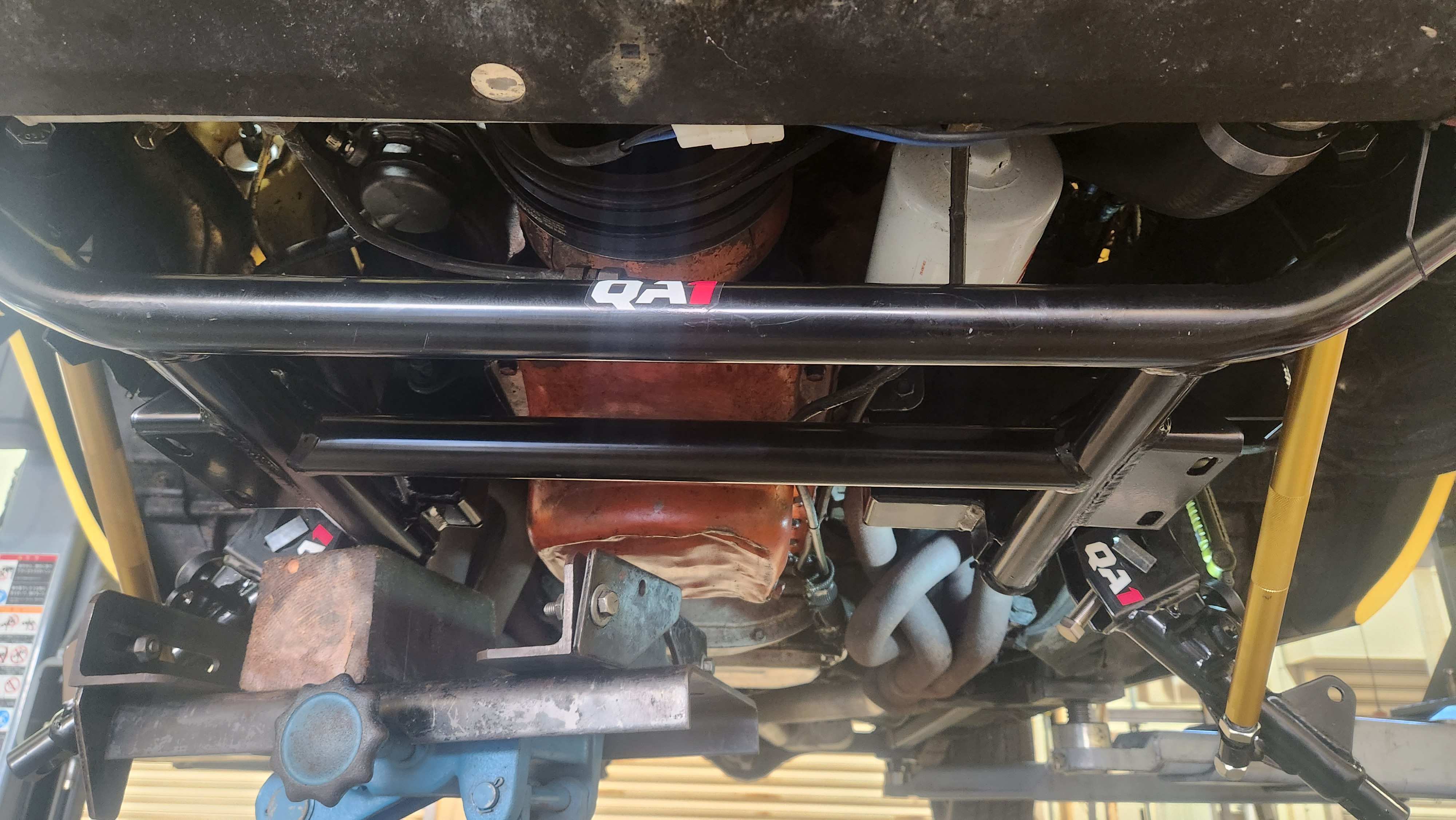

Found quite a bit of frame damage as well on the drivers side where the k frame mounts. There were already quite a few patches. Added my own as well as a notch for the additional travel of the lower arm(last person who added super thick patch on neglected to include)
Those military auto hobby shops are great! Have fun! By the way, your oil pan looks like it got into a fight and lost the match! Ugh!

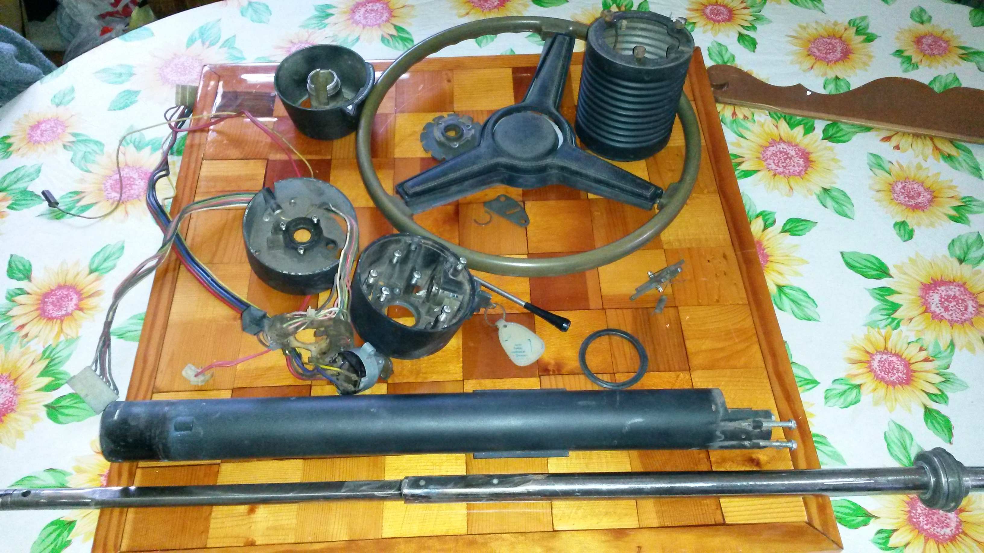

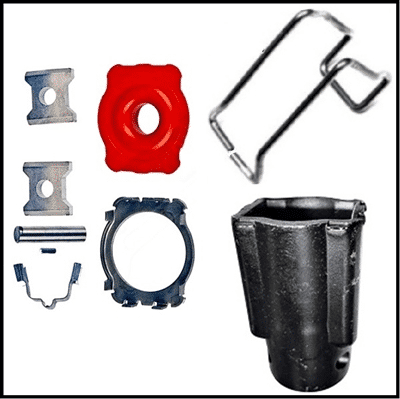

Below is the column apart. The 2 pins can be seen on the shaft.
Before you finish you might want to consider putting ER-16 bearing in the end or steering column. Find it on eBay for about 6 bucks. It has a 2' od and a 1' id.
If you don't have the clip for the cup,get it.
In the illustration above you can see the small pin between the spring for the shoes & the pin the shoes sit on , make sure that pin is re=installed it will prevent the shoes from sliding out of the coupler if the shaft is damaged & collapsed before .
You may want to check were the column passes through the firewall. Make sure the column is not hung up on firewall mount. The nylon pin is pretty difficult to break. I recall having a similar issue. I don't believe there is any difference in column length between small block and big block length. Consider measuring the internal shaft length and see if someone out there has one they can measure to confirm if it may be a sheared pin.
