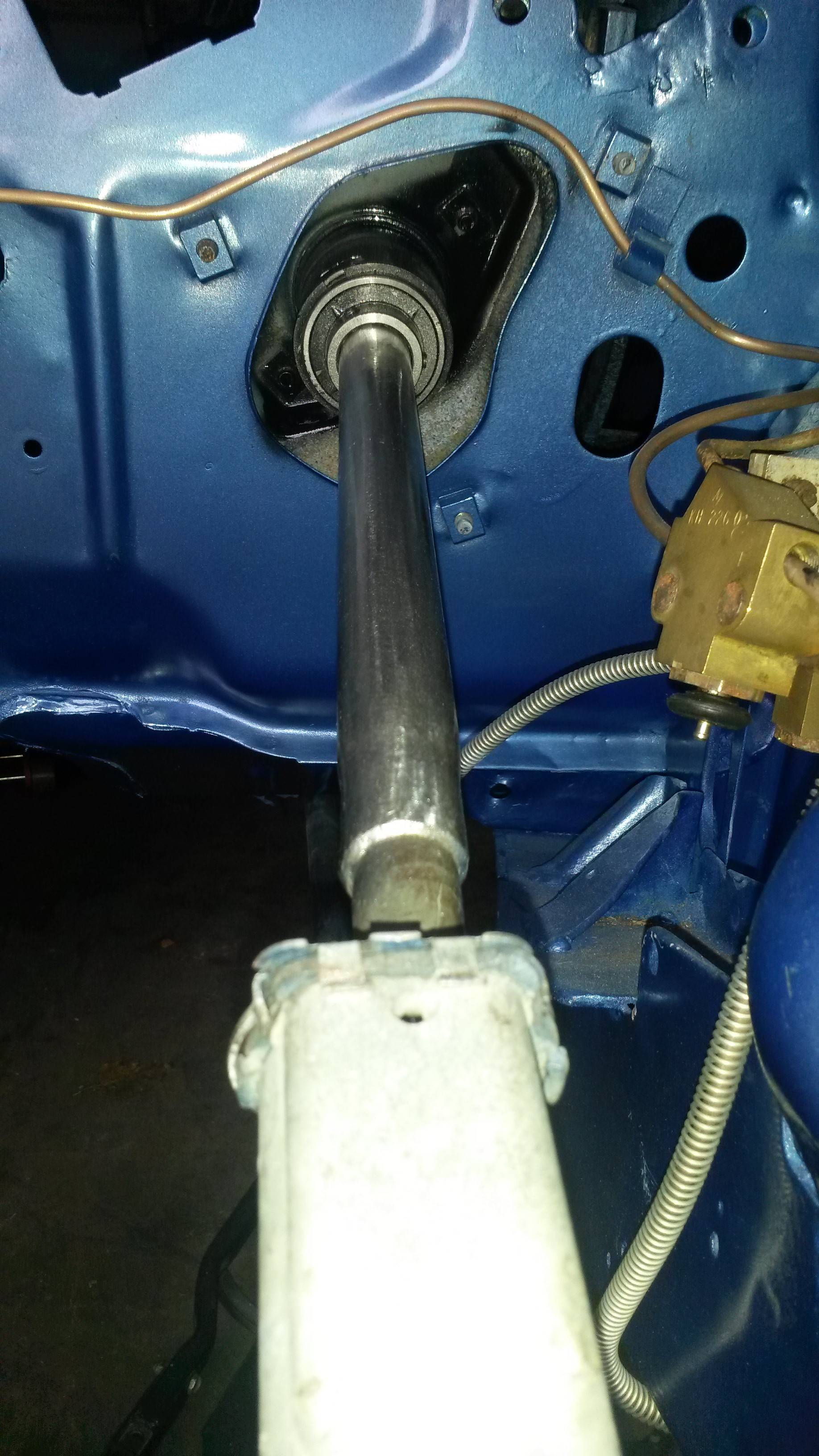

NO.Shaft length is different.
Approx 7" different in length from the bearing to the coupler
Power Steering columns are shorter.

So what I would do is shorten the shaft. If you look at the shaft one can see the two break pins. they break in the event of an accident and the shaft collapses. When I rebuild mine took it apart cleaned and reassembled. Used a nylon hot glue gun to re inject the pin and grooved cavity area. takes very little. You have nothing to loose to take it apart and look. don't drop it or you start all over. Also For 9 bucks ER-16 bearing in the end.I think it's a better fix on ebay. not 35. SER205-16, ER205-16, ER-16 1" Bore Insert Bearing with Snap Ring 1"x52mm | eBay
search for the post : Plastic steering shaft connectors broke .​
lot of other good info and a link to a video of any and everything you need to know about a steering column.
