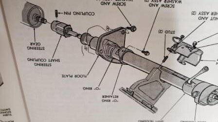

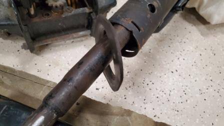

I finally got it out with torch and small sledge hammer. couldn't find a shop that had time to do it so I brought home and pounded some more. Well now I am looking at it the floor plate is flopping around and not attached to anything. Seems like to me it was fixed before. But I can't were is was welded or anything. This is a 71 challenger. I have manuel it shows a retainer and o ring. I have never had this. Also it's just two bolt's. Should this plate be welded or fixed on the column? Not sure about I attached some pics.
moparlee
Jul 25, 2011
3,054
1,312
Mid Michigan
I finally got it out with torch and small sledge hammer. couldn't find a shop that had time to do it so I brought home and pounded some more. Well now I am looking at it the floor plate is flopping around and not attached to anything. Seems like to me it was fixed before. But I can't were is was welded or anything. This is a 71 challenger. I have manuel it shows a retainer and o ring. I have never had this. Also it's just two bolt's. Should this plate be welded or fixed on the column? Not sure about I attached some pics.View attachment 74285 View attachment 74286
There is nothing that is welded. Three pieces - floor plate with a gasket which is bolted to the floor pan with three bolts, an o-ring, and the o-ring retainer which is bolted to the floor retainer with two bolts.
Looks like you are also missing the the plastic retainer between the column and the shaft.

I took the plastic retainer out when I heated it. Yes as I looked back at the pic I see I am missing the o ring. I bet it was sold old it acted like a glue to keep it from moving. The vibration of hitting on dislodge it. I thought oh **** I have done it again. Probably could make a sit com with that being the main line in this hobby. Thanks
