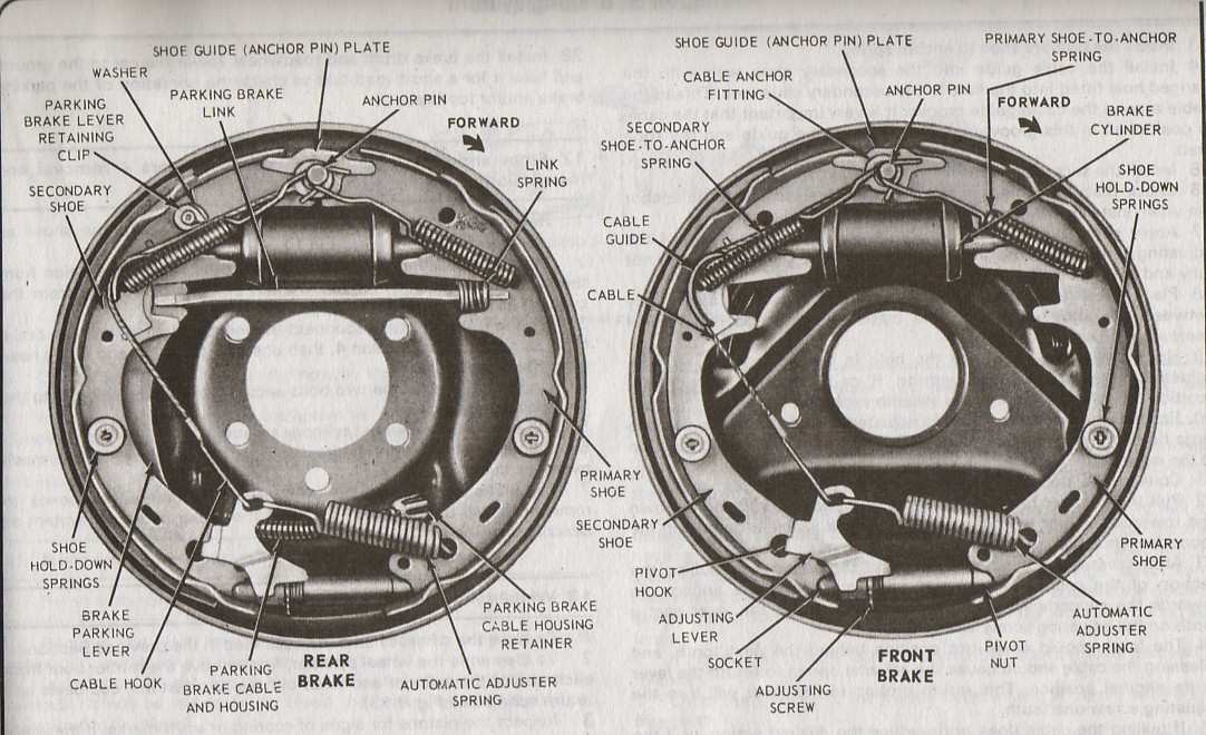

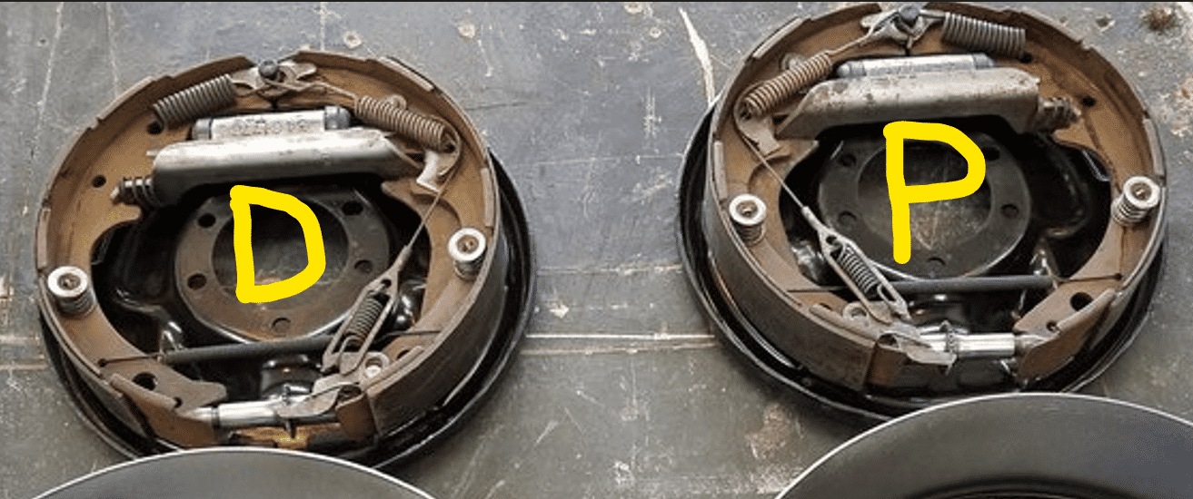

Tuesday at 7:23 PM #1 O Obash Member Joined Mar 30, 2025 Messages 6 Reaction score 12 Location Syracuse I read somewhere that the rear brake shoes are different sizes: front vs back. Asking because my Right rear sticks a bit after a few miles.

Tuesday at 7:50 PM #2 D Daves69 Well-Known Member Joined Feb 4, 2014 Messages 342 Reaction score 116 Location ChiWest The rear shoe has a longer pad than the front. Driver side and passenger side.
