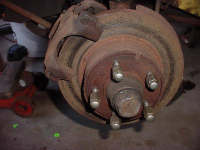

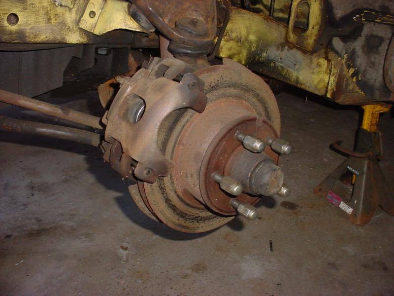

Just received the Centric Rotors. Everything matches the 1970 specs. They also have nice reinforcing ribs on the inner hub. Pics of the brakes before teardown. Sitting for a long time!
