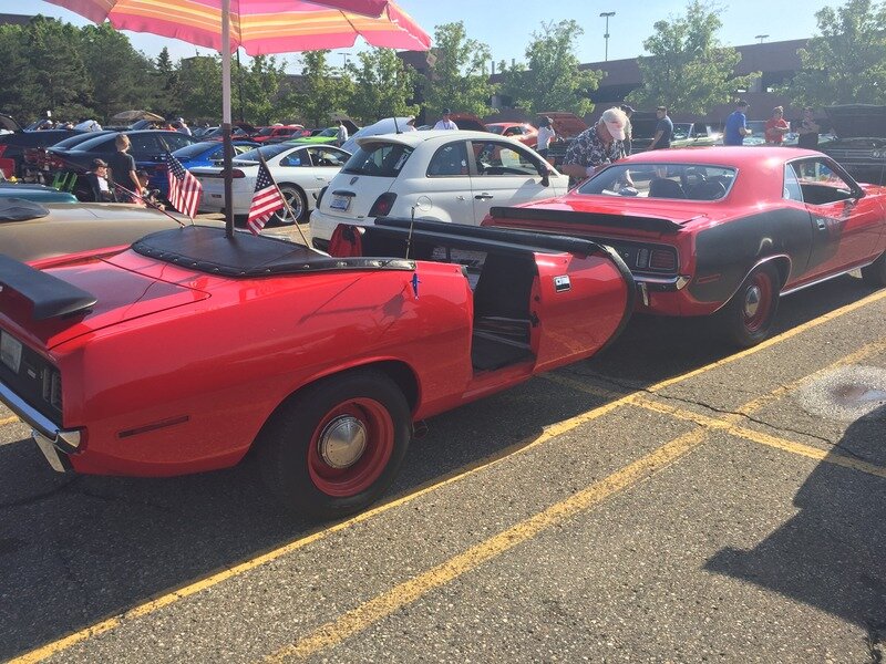

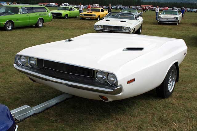

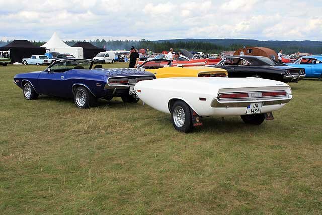

Here ya go.
Idea number 1.

Thanks for the replys guys. I guess a trailer like the ones above is an option. I was hoping for maybe some ideas like getting a smaller spare tire or an inflatable tire and maybe bring a small compressor.

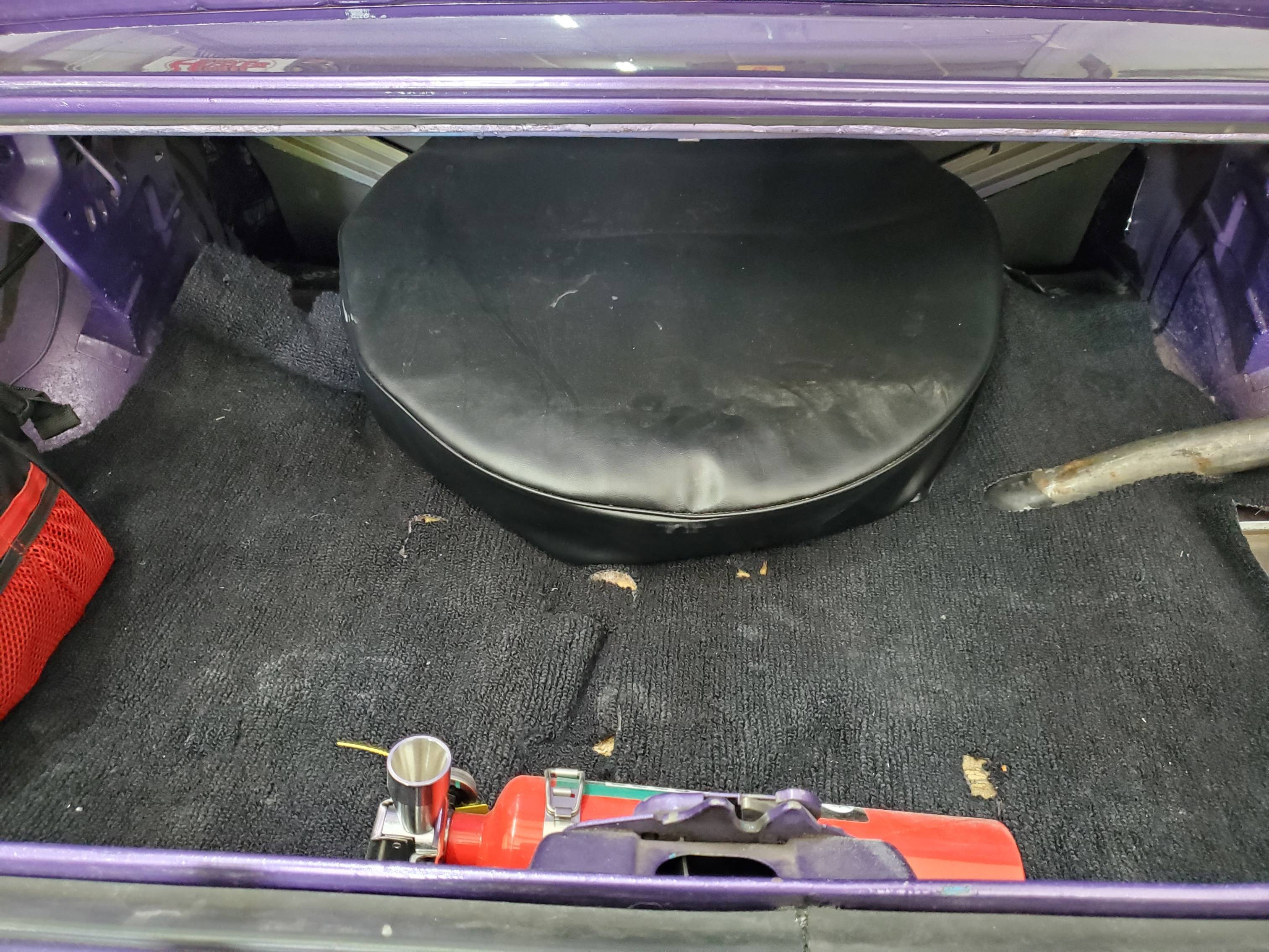

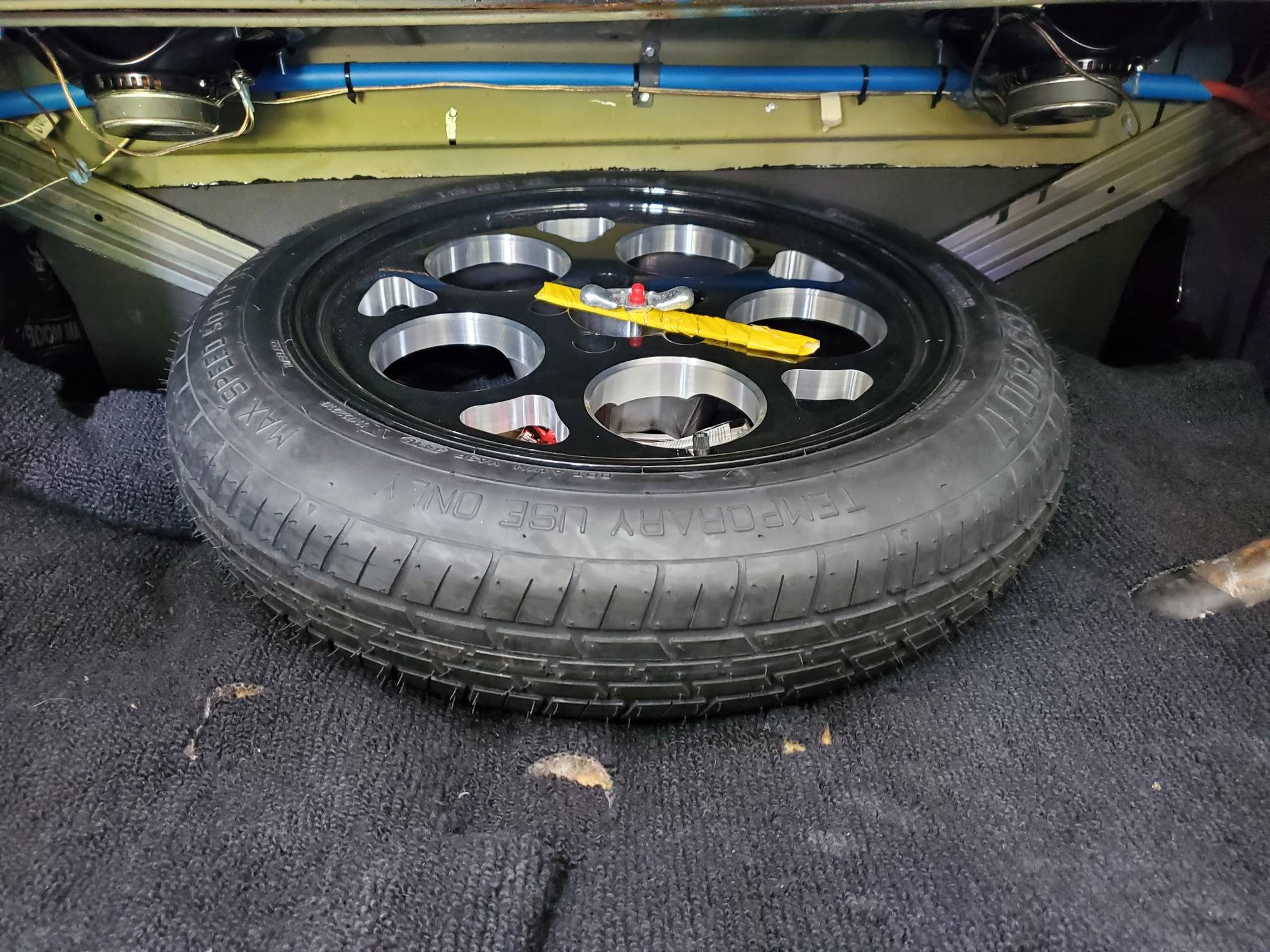

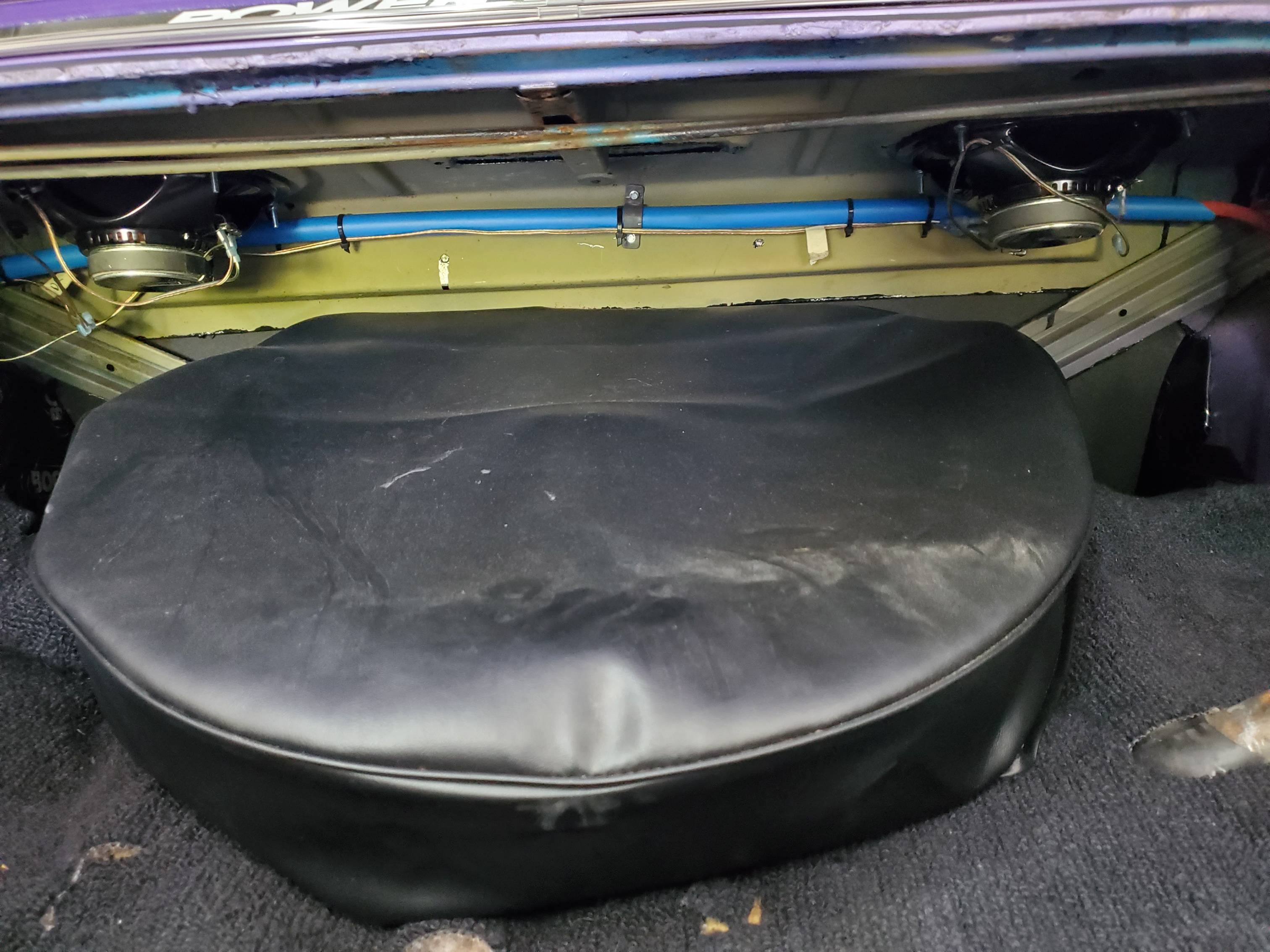

I need trunk space and a good spare on the Hot Rod Power Tour long haul so to clear my wilwood big brakes I bought a 17 x 4 Vision Wheel from Summit and had Discount Tire mount a skinny 135/80x17 temporary spare on it. Diameter matches my 295/35/35 rears but it’s half the thickness of normal spare so I can stack folding chairs etc above it

Thank you 70chall440 and Steve (Drivun). Two excellent suggestions. I am going to look into both of them. My car has 15X7 wheels so I try to find a 15X4 wheel. I am already a AAA member. I have driven my car as far away as 500 miles so AAA is definitely a good idea. I like the small compressor idea too. I think my fiancé has one that she doesn’t want. Thanks to everyone who responded.
