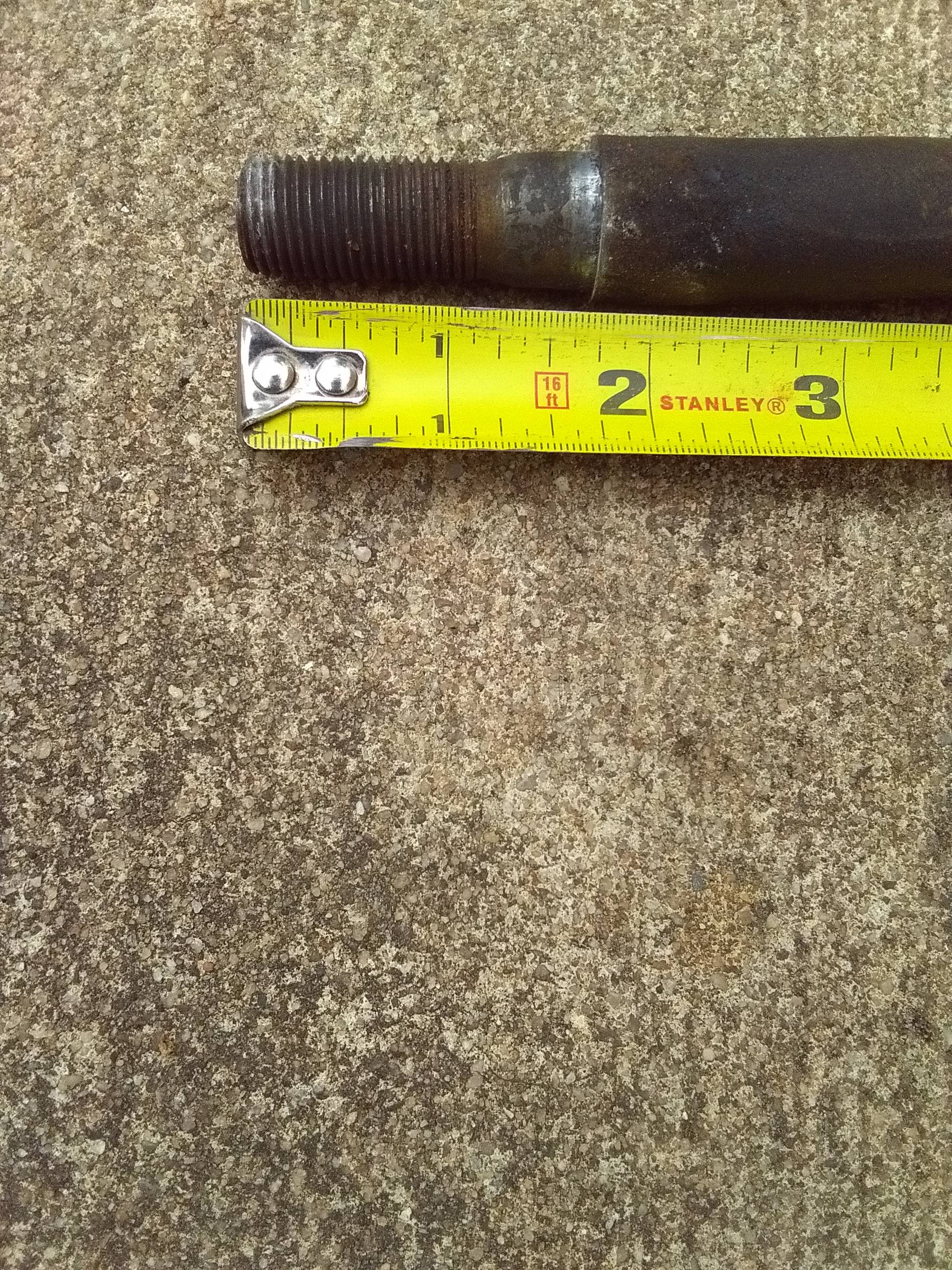

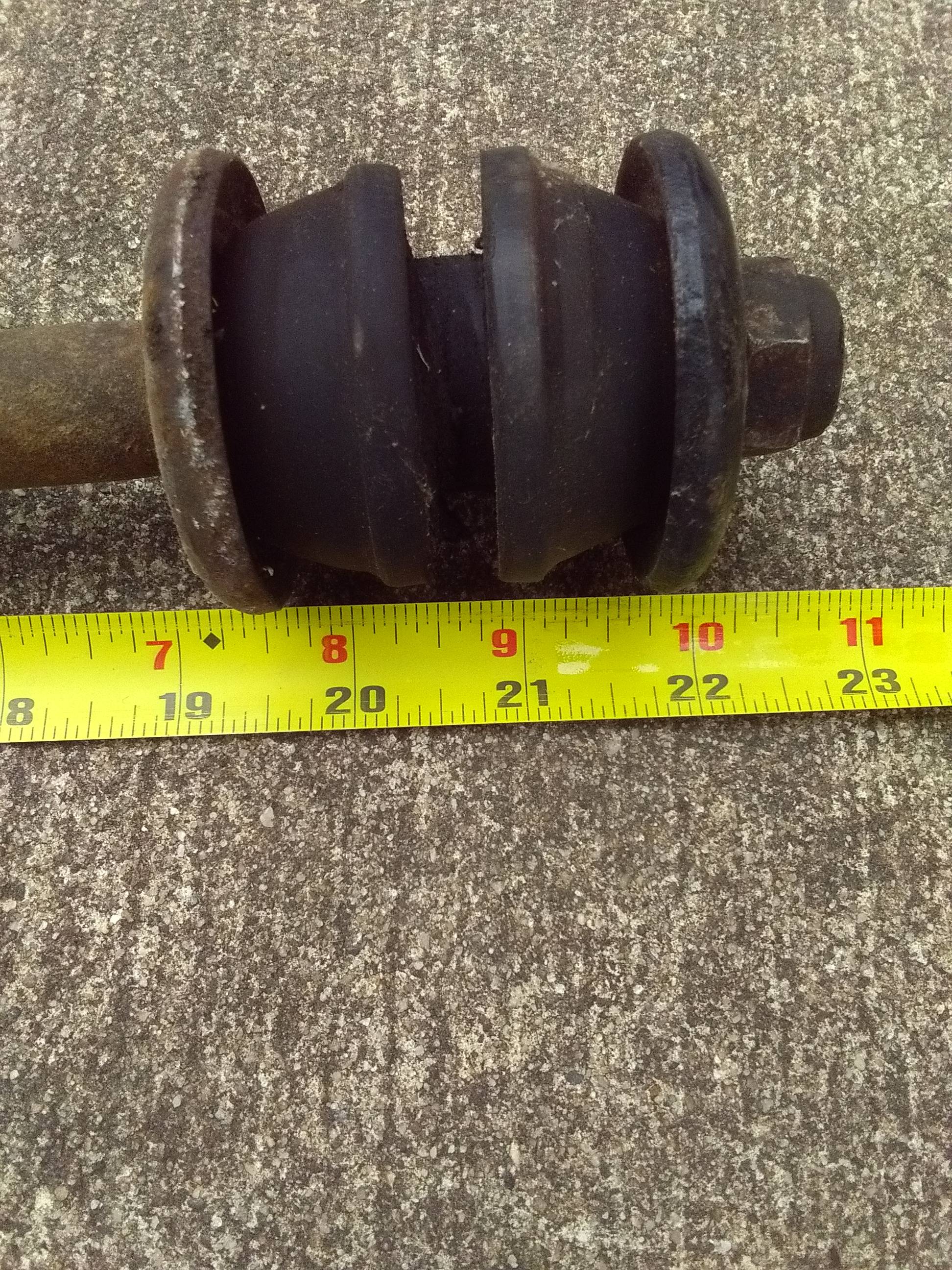

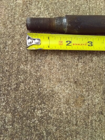

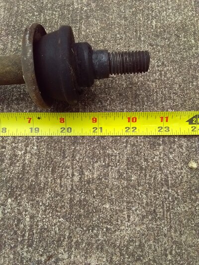

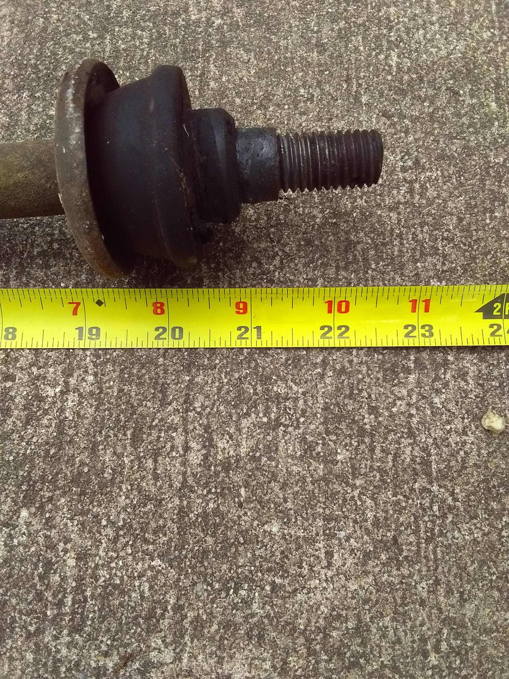

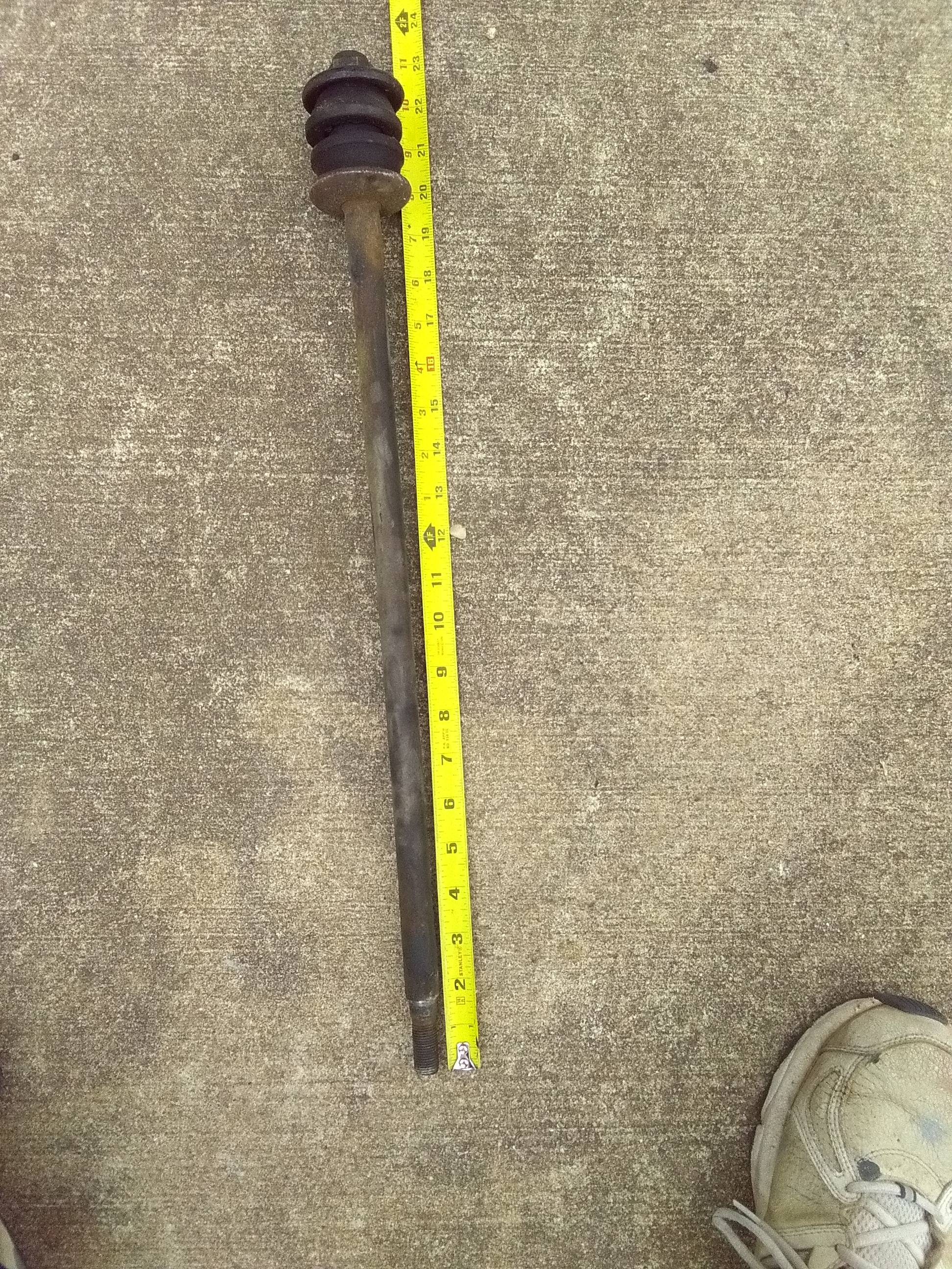

these pictures are from my 71 cuda set the caster as high as you can I used off set upper control arm bushings and got the caster up to 4 degrees postive it feels good there 1 1/2 deg the factory calls for the car felt squirrely it handles much better with the adjustable stut rods too

at the 1 inch and 3/4 mark to the 20 and 1/2 inch mark is 19 3/4 just make sure the suspension goes up and down with no binding you can shorten it a very little there is not much adjustement in the new rods their purpose is to keep the lower control arm from going back and forth the rubber bushings on the original strut rod had give back and forth. your upper control arms are perfect i did the offset bushings before i knew about the tubular arms get as much caster as you can with the upper control arms the car will feel a lot better
