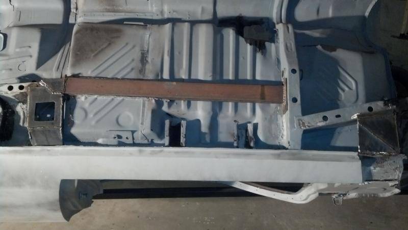

Leo.
My car is on a rotisserie. I was wondering what your thoughts were on welding in torque boxes and frame rail connectors while the car is on the rotisserie. My fear is that the car may be a little twisted up on the rotisserie and I don't want to weld the torque boxes and frame rail connectors into place if teh car is twisted?????? I was going to drop the car back onto the suspension, weld the frame rail connectors and torque boxes into place then take the car back off of the suspension to get the underside and inside of the car primed, seam sealed and lizard skinned?

Obviously the frame should be checked before any structural welding is done. It would be best to mount the chassis to a jig, or at least put it on jackstands and check all measurements. Once you are satisfied with your measurements, you can weld the front and rear of the frame rail connectors. Or use some small square tubing across, and length wise to stiffen the chassis during mockup. It should be alright to remount to the rotisserie and finish welding everything.

I went with 2X3 tube welded up through the floor. Nice thing about that is you can then run your cross bars off of your main hoop down on top of the connectors. IMO this is the strongest way to go. Some thing like uscartools would be a close 2nd.

I went with 1x2 tube contoured under the floor rather than cut through the floor pan which makes a ridge under the rear carpet , I would at least block the body where the suspension mounts & weld in the connectors , it would save a lot of work mounting the suspension & still stress the body the same way

Thanks for the input. Seeing as how I plan on installing a cage sometime in the next year or so, I'm leaning toward the 2x3 run through the floorpan. Not too worried over the intrusion into the rear floor since the back seat has been sat in maybe 3 times in 20 years. Really looking forward to getting this project restarted & back on the road.

After I got mine tacked in I turned the car right side up and they don't go into the floor more than a 1/2" or so. Nothing a little extra carpet padding wont take care of.
