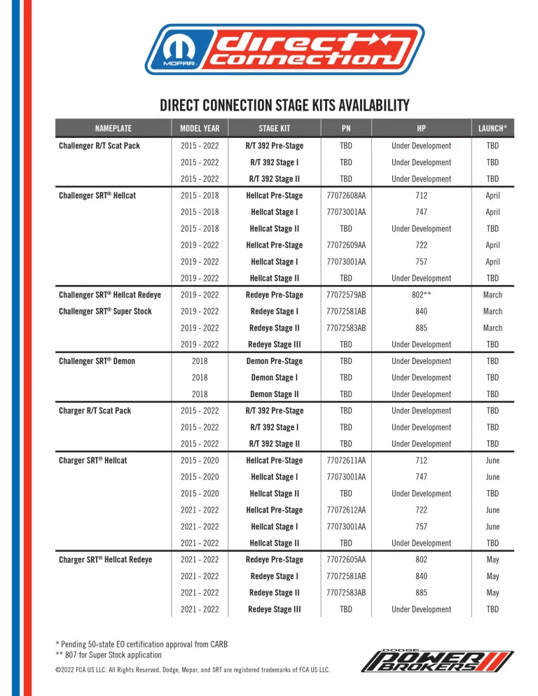

The global total built is 1610, and that's less than any run of either Demon run. It doesn't have the hype or marketing effort, but it will come out as an underdog with great power potential, especially with the stage 2-3 direct connection dealer-installed kits, which are connected to your VIN once installed. I will have a dyno run on mine when it is complete with the DC lt with Gesi 49 state cats installed along with stage 2, which is already installed with 885 hp. yeah, yeah, I know I'm keeping it legal and factory. Hey, I'm getting older, LOL.

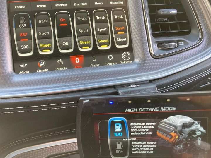

It comes with a helephant pulley, tune, 180 stat, and high-flow filter. I had the heads studded with ARP studs, 080 pushrods, and Stanke motorsports rocker stabilizers and collars. I've had 3 Hellcat Challengers, and I found that an ounce of prevention is worth a pound of cure. In simple terms, build a car that can handle 1100 hp and do 850hp, and it will last. And everything is invisible. My dealer gave me an OEM demon hood they had in the back, so I have two painted hoods and the demon race filter on. These kits follow typical Dodge standard operating procedures and are slightly underrated power-wise/claims-so. In short, it runs around at 837 on 93 tunes. The 2018 Demon had 840 on the 100-oct hot tune; when you hit the high octane, you are about 900. Stage 3 is coming and will be over 1100.
