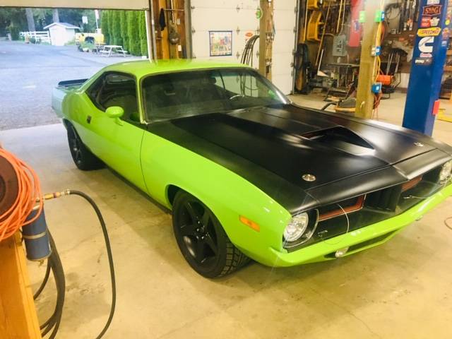

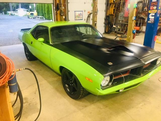

Been done 1000 times, personally I prefer the 72-74 tail lights but what I do dislike about the 72-74 are the side marker lights and front turn signals so when I did my Cuda I fix both. I frenched in the side marker lights and got headlights with turn signals inside them.
I love those frenched side marker lights, it makes a HUGE difference! That should have been done from the factory!
Thanks and I completely agree. Having had some of these cars when they were relatively new, those marker lights were always getting broken and I hated that they stick out.
