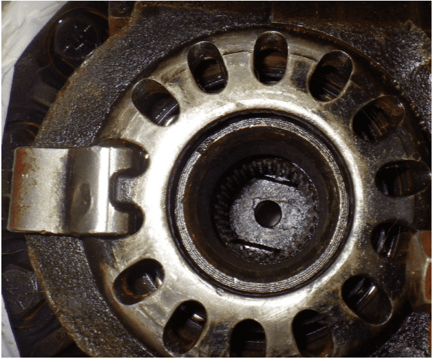

A clutch type sure grip has thrust buttons for axles with standard tapered bearings that allow axle end play adjustment.
A clutch sure grip requires removal of the thrust buttons to use axles with "green" bearings. They will not have an adjustment.
It should look similar to this with buttons removed...……..
What has been removed...…….

I have found the preload spacer that is almost if not exactly like a piece of axel that's about an 1 1/2 wide and looks nothing like the link above,
Is that a "cone" LSD like picture below, typically in the 489 cases?
