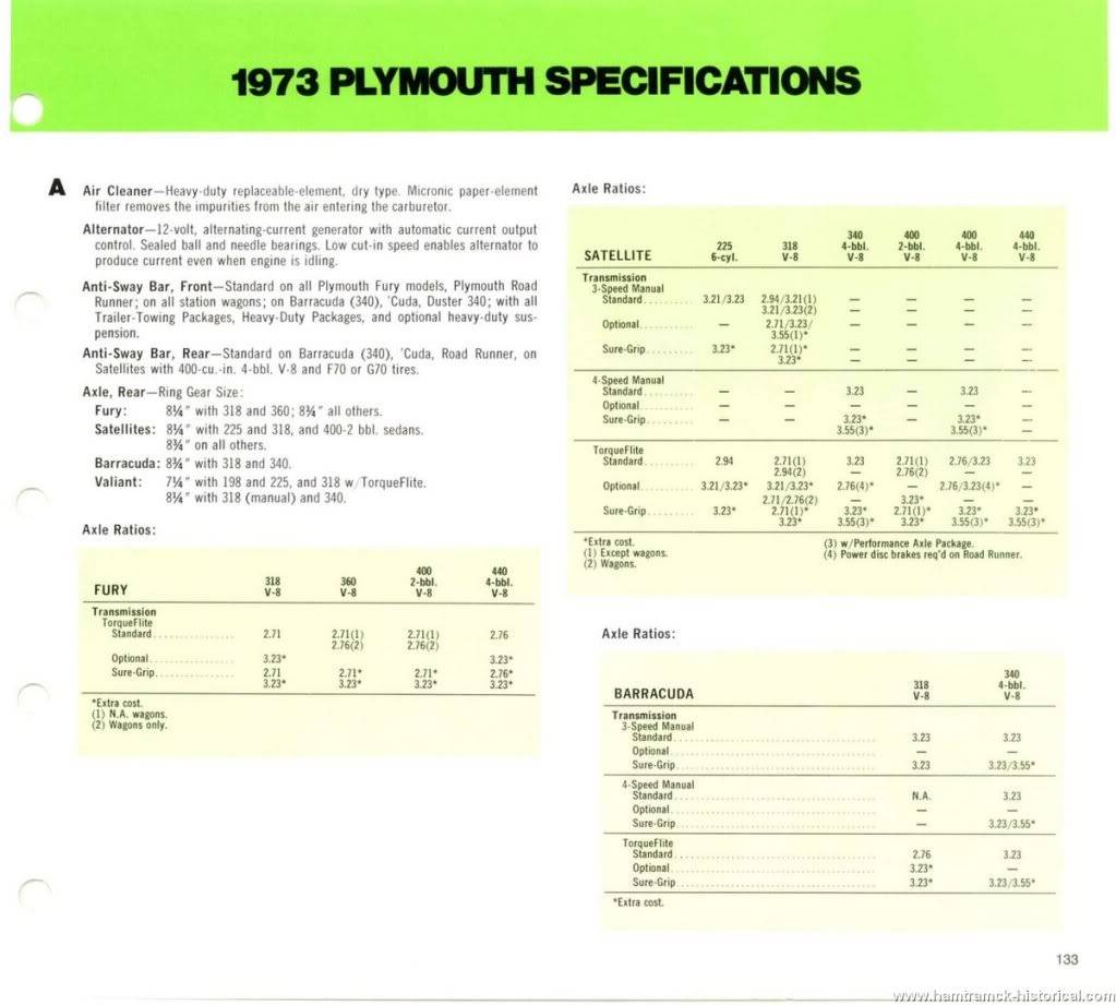

I have a '73 Cuda w/ a340 as OE equipment, I have a sway bar.
Mar 11, 2011
17
Left side of page under anti-sway bar.front.
