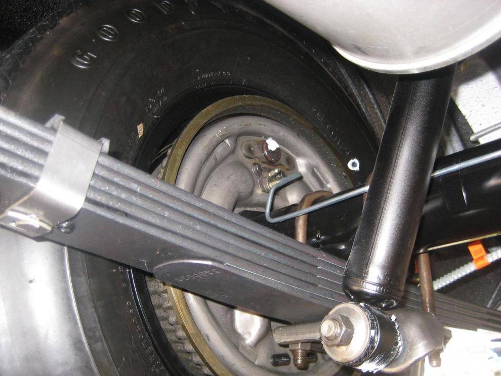

Not sure that is entirely correct, i am pretty sure only the Hemi and 6Pack got unequal springs, with the 7 being on the RHS. Maybe 383,440 got the 6 leaves as mandatory but the LA engine models and Slant 6 in the 70-71 had only 4 leaves. I have two Challengers, a 71 318 Slapstik H code and a 73 Rallye 340 4 speed and both only have 4 leaves -and this includes the half leaf at the bottom. My 340 Rallye has the rear anti sway bar. I'm sure the Tow packs and HD rear suspension package had more springs though. Here is a picture of a Hemi Refernece resto, the leaves on the LHS
