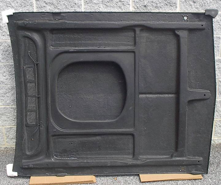

Underside shot of an original hood.

floyd
Mar 18, 2012
319
187

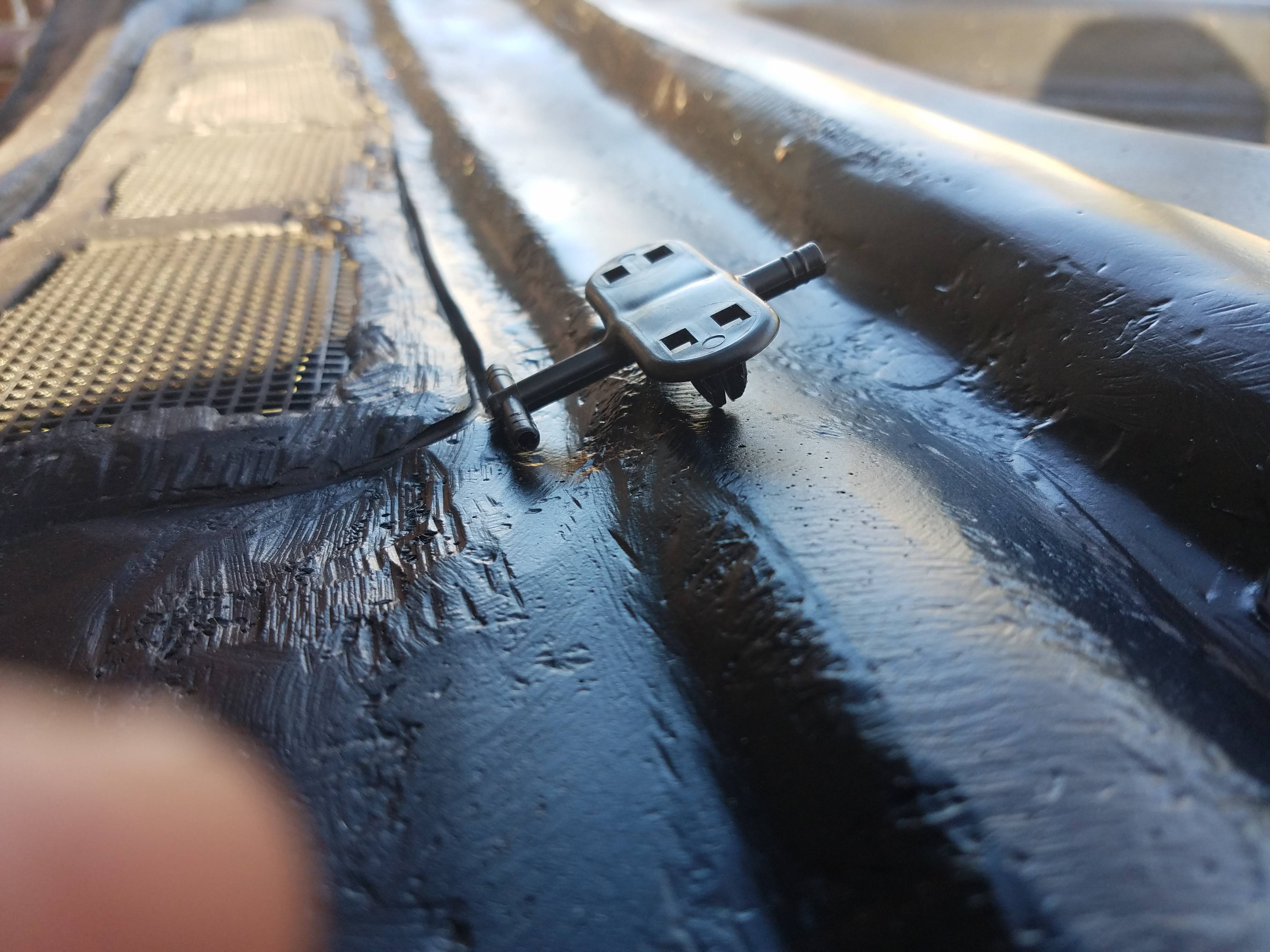

Close up (different original) of the location for the two small plastic straps that hold the hose. One strap broken off in this pic.
floyd
Mar 18, 2012
319
187
Yes, I would assume that raised section of underside against which the t-fitting and plastic loops are attached is hollow. There appears to be about a half inch of space between the inner and outer layer of fiberglass on the original. You’ll need to careful when drilling, but there should be enough depth for the fasteners to catch.
