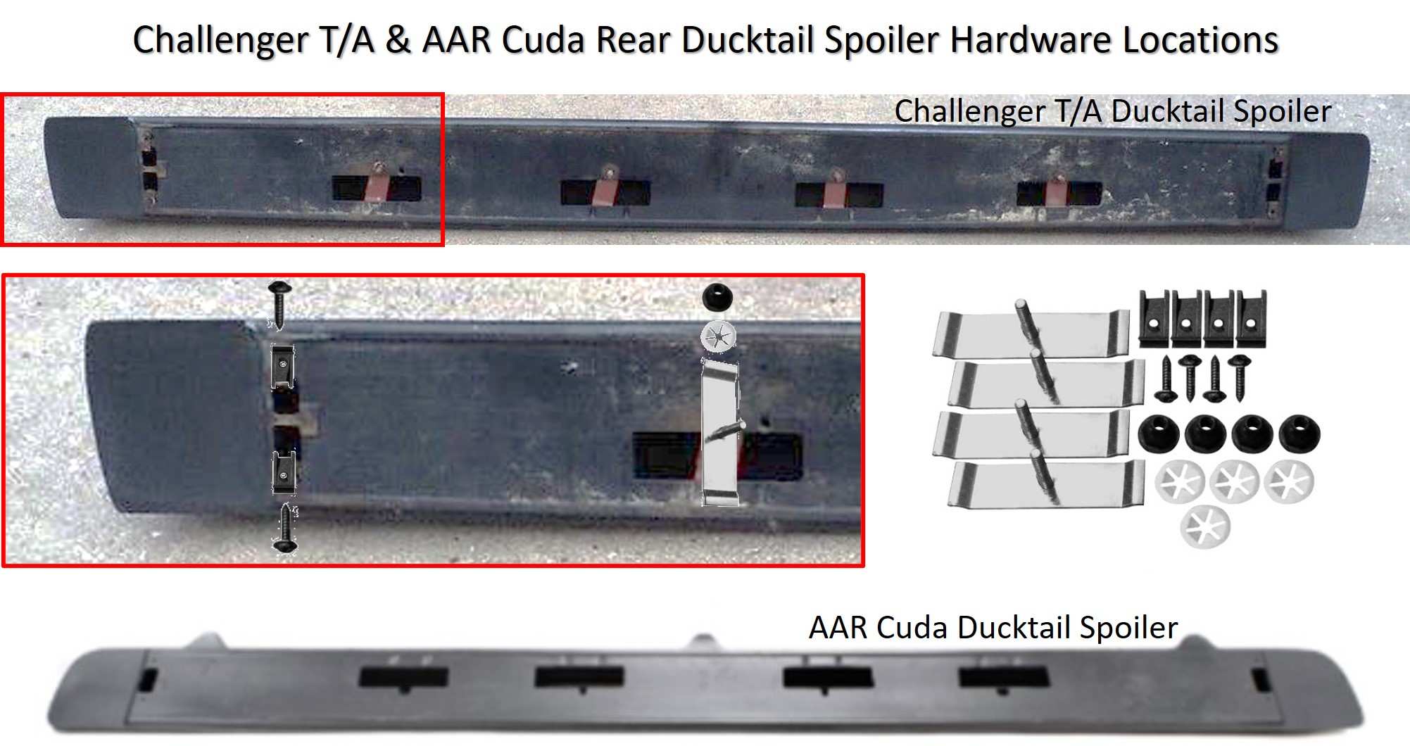

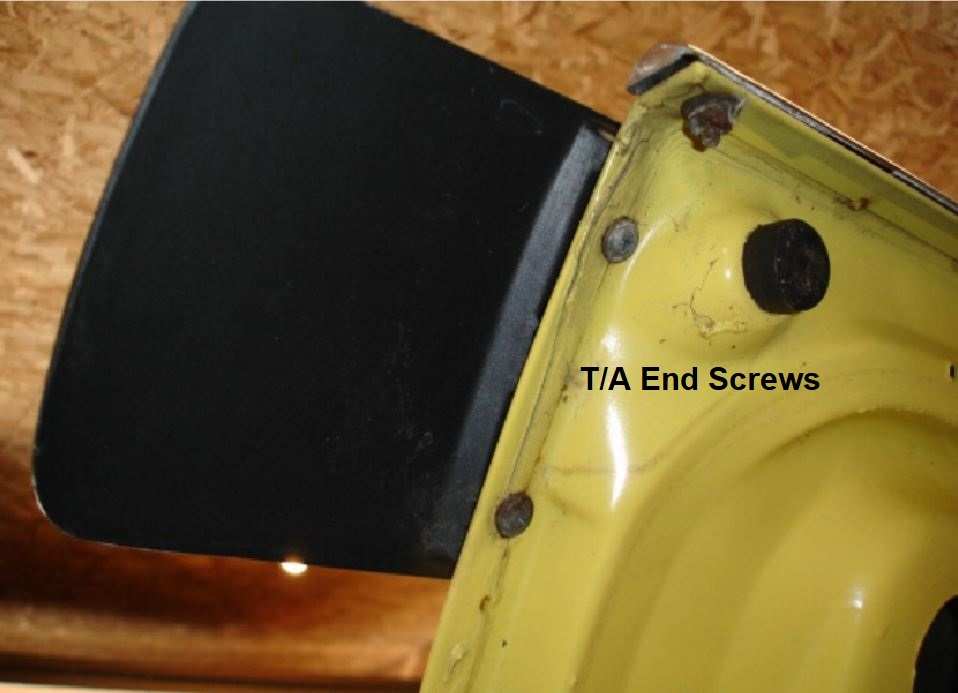

Kenny,
Here are some pics of the screws. The head as an integral washer.
