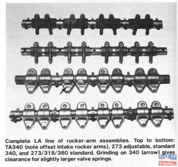

No, regular 340 rockers are not adjustable and are completely different. You’ll need to find a correct 340-6 replacement.

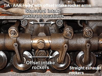

Here’s a good reference pic

Fact 51: The 340 Six-Pack stands as the only Chrysler engine produced with adjustable rocker arms and a hydraulic camshaft. These features rarely converge, but in the case of the 1970 340 Six-Pack, the relocated intake pushrods prevented the use of existing 340 stamped-steel rocker arms because the balls and cups were no longer aligned.
While it probably would have been cheaper to whip up some specific stamped-steel offset rocker arms to solve the problem, Chrysler invested in high-strength, cast-steel rocker arms incorporating the proper offset to do the job. Doing it this way spared racers the expense of trying to find suitable aftermarket rocker arms when swapping a solid racing cam in place of the stock hydraulic unit.

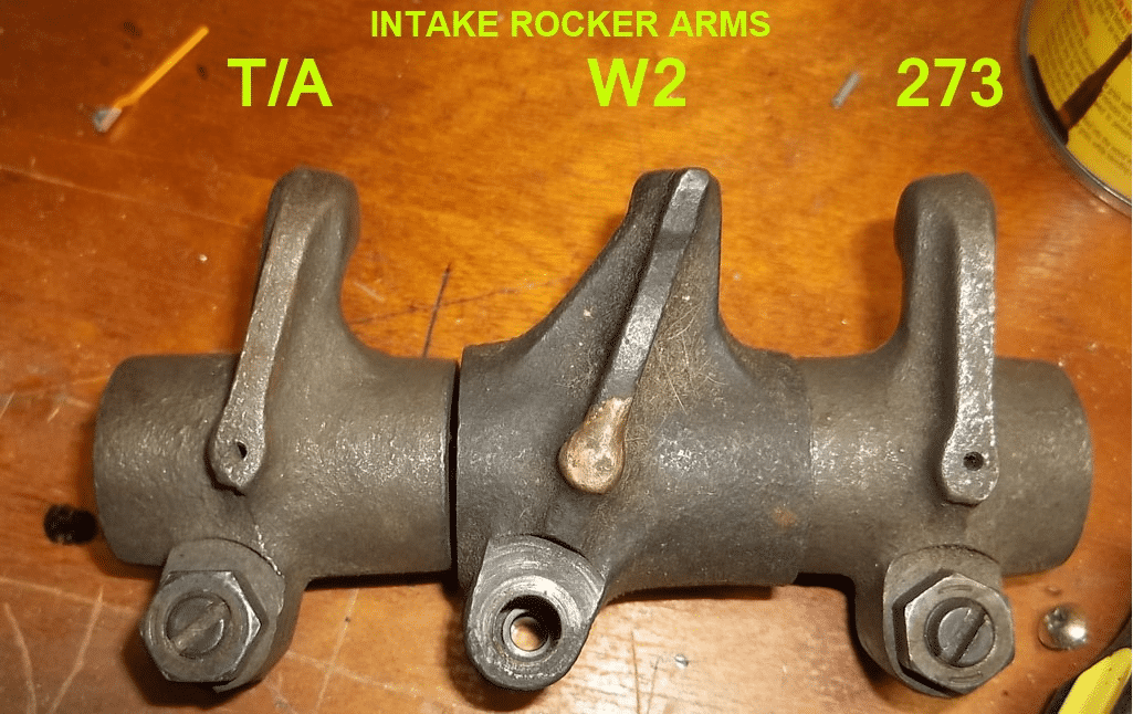

The bottom line answer to the OP's question is, yes, you can use any of the straight, cast-iron mechanical rocker arms. All LA engines used straight rocker arms (not offset) for the exhaust valves, even the T/A's exhaust rocker arm is straight but it is cast-iron and adjustable.
The 273's straight, mechanical rocker arm will work but is not a heavy-duty piece so it should not be your first choice to replace your missing exhaust rocker arm. Crane and Isky used to make aftermarket versions that duplicated the factory look but were stronger than the factory 273 pieces. You may be able to find one of these aftermarket, cast-iron adjustable straight rocker arms to replace your T/A exhaust rocker arm. Your best choice is to find one of the pricey and rare T/A or W2 cast-iron, adjustable exhaust rocker arms.
Note: Both 273 intake and exhaust rocker arms are straight with no offset. T/A intake rocker arms are uniquely offset and W2 intake rocker arms are uniquely offset and these intake rocker arms are not interchangeable.
Look at the straight rocker arms on the far-right of each of these pictures and tell me if you can see a difference. The T/A straight rocker arm is stronger than the 273 but look almost exactly the same.
