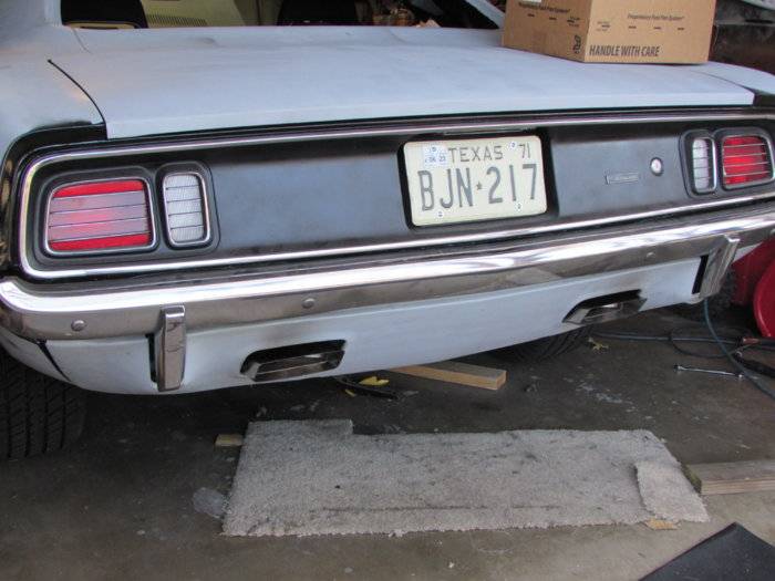

I installed Cuda tail panel trim on my BHG last summer. Looks great!

After restoring the body...I left mine off my 70 ragtop. I deleted some chrome from the car. I like the black-to-color look.

I thought about that also, mine is the original tail panel and has holes for the clips. It was really an after thought, but I do like the trim on it, gives it a nice contrast between the black and purple. Thanks for the input......

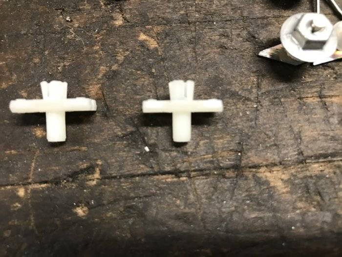

We unpacked the new trim and fastener kit. First thing we noticed the plastic keepers have a stud too long to allow the trim to slide over it. Is it a cut to fit situation? Or am I missing something?

I believe the one end (not the splayed end) breaks off. That cylinder is used to insert into the splayed end to force it apart and keep the clip in the hole. I didn't use them, I found some roofing nails and cut them down to size and pushed them into the splayed end instead. I found the little plastic cylinders really hard to work with.
I have used those plastic clips before for installing trim. Take the cylinder out, push the splayed side into the panel, then push the cylinder in until it is flush with the flat piece of plastic.

Perfect, thanks guys. I knew there was a trick to it, we’ll give it a try this evening. I’ll post a photo when successful with the install.
