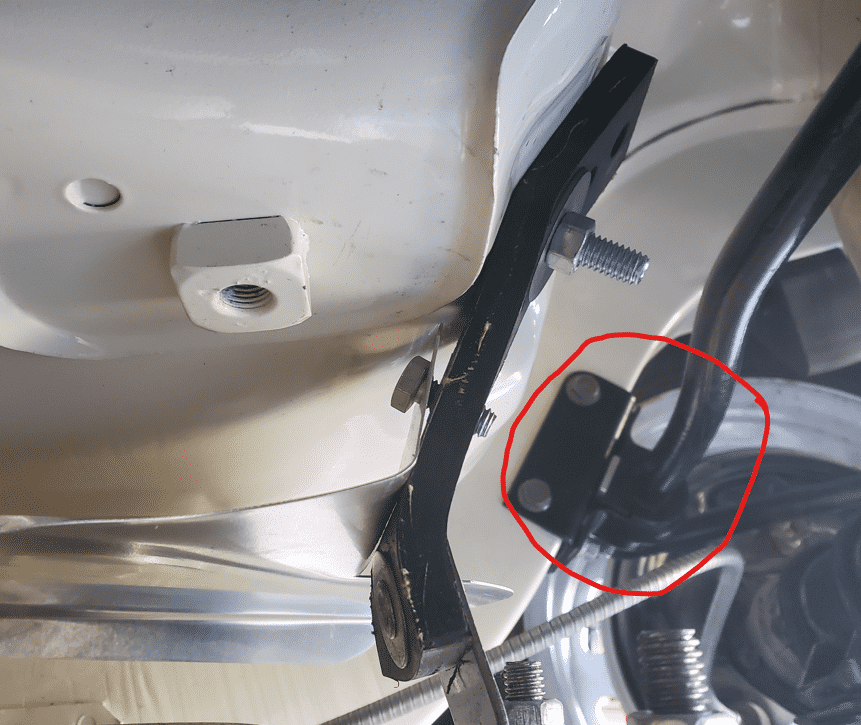

I had one of my rear sway bar bushings walk out of it's bracket. That created a knocking noise that was a little hard to diagnose, just because it was not easily visible. This might explain the noise but probably not the ride quality problem. I would agree with "air shocks" diagnosis also. I did a full rotisserie restoration on my 73 and the holes for the upper shock connection were elongated and had to be reworked.
