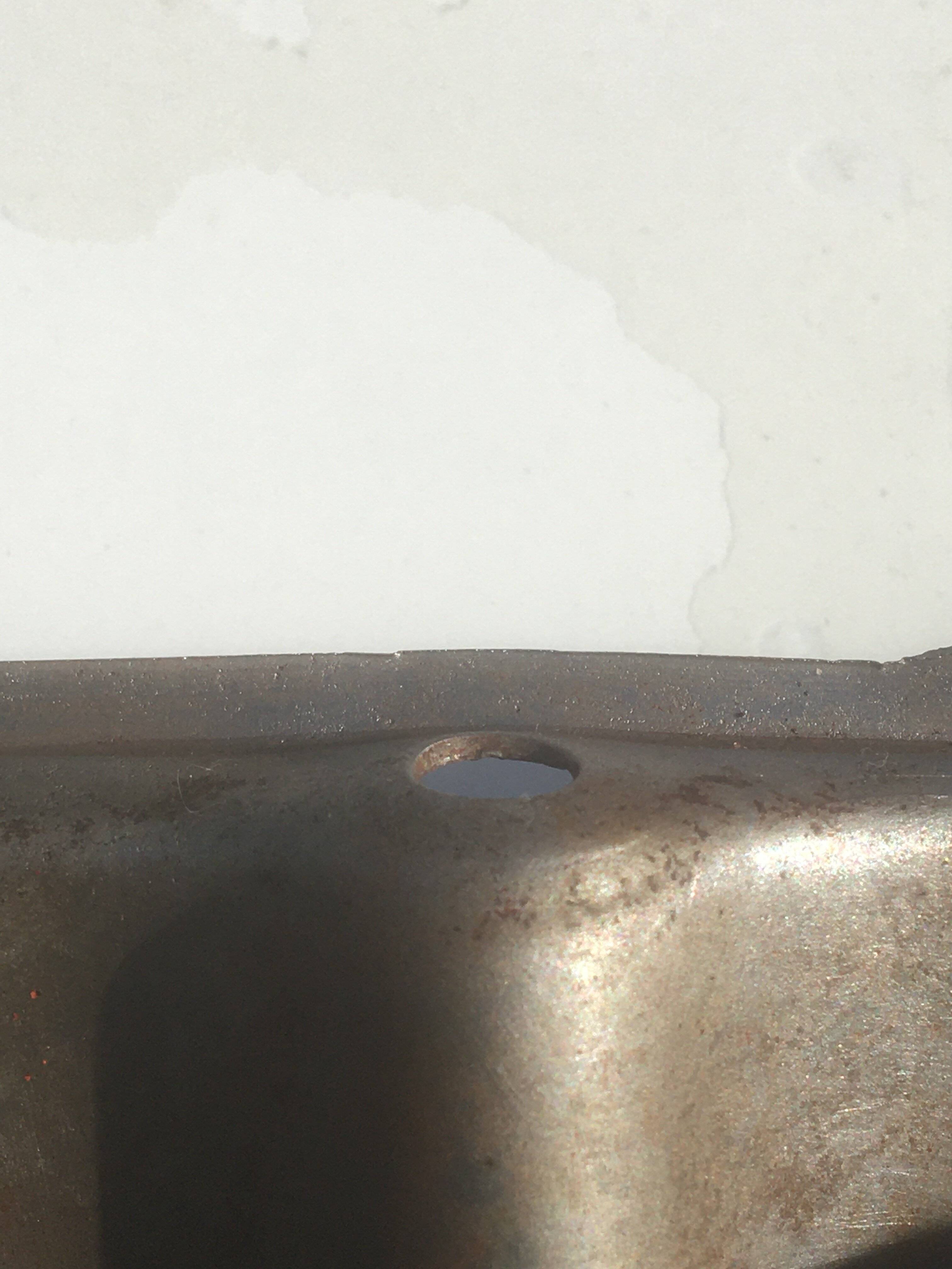

Presuming these are the stamped steel oem-style valve covers, I can offer some insight from my own experience on a 440 big block.
Mine were bent. When the bolts are over tightened, it stretches the bolt opening in the valve cover in a way that keeps it from making a good seal. These become mounded, or dimpled, by the force of the bolt.
Inspect the "flatness" of the inner edge of the valve cover that mates with the gasket. Throw a 12-inch straight edge across there to confirm its pretty darn flat between one bolt hole and the next.
In my case, the bolt holes were dimpled, and would bottom out the gasket before the straight edge (between the bolt holes) could press the gasket enough to make a good seal. The straight parts were still straight and pretty flat, except for the mounds around the bolt holes.
I used a block of wood, a hammer and appropriate tool to tap the valve cover metal (the dimple around the bolt hole) back flat again. When installing them again, I took care to not over tighten on fresh gaskets and they have held up for 8+ years without a leak.
The photo depicts a bent or dimpled valve cover bolt hole that can hinder the cover's ability to squeeze the gasket against the head.

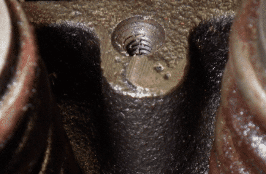

Not only check / flatten the valve cover, you might also check the head with a straight edge.
This SB head has a raised area that didn't get reworked properly (ground/filed flat) from the factory.........
