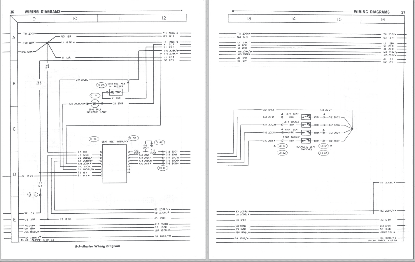

Yesterday at 11:11 AM #1 J Jerry Foust Member Joined Mar 25, 2019 Messages 15 Reaction score 4 Location 449 Ross Cemetery rd. Lake City Tennessee, 37769 I have a 1974 Challenger can anyone tell me how to by-pass the seatbelt interlock ? I have installed a new factory style wiring harness .
Yesterday at 4:03 PM #2 pschlosser Well-Known Member Joined Dec 8, 2022 Messages 751 Reaction score 293 Location Santa Rosa, California Ground. You want to ground front left and right buckle switches to ground. The light green and red wires. Last edited: Yesterday at 6:54 PM
Yesterday at 4:40 PM #3 J Jerry Foust Member Joined Mar 25, 2019 Messages 15 Reaction score 4 Location 449 Ross Cemetery rd. Lake City Tennessee, 37769 Okay Pschlosser thanks
