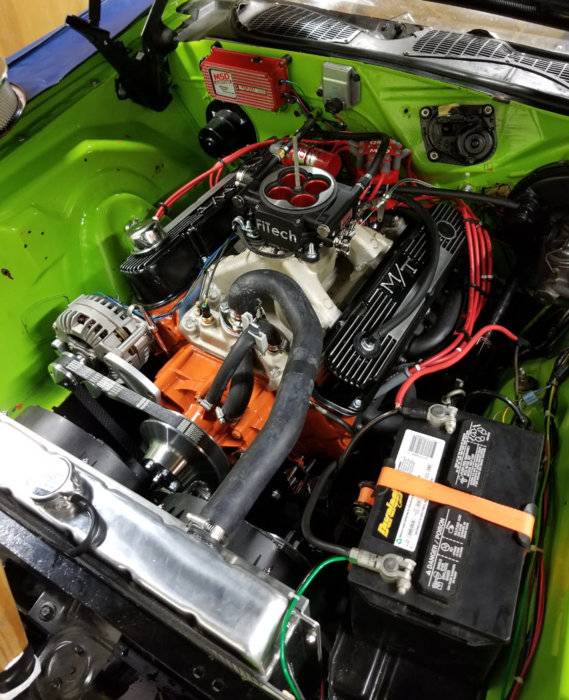

Hey everyone, I am somehow new to muscle cars and Mopars but I have to say it has been fun. I am in my early 30's and used to work on VW's and Diesels but since I got a 70 Challenger about 9 month ago I will not go back :) The car is a Georgia car (I live close to Atlanta) and it was an original 318 car that was converter to ta TA in the early 90, one owner since the early 80, never welded. When i got it the 340 had a spun bearing and i decided to go to a 4inch crank and all the other good stuff including Fitech Power adder. Past Monday after 9 month of engine building I started her up the first time, ran great after some initial timing issue and passed the 30 minute cam break in. I let it cool and started it again a few hours later only for a few minutes. Tomorrow will be our first test drive. When i checked the coolant yesterday i notices some brown floating crumbles that are somewhat liquid but did not seem like oil. Also there were not many and soaked them out of the top of the radiator and filled it back up. I hope it is not oil coming from somewhere in the coolant, probably is nothing but i am very picky with stuff. Has anyone experienced this after a engine rebuild, can this come from lube oil used, block washing (i had it magnafluxed), or anything else? I do not have water in the oil, i drained and inspected the oil already and it all looked fine. Anyway, nice to be part of this community, during my build i read a lot of posts on certain topics. Was a great help to me. Thank you all for that.

I noticed you used an after market aluminum radiator
Could there have been oil or fluid residue left over inside the radiator when it was welded together?
Just a thought.

I would do a pressure check of your cooling system to rule out any internal leaks.

Some times the block cleaning acid is not as strong as it could be & leaves some scale & sludge behind it looks like a Becool radiator they are great i have 1 you could put an inline filter & check it daily once the scale has cleaned up remove the filter as it can lead to engine overheating if left unchecked
I fill my blocks with Hydrochloric acid before having the engine machined but it is dangerous & a messy operation not for everyone but it does comes out clean as new.

It is actually a dual plane plane which can get you trouble along with the Fitech, so far I love It, no complaints. But I have not pushed the motor to see what it does in higher rpm, super start, idle and all. Like all the tuning possibilities along with it, timing, fan temp, idle...I drove for 45 minutes today and it does not seem like I have more sludge floating in radiator but there is some, I will monitor it. Check compression and all. Only think I can imagine where it is coming from is leaking head gasket, my oil is clear so it cannot be motor oil. Either left over from poor cleaning of block or compression leaking in cylinder but I can check on that.

Yes only the mesh type for solids you would not want to filter the coolant it would create to much restriction causing over heating what is the sludge is it oil based ?
I would drop the coolant & flush a couple of times too see if it clears up.
Its good there is no coolant in the oil.
What coolant are you using.
Try running some of your contaminated coolant through a household paper towel see what is left when the liquid runs through.

Yes the sludge seems oil based, looks solid in the coolant but oily when out. I will flush it first then see what it does. I want to use some kind of flushto break down thisoil and get it all out, any recommendations? I am using regular green mixed with distilled water and water wetter

Hey austa, to let you know what happened, I talked to my machine shop who did the block and heads and he insisted for me to flush coolant before I remove heads and that did it, used purple flush and everything is gone, after almost 100 miles nothing came back. Also pressurized cooler to13psi no leaks. Just need to upgrade motor mounts and I am almost finished.
