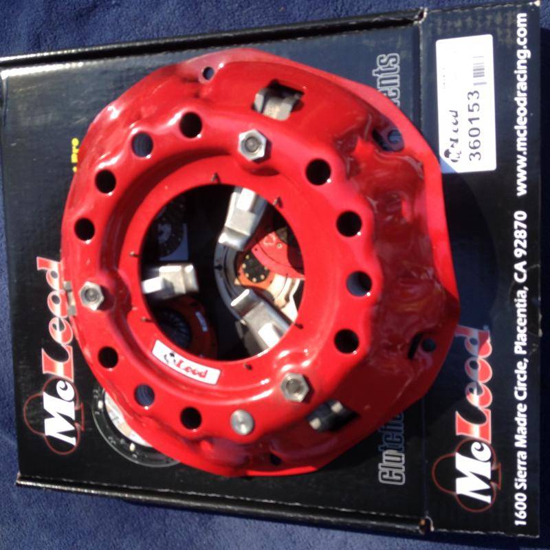

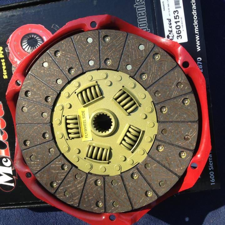

Now for the point of all this B.S…… after all these years it gets hard to remember the right parts needed to keep the old Cuda running right. So when I needed a new clutch about 2 years ago I went to the new fangled internet to search. I started to see stuff about different size bell housings, 10.95 inch, 10.5 inch clutches and was a little confused because I remembered burning up 11 inch clutch discs on my first Cuda and I knew that was original equipment. So I opted for the 10.5 to make sure it fit. I really wasn’t happy with the new disc it looked flimsy and had 8 light weight springs instead of the 5 heavy springs the old larger discs had. That clutch lasted for 2 years. But, since I rarely drive the car that was less than 300 miles….I do like to get on it when I do drive it. So this spring I decided to pull that clutch out and began another internet search. There seemed to be a lot of confusion about a 10.95 inch and 11 inch disc with use on the 10.95 inch scalloped pressure plate. So I decided to use my old worn out memory as a guide and ended up with these results:

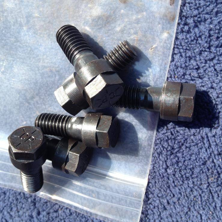

For a pressure plate I choose the McLeod Scalloped 10.95 inch part # 360153. (Includes special mounting bolts). For the disc I choose the 11 inch Hays part #40-220. Now I was a little worried about the 11 inch size being too big… but I did like the fact that it had the 5 heavy springs as my original clutch disc. Visually it appeared to fit right, but I still took the set up to a friend of mine that runs a machine shop. He raced quite a few hemi cars back in the day and still works on some. He agreed that the .05 inch difference was not a problem. So I’m here to tell you that this particular set up worked perfectly. My car does have the original big over the clutch pedal spring. The pedal effort was just like original and the clutch really hooks up great. Also remember that my car is original and has the 130 tooth flywheel and aluminum bell housing. Hope this helps someone with the never ending clutch size debate.
