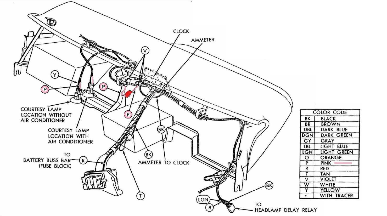

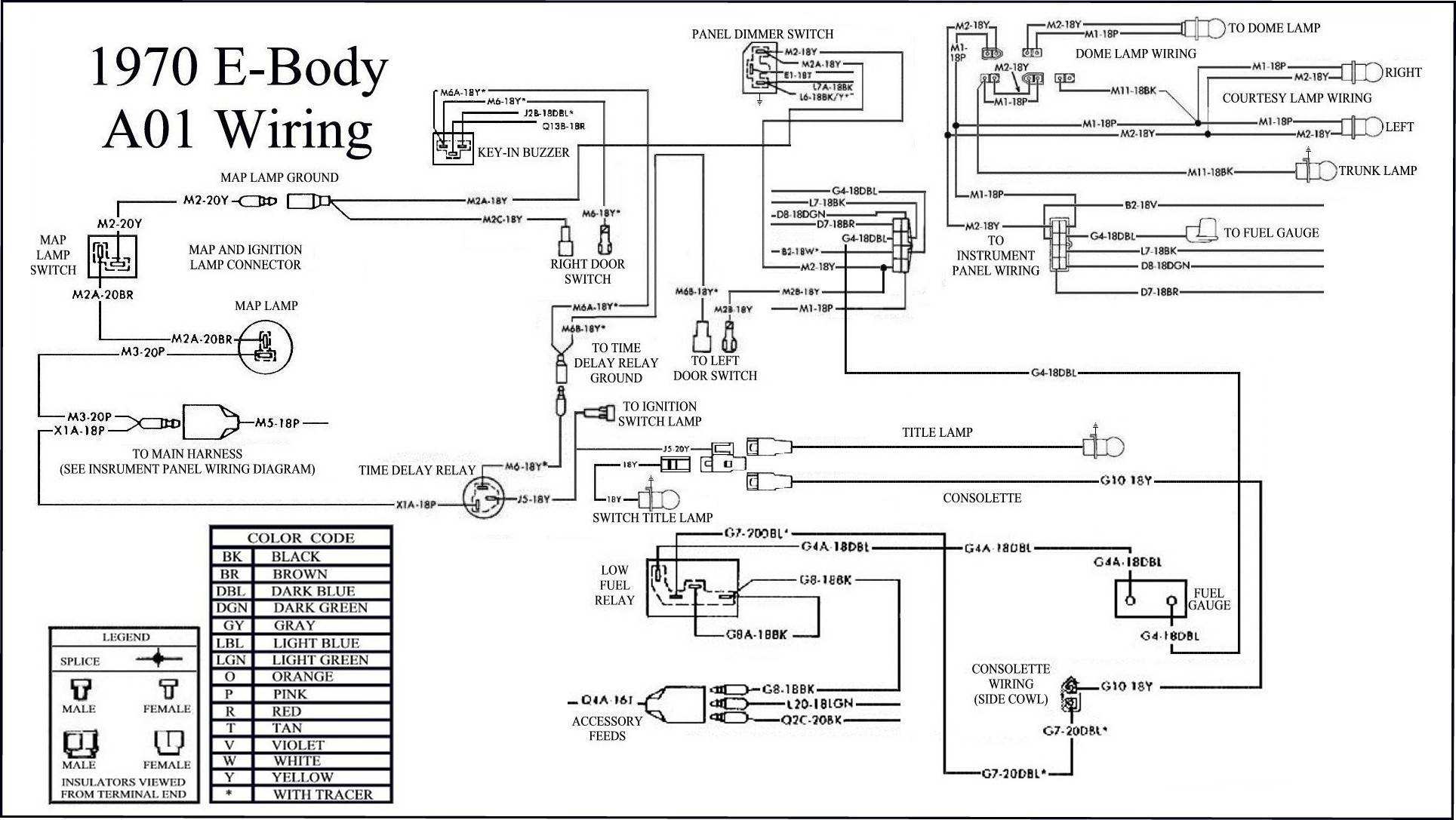

The time delay feature is part of the door switch circuitry and is a convenience add-on. Basically, a couple of the interior lights stay on for like 30 seconds after the door closes - dome light, map light, "title" light (far left cluster light bar), heat/ac switch light and I believe one other thing that I can't remember at the moment.
Oddly, (per the fender tag) my car did not come with the A01 light package though it does seem to have all of the options on it - time delay, map light, title light, ignition light, fender mount turn signals, trunk light. Not sure if the key buzzer and seat belt warning light are part of the A01 package but it has those too.

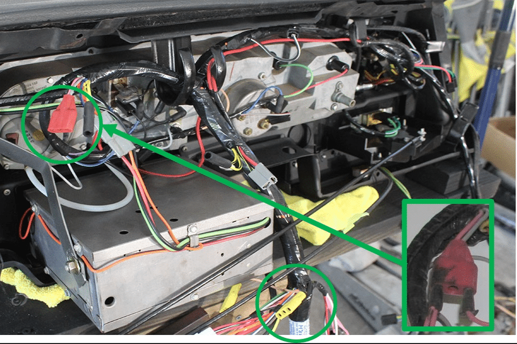

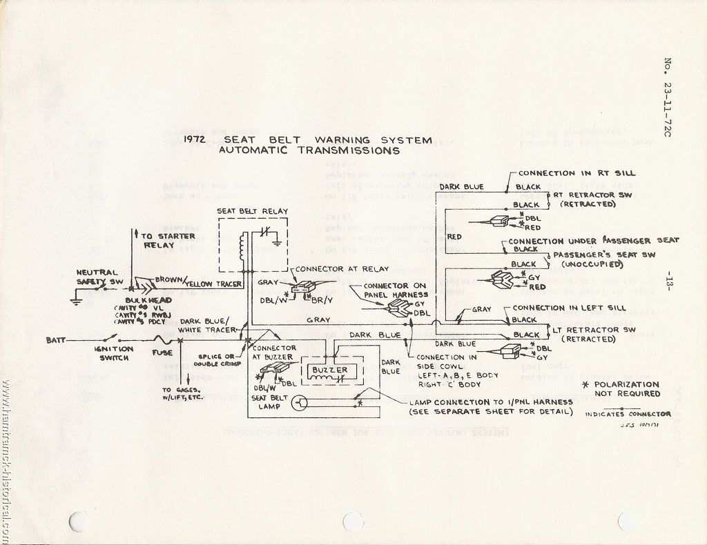

My 73 has a glove box light and a trunk light but I don't think it has many of the other optional dash lights. I think by then they could be purchased individually. Key buzzer I believe is standard from 70-74, pretty sure that can be disabled by just unplugging the two smaller red wires in the ignition switch flat plug at the steering column. I just rebuilt a 70 steering column and had to transfer the key in buzzer switch from the old ignition switch to the new one, it's not included. Seat belt warning I think is also standard by 72, not sure if that's part of the main dash harness or tied to the seat belts in a sub-harness. Shouldn't be tough to trace. A 72 service manual would be worth the investment. The other lights are optional so they should just plug in as a sub-harness or sub-harnesses to the main dash wiring. Could probably transfer them, IIRC they plug in to one of the accessory power feed plugs to the main dash. My 70 has a/c and cruise control as well as the SE overhead console, and all of that stuff is on separate sub-harnesses that plug into the main dash wiring.

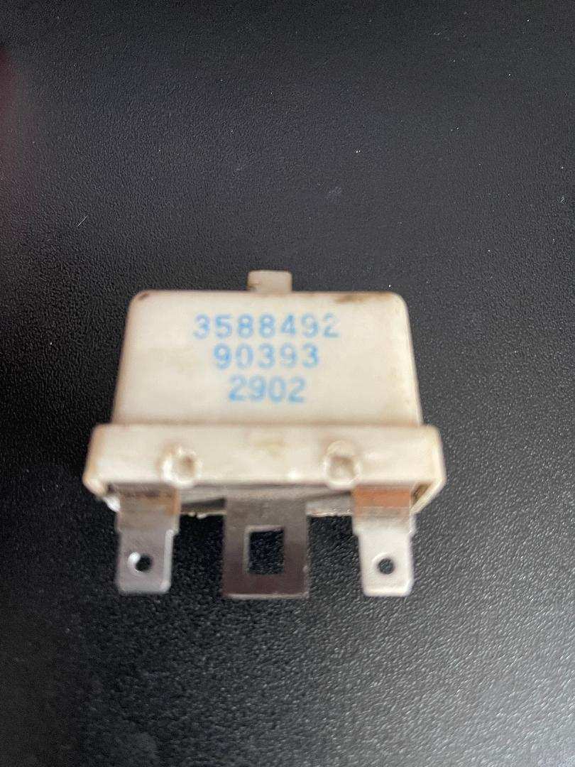

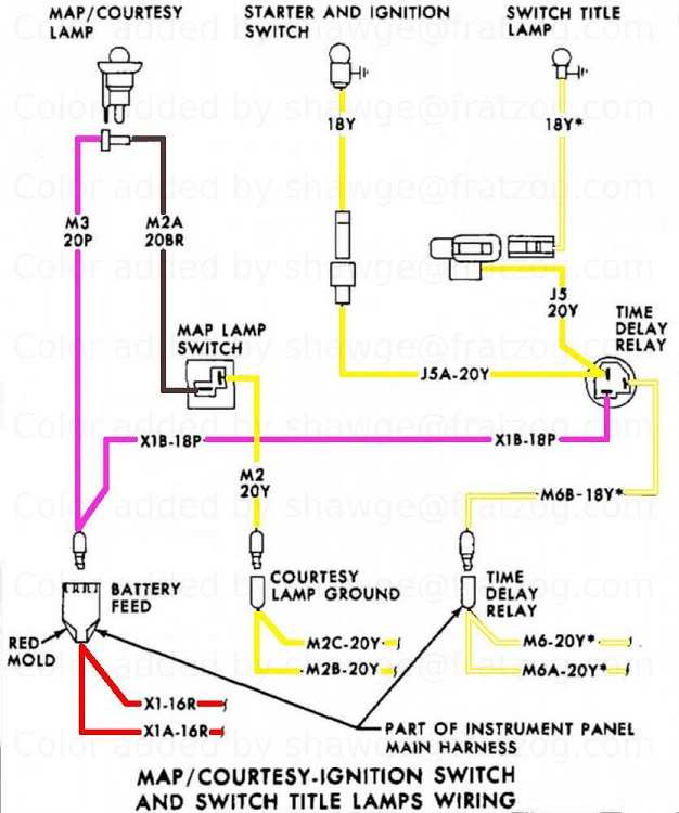

On an E-body, the time delay relay turns on the mentioned headlight switch title lamp and the ignition switch light only. Nothing to do with interior or map lighting. While triggered by the door switch circuit, its not part of it and can be removed, or in this case omitted, without effecting any other functions.
