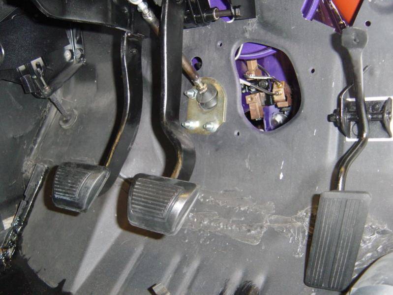

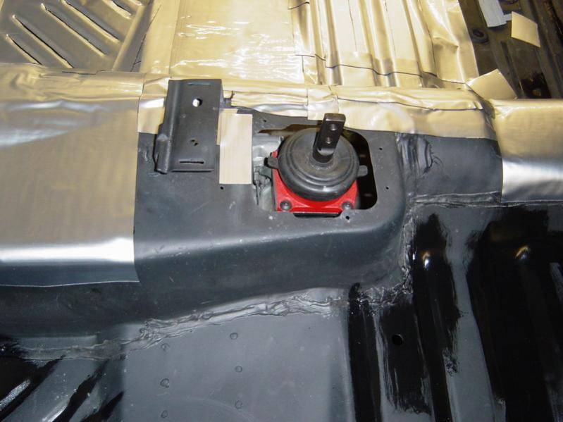

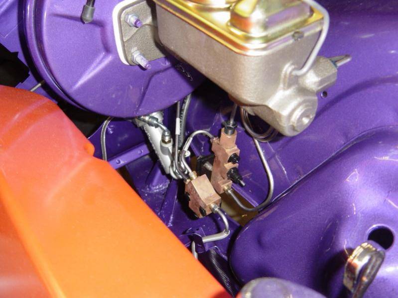

I put a TKO 600 in my 71 Challenger, with a hydraulic clutch throw out, and TTI exhaust, no big problems with those, I did have a slight clearance problem where the right side of the trans touched the trans tunnel, but I was able to easily push the tunnel out with a pry bar, no cutting needed. My shifter came up right in the center of the factory hole, like it was supposed to. ( Hyd clutch rod.jpgClutch master.jpgShifter.jpgTrans made for Mopar swap)

Relax426
Jan 3, 2015
37
I would keep an eye on that clutch cylinder at that angle. I had one on my road runner and it will wear one side of the cylinder and leak.
