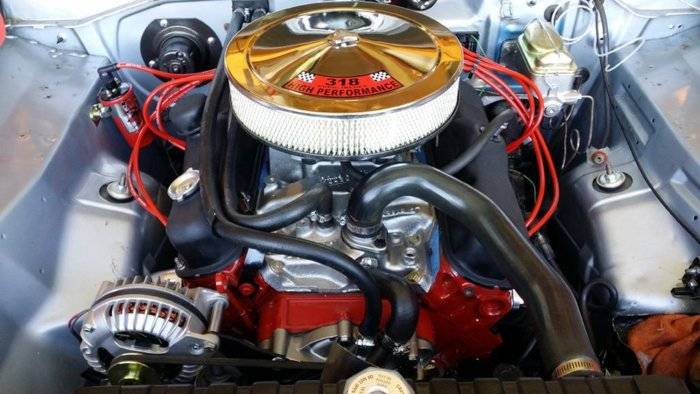

I decided to go with a small block for a lot of the reasons you said. Here is my 408 in my 71 Barracuda. I have not driven it yet, so I can't speak to the power output, although I am hopeful that it will have good power.

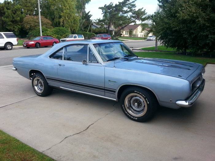

I have been very pleased with my 408 crate engine. The combination including my original refreshened 904 with a tru-trac 3.73 rear has made it a beast of a street car. These are fun things to decide on!

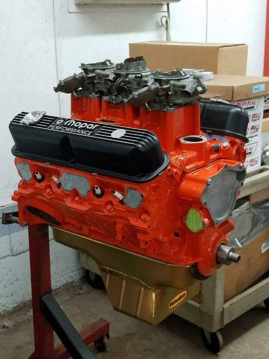

I say go big block mild stroker 470 b block to 512 rb block is the way to go cost factor isn't much different building a a motor or b motor and b motor will make more HP & torque for less then a small block + you all ready have the trans. to me its a no brainer. heck I'm putting a strocker 528 rb motor in my 69 Plymouth valiant. ;)

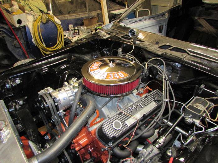

I'm going to stroke my 318 to 392
