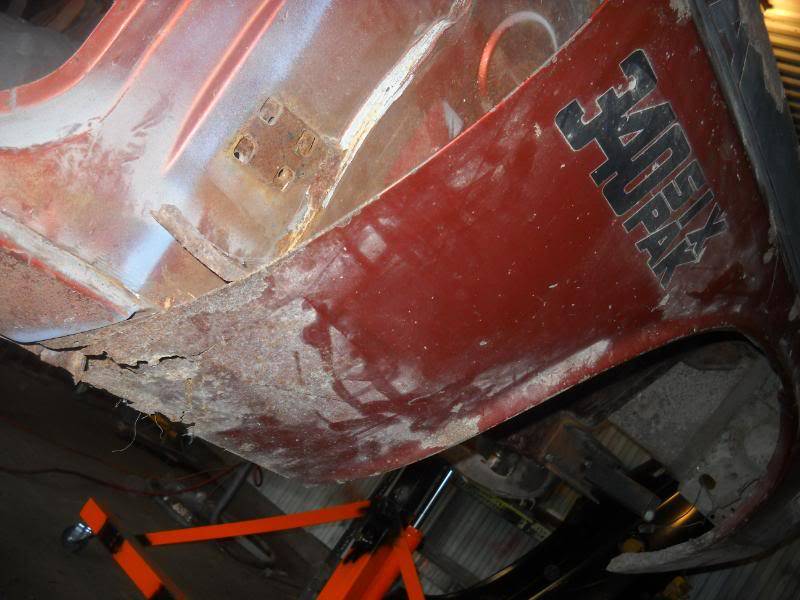

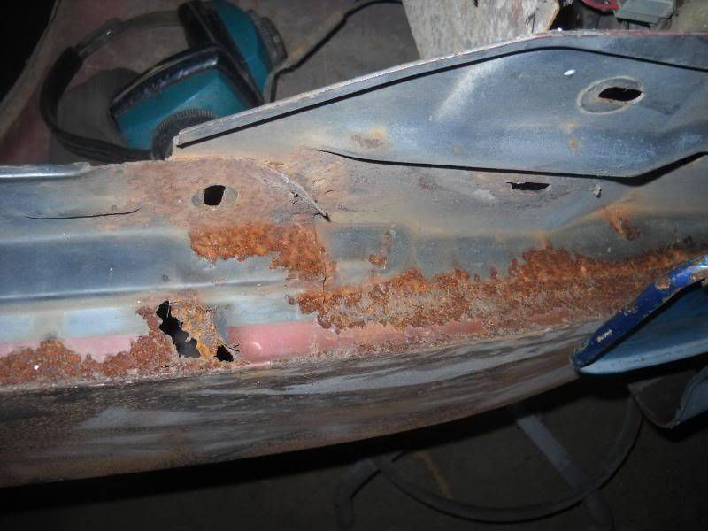

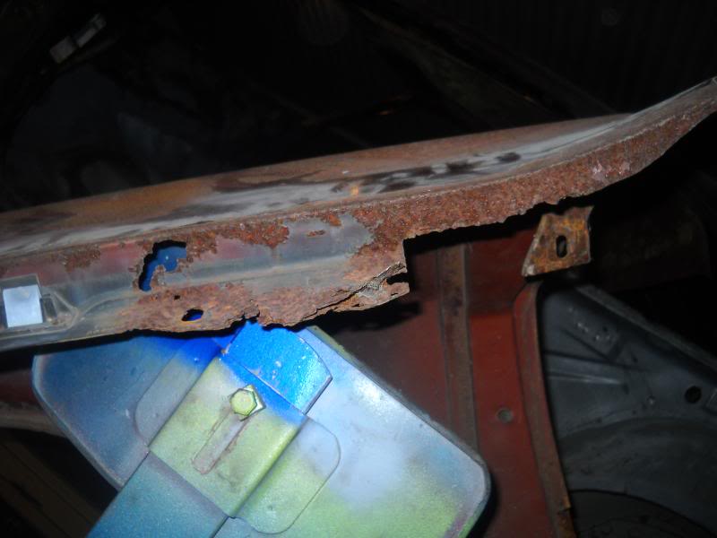

The pass fender on my T/A is very rusty. The bottom behind the wheel is rusted out, the headlight bucket I think is rusted out, and the fender is heavily pitted. (car sat in a long island boatyard by the ocean) I was able to save the drivers fender, but decided that I didnt want to go through the effort to save the pass. I have a rust free pass fender that is dammaged that would yield all the patches, but it would be ALOT of work.

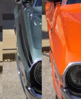

I just learned that there is a difference, and T/A fenders actaully have the whole side bulged out over the tire in order to clear the bigger tires. It really cant be noticed unless you see them side by side with a regular chally fender. I ordered an AMD new pass fender about a month ago, they arent even completed yet, so i am supposed to get it in march. I dont know if I want it now!

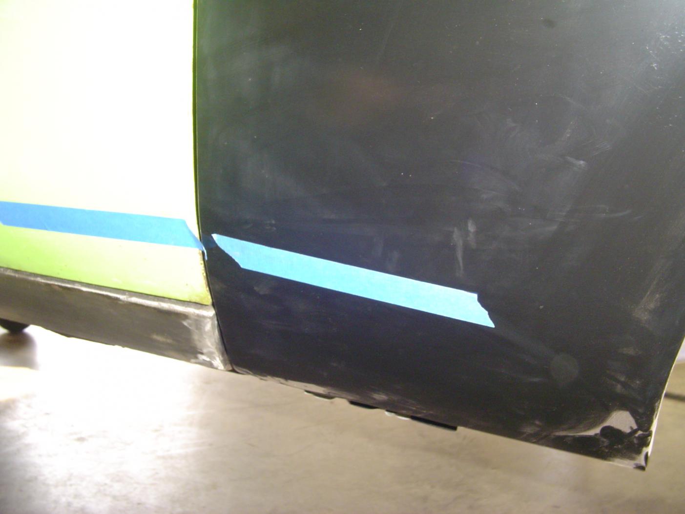

OK, I decided to tell AMD to go stick it because they were giving me the runaround on my new fender. I have already started the metal work on the T/A fender, man is it alot of work. I have all the inner structure cut out of it so it is a bare skin right now. Metal work is about done. Don't know if I should have saved this one but it will be nice when Im done.

well its not finished, but pretty far along. This is before any metal work. I have yet to take pics of progress:
