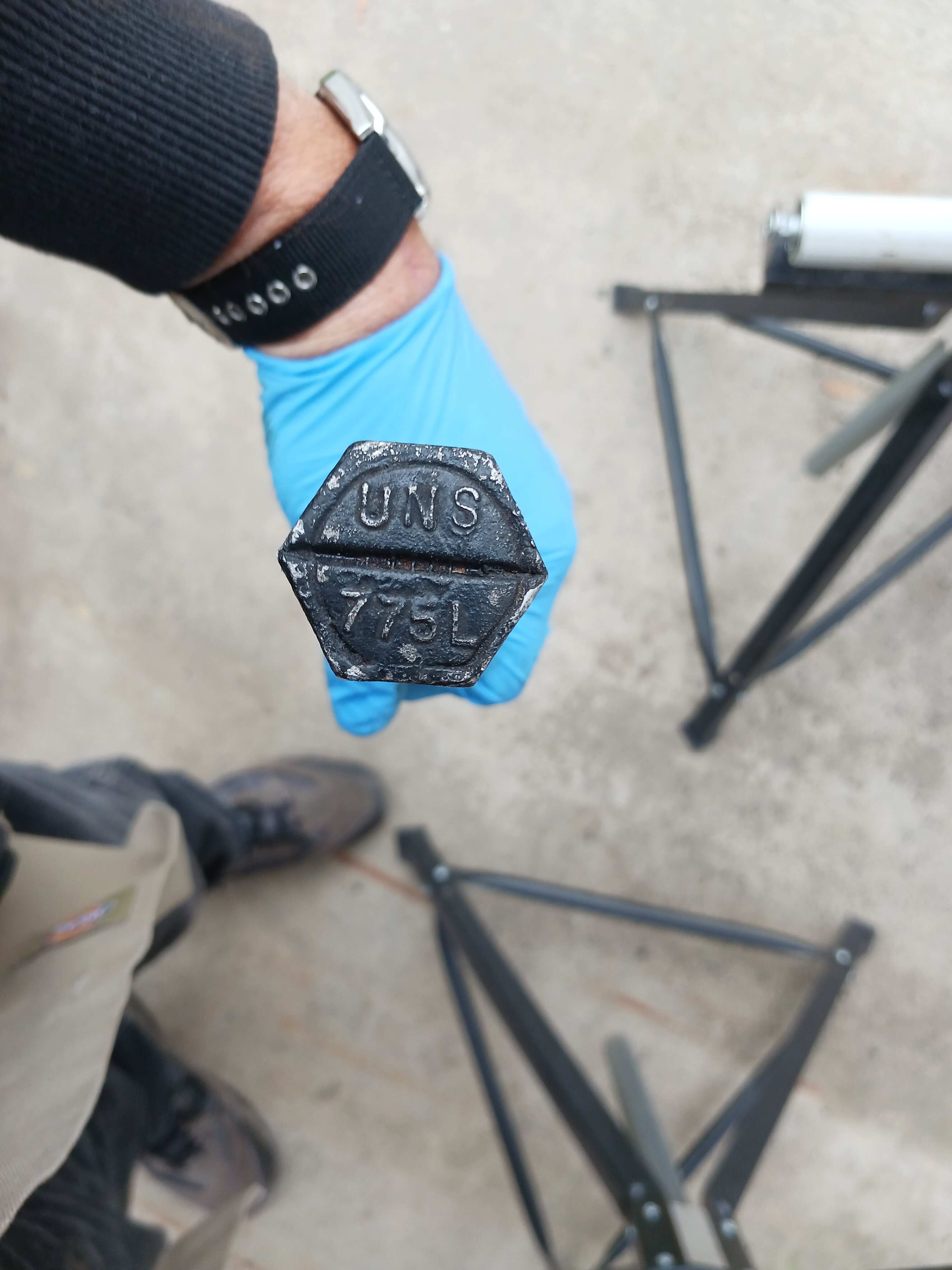

I always reinstall the numbers to the back. Now I think about it are the numbers on both ends?

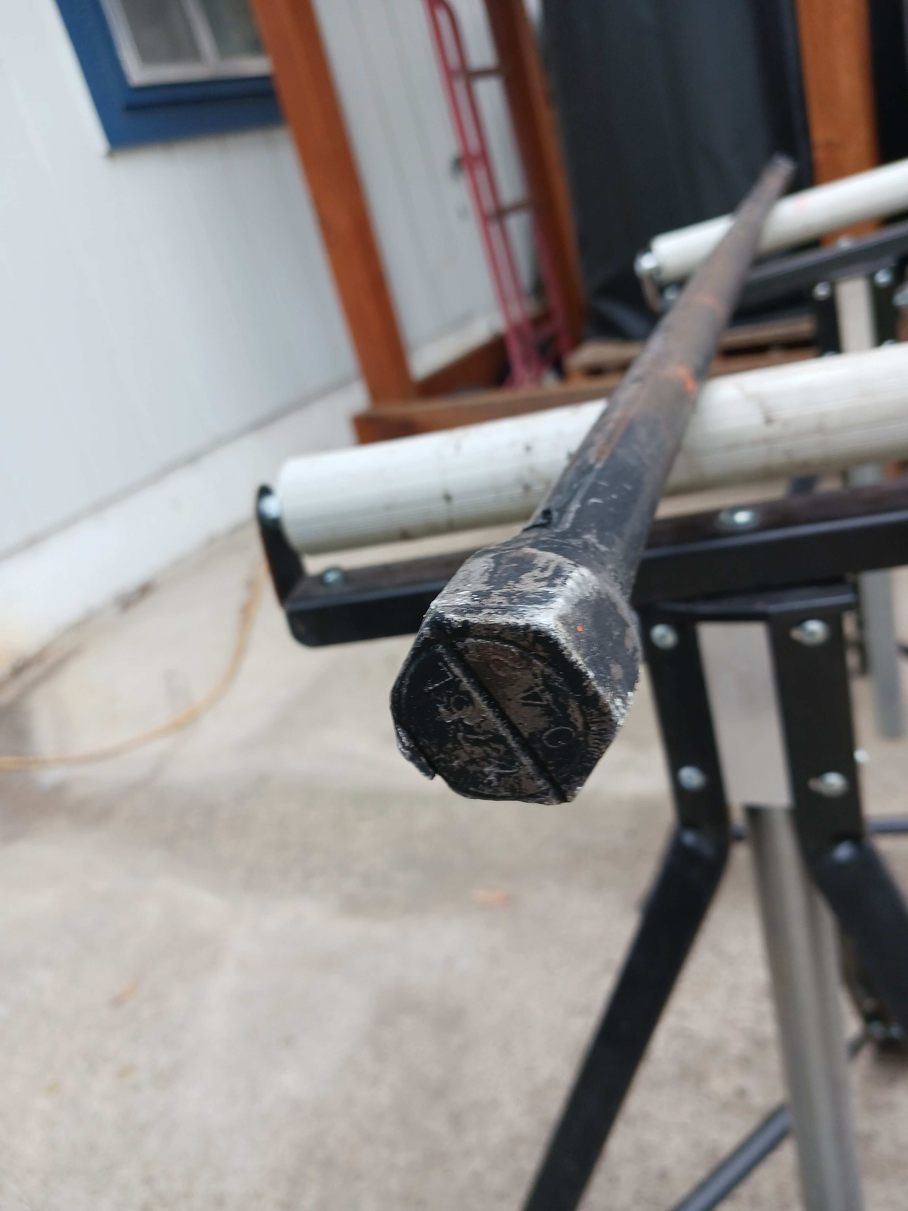

The markings on each end in photos. Driver side (L). You can also see two orange paint marks in bottom photo on bar.

It looks the factory protective coating is mostly gone off that one bar. I would treat it with a rust converter, like Ospho, and then spray it with an non-paintable (stays flexible) undercoating. If you eventually upgrade to new T-bars they will probably come without any coating on them. You don’t want rusty T-bars.

I plan on putting a coating on it after a new dust boot is installed and the bar is in the car. Too hard to get the boot on with a rough undercoating on it. The cars don't rust much in the dry eastern Washington climate.
